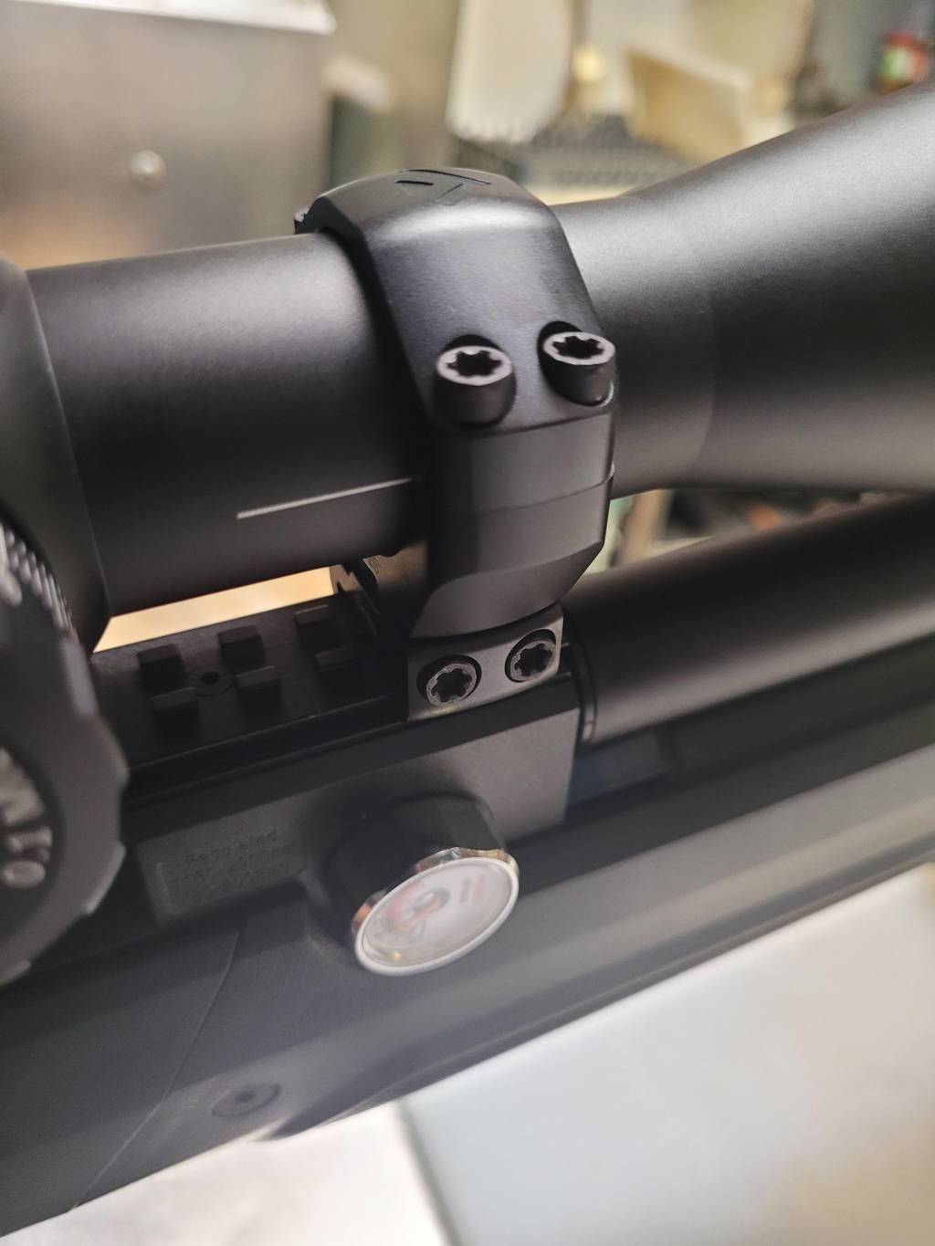

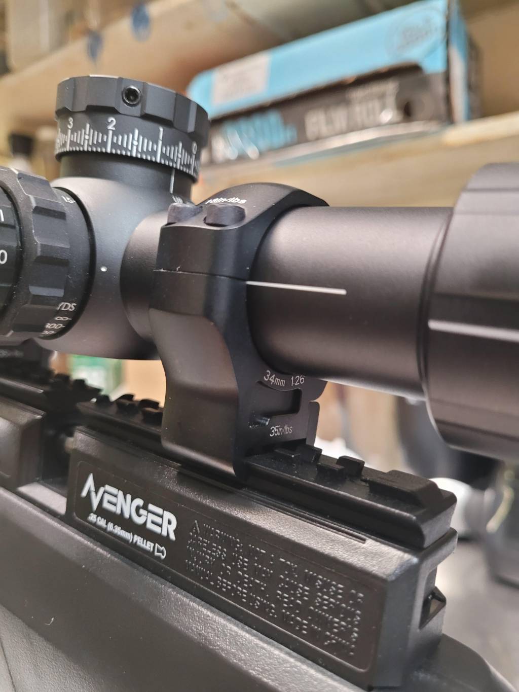

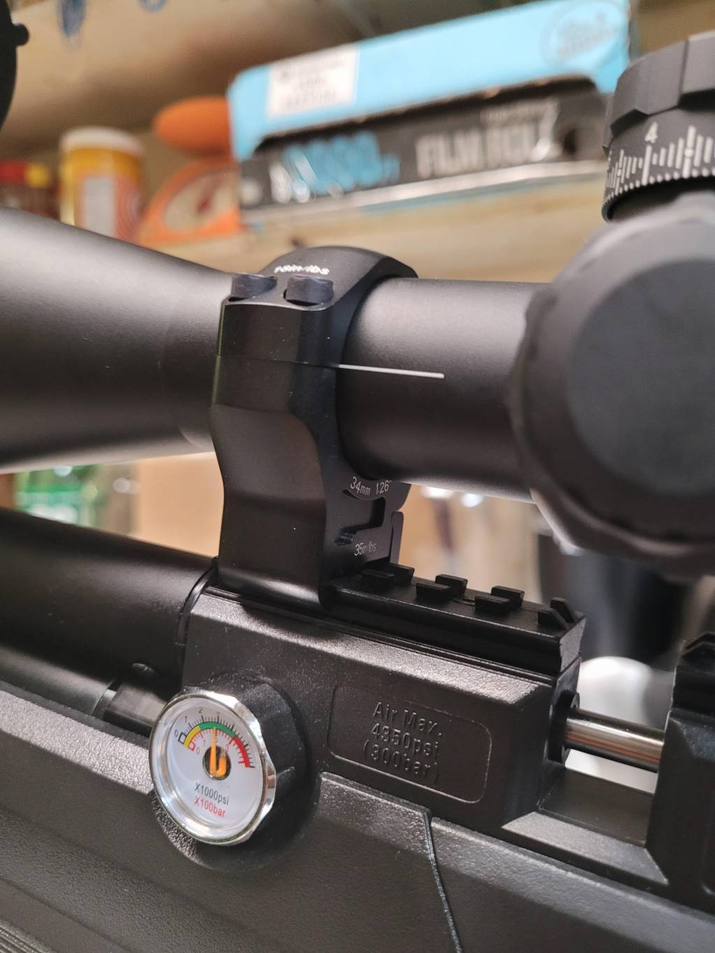

Thanks everyone who chimmed in regarding my windage issue on the Avenger. So unmounted the scope, flipped the scope mounts around from front to back and Viola, everything is good again. These are Arken mounts that were torqued slightly under recommended specs just to be safe and yes, it's very weird that there is no gap between the rings. I'll attach pictures of the scope rings fully backed put and you'll notice that there is still no gap with no tension.
That scope has a 4 mil both way windage stop built into the cap. Take cap off and use a flathead screwdriver or re align cap for more adjustment. This info is not in the manual.
Also make sure you are grouping otherwise make sure you are not clipping. Teflon tape is great advice.
I discovered this exact issue with my recently arrived 4-20x50 I realigned the cap and got the adjustment range I needed.
