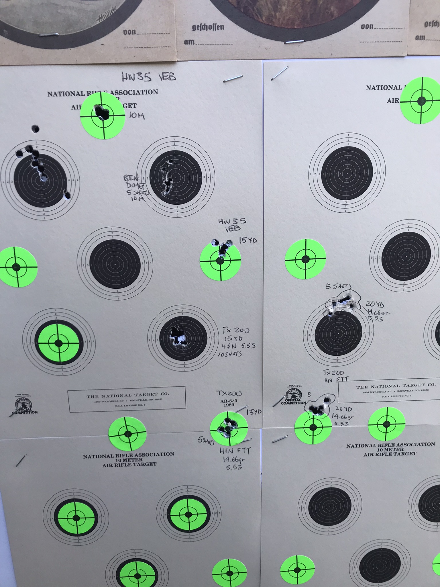

All… just getting into airguns, less than 200 shots fired… I have three rifles, HW35 with SWFA 12X, RWS54 with SWFA 3-15X, and an AirArms TX200 with a ceepo BSA 3-9x. The two German guns are in .177 and the Brit is in .22.
Shooting them today I discovered something very different from my experience shooting center-fier and rimfire guns.
The air gun were all zero at 10 meters initially. My HW35 is a 7.5 joule version and I finally got a scope on it that works. My AA200 had no issues and dialed in just fine. The 177 pellets was a mix of pellets I had from when I first obtained the Weihrauch in Germany. The gun and pellets is around 40 years old. Theses pellets are VEB, HN, and RWS. The .22 cal are all newly delivered HN from PA. I brought two different weight and different size. I have not chronograph them for velocity yet.
The other distance I shot my rifles at were 15 yards and 20 yards (max fir my yard). The interesting thing I discovered is the point of impact goes higher as I get further. This is with both the Weihrauch and AirArms. Didn’t have time or energy to mess with my RWS
So… you more experienced airgun shooters, help me understand ballistics of air guns.
Ive attached a photo of some of the groups shot. Generally, I get about .5 inch change from 10m to 15y. About 1” from 15y to 20y.
The center green dot was my Weihrauch at 10m and nest green dot lower right was at 15yards. My TX200 zero groups are further down and right. With this info, what distance should I zero my rifles for field target matches and hunting. I suspect I will not be engaging anything past 50yards.

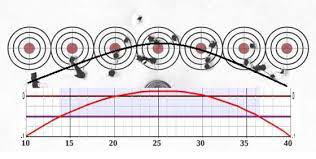

As suggested in the earlier posts, zero your gun around the 25-30 yard mark. Somewhere around these yardages would be the apex of your pellet flight. see diagram below. Note that the POI (black line) is for a 25 yard zero.
Currently your guns were zeroed for 10 m (I assumed to shoot 10 m indoors?). The POI at 15 and 20 yards are consistent with a 10 m Zero. If you look at the above diagram. The red line is the approximate trajectory of your pellet. If you zero at 10m, following the red line your POI be high at 15, higher still at 20...you'll be highest around 25-30 yard....then your POI will start coming down.
Hope that helps. When I started shooting air rifle, it was confusing me at the beginning too.
Thank you JP for this very informative reply… I am currently shooting in my backyard… and the wife’s flower beds limited me to max range of 20 yards… I started at 10 meter as the initial distance to zero only because of the rifle targets I had on hand to use as metric for accuracy…
… shooting at my club’s airgun range will validate my zeros at actual distances shot… will get better ballistics tables once I get the needed programs/apps and data from my chronograph…
