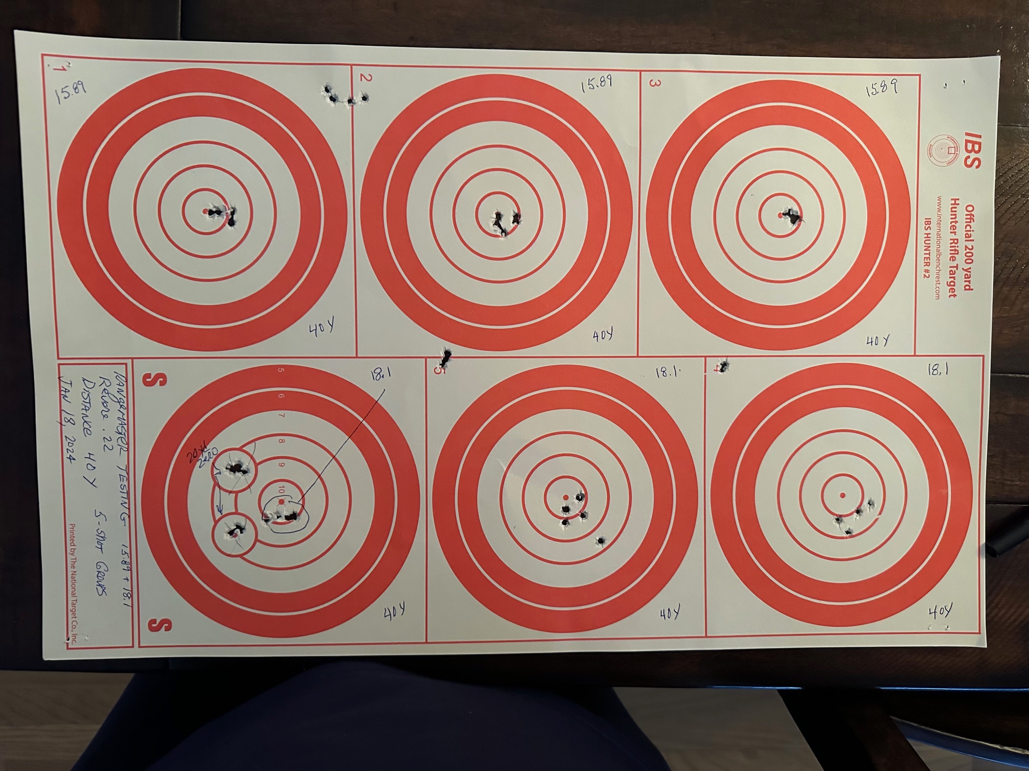

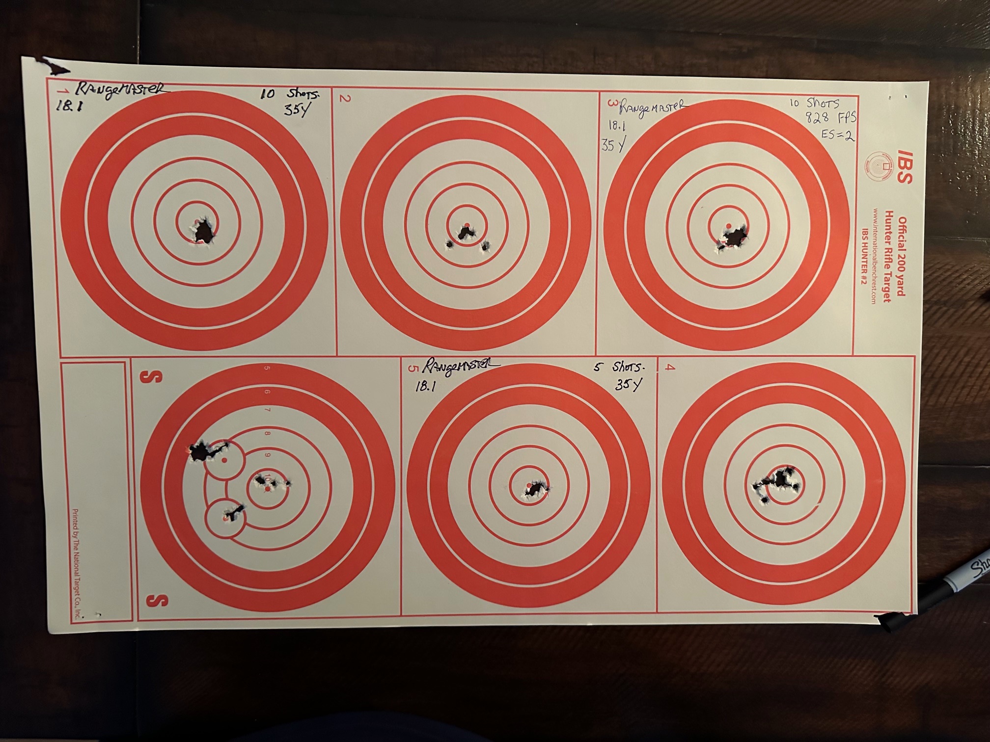

I was out yesterday, and had time today to snap some pics.
I shot both the 15.89 and 18.1g Rangemaster pellets, on a cold windy day. Not a great day to do some testing, as I like to see best possible conditions for 30-50 yard target practice especially with 'new to me' pellets. This was group testing, so no skill was involved. I just wanted to see how they would do.

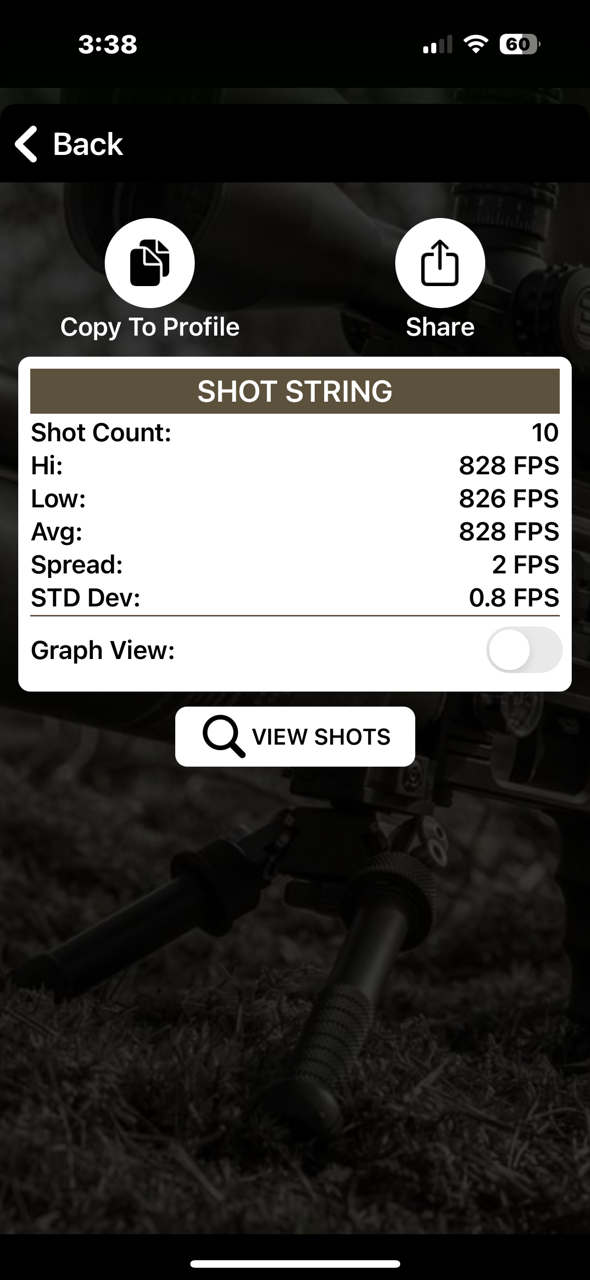

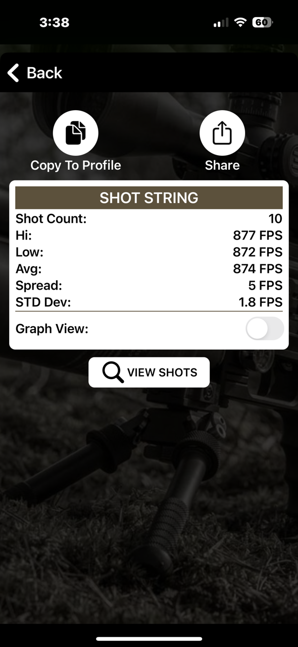

I did a lot of chrony runs with the FX Radar Pocket Chrony, but I will just show a couple of strings. NET: The 15.89 shot better at 40Y than the 18.1, which is my 'go to pellet' for the Revere anyway. I do want to try this again on a light wind day, but I can't really say that the Rangemasters are better than the JSB just yet.
I have had the FX Radar for about 3 years nearly, and for whatever reason, I did not know that my iPhone placement near the muzzle where I hang my rubberband FX radar on the moderator, was important.
In the past, I have had missed shots and have had to slide the rubber band bracket back and forth at times, because it would not record. I tried moving my iPhone right next to the Chrony, and I had about a dozen good shot strings with NO Misses.
