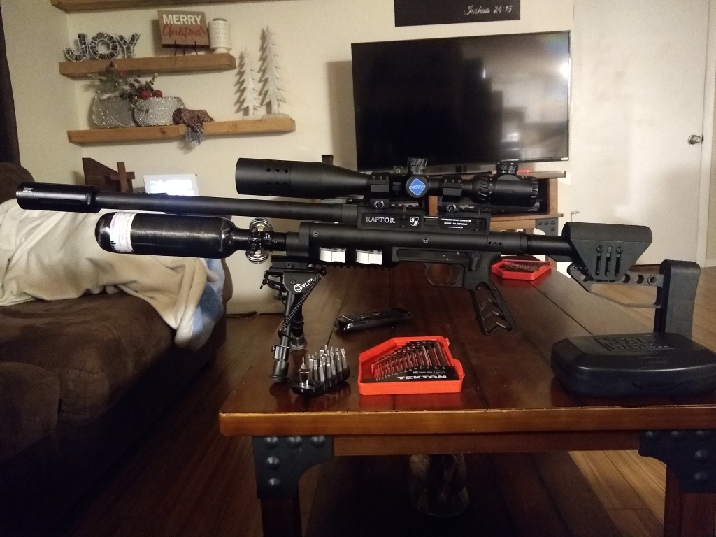

So update kinda. Haven't shot the gun really all that much. I pulled the barrel to check the barrel port which was at .165". I opened it to .175x.190. Put it back together and still feeds pellets nicely. I have the reg set at 150bar. Will hopefully test tomorrow to see what it can do. Was thinking about doing it tonight but it's 15 degrees lol. Yeah I'm staying warm inside. Also changed out the scope to my 4.5-18x44 Discovery VT-2.

I got to shoot it this afternoon for about 10 min at 25yds. Was going to tune it but my chrony battery was dead. Shot some 23gr NSAs which didn't do hot, RD monsters which were pretty good but the 18gr were the best at where it's tuned right now. Also I did test the tensioned barrel system out on trying to get it to change poi but the smacking I did and moving the barrel in every way possible still hit dead center the next shot. So I can have full faith in it keeping it's zero.
