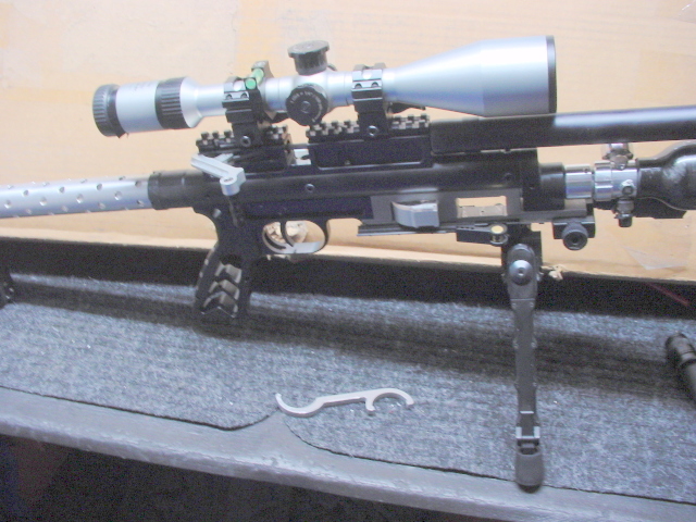

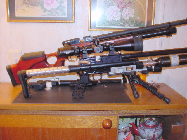

It DOES seem to be Mrod based but it seems to me to be a good workable design with some very positive attributes. I don't think someone should buy it unless they are wanting to tinker... but that's just my opinion .
I was just relating some of the notes and process to get Franklink's rifle to where it is. He bought it knowing that he wanted to experiment so my only real job was to get a good 22 barrel fitted to it. Turned out to have a few difficulties but one was based on my suggestion for the C707 barrel. Turned out to be less than perfect for this application.
I still think they give quite a bit of rifle for the price point.

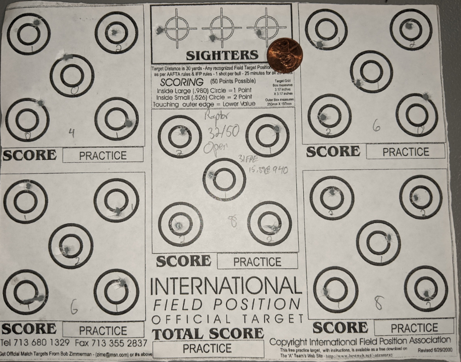

It was set up with that Career barrel a few days before the FT match last weekend when I got a wild hair to shoot it at the match.....at midnight, two nights before I was planning on heading to the match. So, out to the garage. Took 5 or 10 minutes to do the caliber swap and another 20 or so in front of the chronograph to get it to a 20fpe .20 cal gun. I wasn't liking that the hammer spring adjust was only hanging on by 1 or 2 threads so cut down a long and even thinner wired spring. That is the third step-down in spring wire diameter from the hammer spring it came with. So, new spring and power adjust in about 6 full revolutions + some tinkering with the striker length got me a pretty consistent 19.5fpe. A spread of about 30fps is really about the tightest the gun can do at 20fpe. I think the balanced valve is just more appropriate for higher fpe.
When I had pulled the Daystate barrel, I left the shroud and endcaps all assembled and was thinking I could shoot it at 20fpe in .20 at the match with just the bare barrel, no shroud. During practice the day before the match, I found the barrel could wiggle a little without the shroud holding everything tight, so stole the shroud off the Daystate barrel/shroud assembly (thinking it'd be nice to have an extra piece of tubing/shroud to leave that one assembled).
Worked out all my distances and impact points and was feeling pretty confident with it, thinking I was semi-prepared for competition.
During the match I had some really low-impacting pellets. On one of the longer shots I saw the pellet hit the ground in front of the target. I also saw some pellets hitting inches low on the face plate. Finished with a 33/52, not knowing what the problem was, but knowing I had a serious one somewhere.

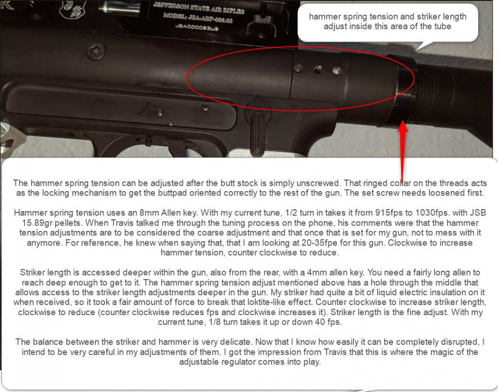

I’ve been tinkering with lighter weight hammers for the raptor with great success.
I removed the oring this sits on the valve face, I have a feeling that oring cushion is detrimental to ES.
I am now using a 25gram hammer with peek striker. Striker is flush with hammer face. To make up for the lighter hammer I did need a stronger hammer spring. I got a hold of some 17lb hammer springs. Cocking is still easy because it’s a side lever, but definitely tell the cocking is harder. Smooth but firm.
.25 34gr JSB mk2 are launching at 920fps on 1900psi reg pressure.
Now there is no need to adjust both hammer spring and buffer. Only hammer spring.
Raptor report is now a lot snappier and my ES has improved. Getting much more dupes on the chrony.

Going from 50 gr to 25 gr hammer in my experience only required more spring, which made both the cocking effort and the trigger pull much worse..I saw zero increase in efficiency, or power by going from 50 gr to 25 gr, so I went back to a 50 gr. Also my hammer buffer has been giving me long shot strings that the only variance in fps resulting from weight variance in the projectiles I am launching (5 fps spread / 24 shots - 2 SD - 60 fpe)....so I wouldn't be so quick to conclude your buffer was causing erratic es unless it was operator error (bad tune...)
Just don't want to encourage others to go this route when there are clearly reasons not to. I recall your last raptor string was hovering around 1.4 fpe/ci at that power level...did you confidently increase that with this 25 gr hammer?
The lighter the hammer used the better to achieve the best efficiency as the lighter hammers are better able to get off the valve the quickest to limit valve dwell. A lot of other factors are at play as well with valve and hammer spring size and rates along with porting size. It's the balancing of these key areas that makes a good shooter a great shooter.
