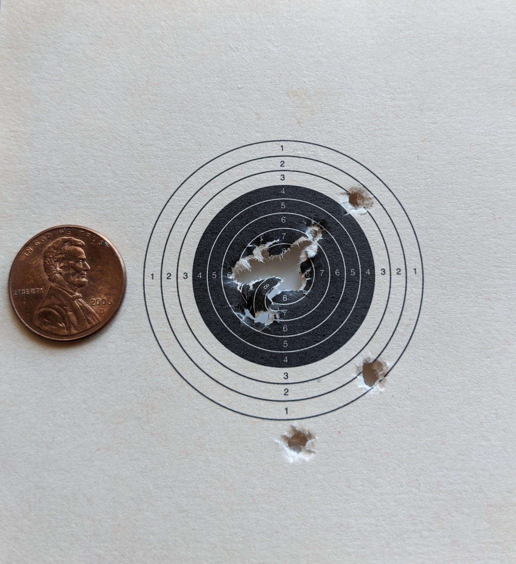

This is a full mag (12 shots) @ 55 yards. I pulled the high right shot but the two low shots were entirely the gun. This has been a prevalent problem. I was actually testing my theory that the reg is the problem by timing my shots with a stopwatch. I gave it 25 seconds between each shot, but still had the low ones.
My other thought is that the low shots might be due to sear drag. The gun sounds slightly different when the pellets impact low.
I've thus far tried three different locations with the barrel indexing. None have gotten rid of the low shots but I don't think it's a barrel issue causing the low ones. I do think that this current barrel position seems to throw the majority of the pellets into a tighter group than the previous two positions.
Also, these pellets were cleaned and lubed with Slick50.

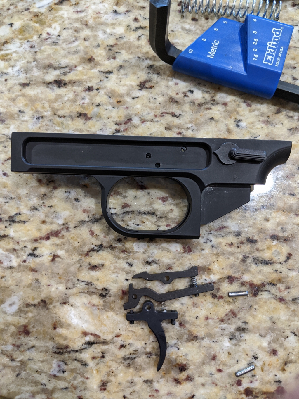

Yesterday the gun quit cocking. It had been getting progressively more difficult to cock, requiring an extra little bit of effort right at the end of the cocking lever to get the sear to engage. I had adjusted the trigger to lighten it as it was probably in the 2# area when I got it. As previously stated, I had it adjusted down to somewhere around 1/2-1 pound. When this became a problem I assumed I had adjusted it to the point that it couldn't engage the sear. But, after talking to Travis today, it appears that a screw worked it's way out of one of the trigger levers.
The Allen key is pointing to the missing screw here. That lever sits under the safety and without the screw, cannot push the sear high enough to engage with the striker.
(Much thanks to AzRover with trying to diagnose the problem here.)
So, Travis called today and informed me that he's got a new complete trigger group in the mail, heading my way. I've definitely had some troubles with my Raptor but sure can't fault JSARs customer service and product support in any way.

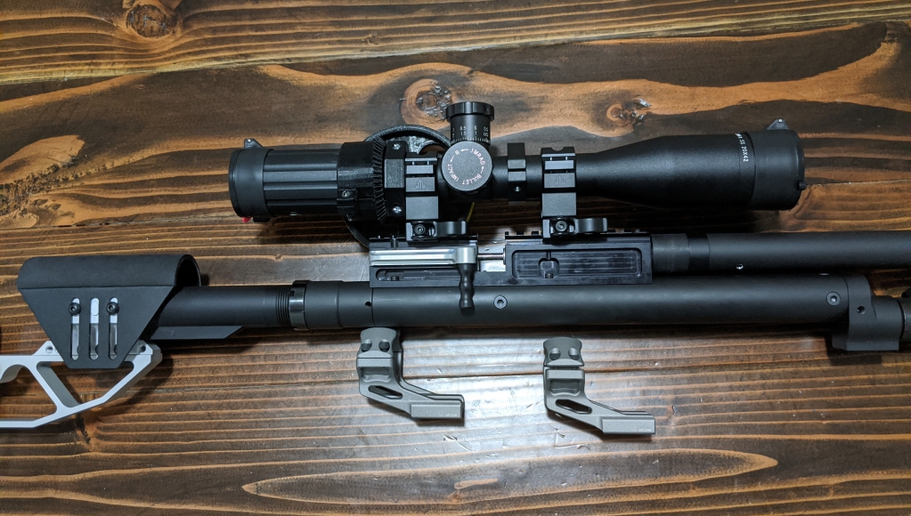

The initial plan was to use these silver cerakoted offset rings.
WIth the silver color and the cutouts, they just seemed like they'd be a good match for the rifle. The problem was that the offsets were simply too great for the scope's eye relief. And i couldnt turn them around with getting into the gears for the sidewheel attachment. Was kinda bummed that they wouldn't work, but told myself the color wasn't quite a match anyway (attempt to make myself feel better about it).

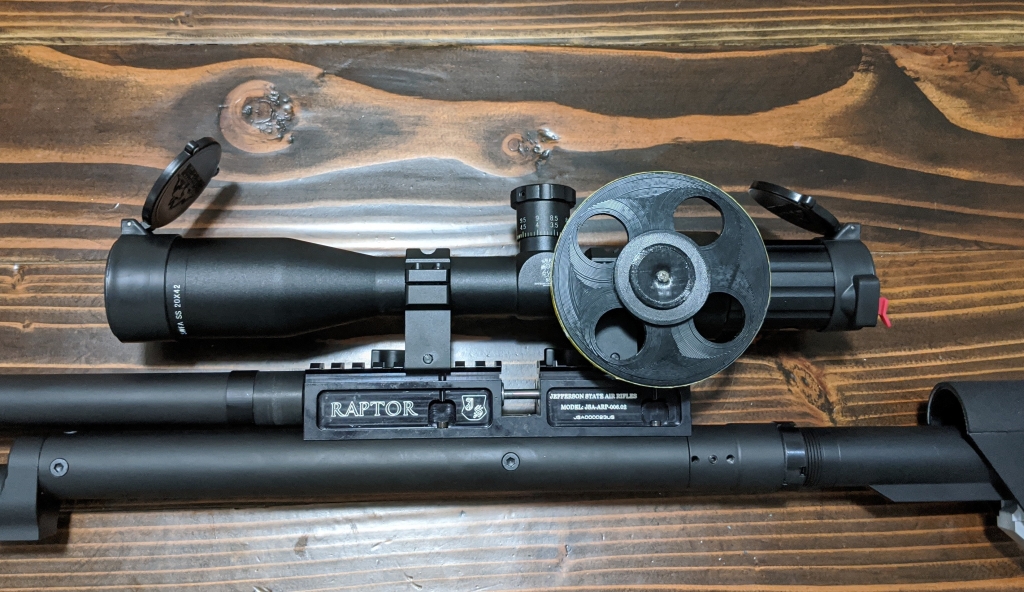

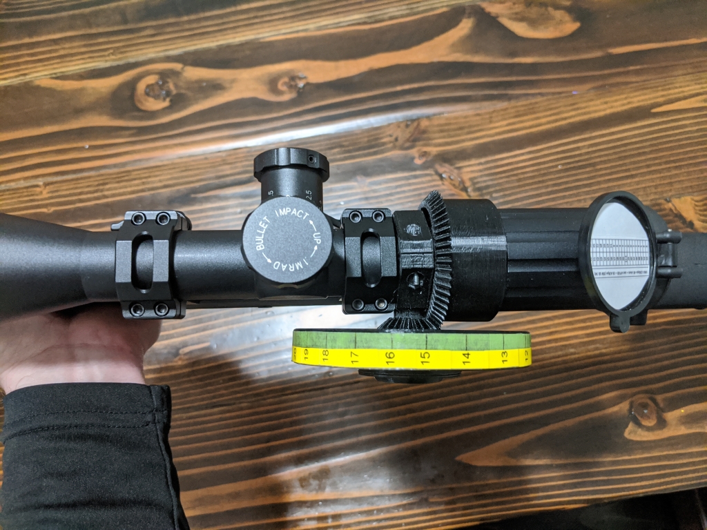

So, up til tonight I was using some REALLY cheap mounts that I had retired into a junk box some time ago. I had them both placed in front of the turret-less than ideal.
I ordered in some new UTG mounts. I've had good results using the lever lock type and decided to go with them again. I chose high mounts because I wanted to make single-loading easier and allow plenty of clearance for the magazine.
Mounting this scope was a little bit of a pain, mostly because of the 3d printed contraption I use to convert the rear ao swfa 20x to a sidewheel set-up. That device takes up a fair amount of the scope tube, right in front of the rear bell. I also needed to make sure the lever lock didnt stick into the breech cut-out. There isn't enough wheel clearance on the other side to put the levers on that side, and even if there was, I wouldn't want to take the wheel off in order to release the levers on the scope mount.
So, I got the scope mounted in a way I like and that didn't cause problems with the 3d printed sidewheel, or the breech cut-out for loading pellets. But it kicked the scope back about an inch. That lead me to the stock adjustments while trying to get the eye relief right.

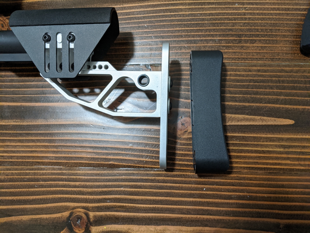

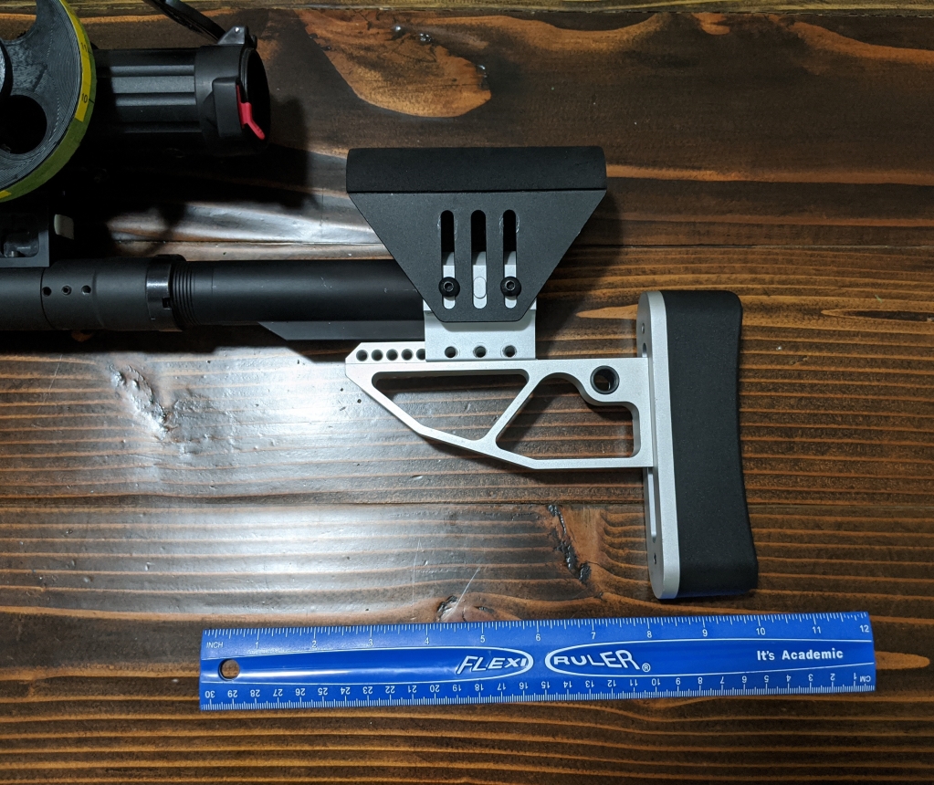

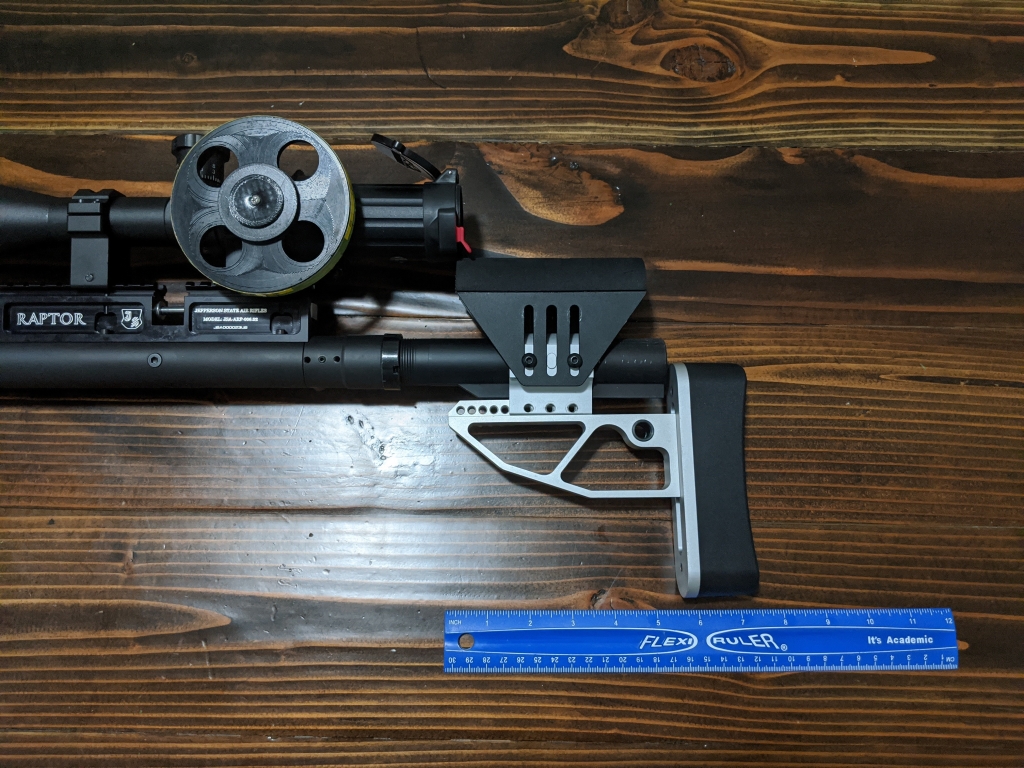

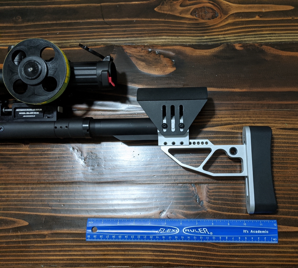

I decided to take some pics of the full range of adjustment on the butt stock, while I had the screws out and was playing with it. LOTS of range.
The ruler is lined up with the junction of the gun's tube, and the butt stock tube. The angle makes it look slightly off in the pics but it's pretty close to the same place in each of them.
All that range would fit a wide range of shooter preference and size, from 6'5" 280# MAN (not me), to my six year old son, or a lady shooter in the middle.
The cheekrest is high here just to give enough room to access the screws underneath. I can't even imagine how high the scope rings would need to be to need that much vertical adjustment on the cheek piece. Even with these really high rings, I'm only needing about 1/8inch up from its lowest setting for things to feel right.

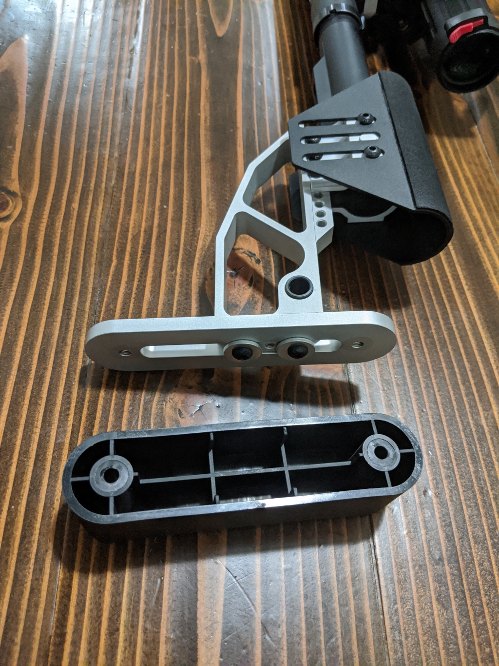

While I was at it I decided to see what the shoulder pad adjustment looks like.
I adjusted it down a little. Butt "pad" is just a hard hollow plastic. There's no way to grind out the section between the holes for a more curved buttpad.
I do see some potential for FT customization here. It would not be too hard to retrofit one of the 3d printed or machined aluminum butthooks onto the baseplate.
I'm also seeing that the rear-ward weight I was looking to add could be placed inside the current hollow butt pad, or inside the buttstock tube. Hmmmm ideas ideas.

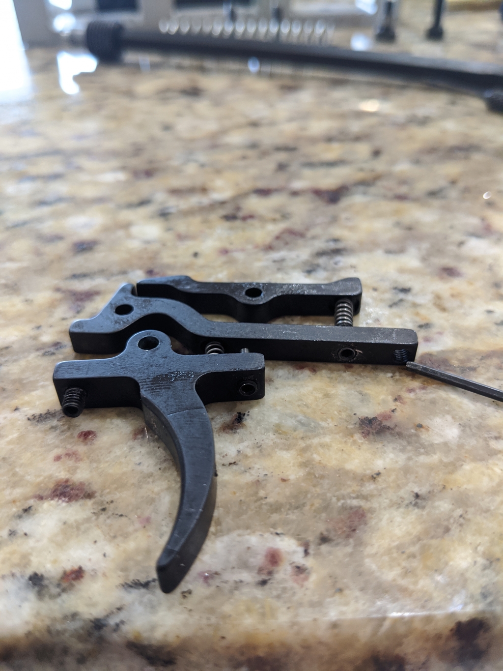

Trigger:
The new trigger group arrived with enough daylight left for me to get the gun together and shoot for 4 or 5 hours. I'd guess I shot it a couple hundred times.
First impressions from those couple hundred shots, 1000x better trigger than the first gen trigger. I'd like to qualify that statement a bit though. My 1st gen trigger never seemed quite right, so I'm not sure my experience with it was typical. It was good, but not great. That is further evidenced by the fact that it quit cocking. I'd guess there are many first gens out there without the problems mine had.
Improvements felt on the very first shot:
  • cocking is now much smoother
  • the sear engages much more solidly now
  • the trigger is much lighter, overall
  • BREAKS MUCH MORE CLEANLY
And that was all without any sort of adjustments, just bolted it on and got to shooting.
The only place I can see myself possibly wanting to adjust it would be to lighten up that first stage just a hair. Although, with how much better my shooting session went today, I may just leave it as-is.

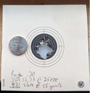

New best group:
Switched pellets from the 15.89 to the 13.73 JSB.
New trigger.
Changed the power output.
I dunno what made the difference, but I was VERY happy with how this group turned out.
My scribble says that I'm shooting the 13.73 at about 25fpe. 21 shots in this group. Taken at 55 yards. Why 21 shots? cuz that's how many were left in the tin that I finished off. I'd have probably kept going if I had more pellets sitting there on my bench.
It's not quite under a nickel, but pretty dang close. I know, I know, the dime is the standard, but if a guy shoots a 21 shot group does that make a nickel acceptable?

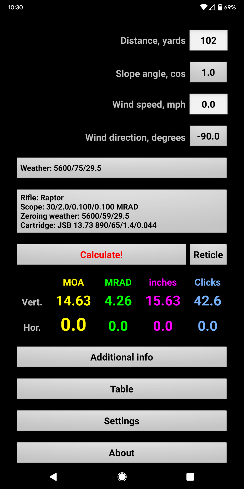

Long range/low power:
I was able to get out and try the gun at long range today. Once I got my targets set up and ranged from my little bench/table, I had 102 yards.
There was more wind than the forecast called for. Id guess 8-10mph, peaking out around 12-14. I taped my targets to a cardboard box that I had thrown a chunk of firewood in to keep it from blowing. It was windy enough that I could see the box moving slightly with the breeze.
Wind was quartering in, mostly from 1 o clock but would shift back and forth from 11 o clock.
This was the best group of the day and required 3-4 inches of hold off and 2-3 inches of vertical adjustment for the incoming wind.
Ten shots, about 2.25inches or 9 shots in 1.75 inches if I throw out the one in the black.
Not the greatest long range shooting, but for light pellets at only 24 fpe at 100 yards in really shifty winds, I felt pretty good about it.
My time with the gun so far has me thinking that it'll shoot a lot tighter 100 yard group, just would need a day with no wind, or more consistent wind than I was fighting today.
I tried to crank up the power and even switched over to the 15.89 gr JSB but couldn't shoot a better group than this one.
Barrel seems to really prefer the 13.73 over the 15.89.
