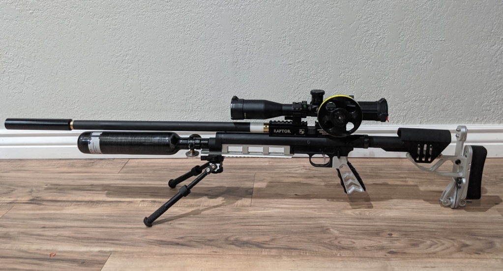

Well, I've got seven tins (500count) through the gun now. The side lever and trigger seem to have gotten smoother. Although, the new trigger probably only has about two tins under it's belt.
The gun is just a joy to shoot, very enjoyable overall experience.
So, yeah, I'm still quite happy with the purchase. There aren't any other guns out there, that I'm aware of, that have this collection of features at this price.
If remember right, I got the gun the Monday after Thanksgiving. So that'd put ownership a little over 5 weeks.
Travis just posted yesterday that the adjustable regs arrives and they look SWEET. The gauges look big and readable. I was afraid they'd be the little ninja gauges with hash marks at each thousand psi but they look like the nice big one with 100psi increments like on my USFT.

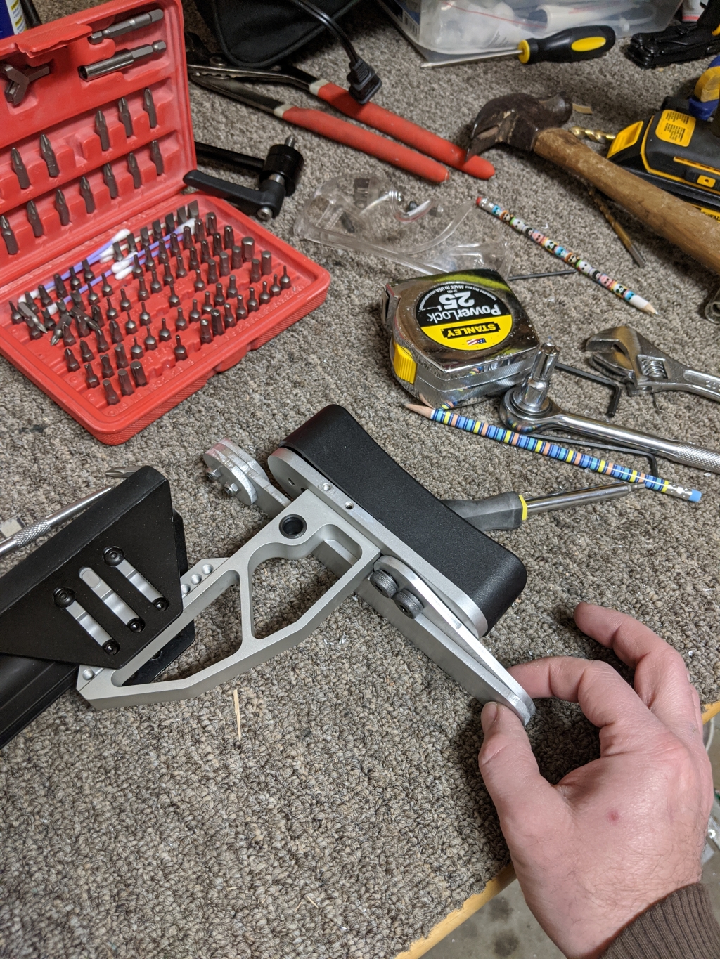

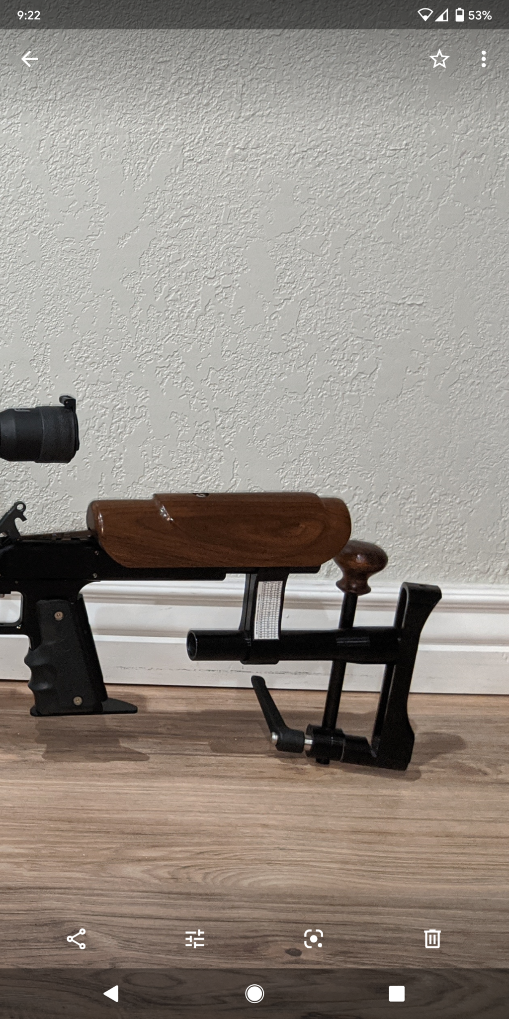

I built a thigh rest for the Raptor. For Open class they are legal and, in my opinion, really help with side to side stability. They essentially swing down from the stored position to....rest on the thigh.
Here's a pic of one for those unfamiliar:
The cam/lever unlocks to swing it down to the thigh, and locks it in position, at either the stored or deployed positions.
Here's the one I built for the Raptor:
This one is lacking the cam lever (should be here on Monday). It will pivot where I'm am pinching and unlock to swing down and be lockable in the stored or deployed position like the one in the first picture.
Aluminum seemed the obvious choice. Kind of interesting back story to where the aluminum plate came from.....I grew up on a ranch in Oklahoma. For a growing boy, a couple thousand acres was an awesome place the hunt and fish and just roam wherever I wanted. Well we had these signs posted everywhere, keep out, no trespassing, that sort of thing. Well when the ranch sold when I was about 20, the signs were taken down and placed into a big conex (among a bunch of other random stuff) that was then moved here to AZ. I noticed the signs a couple months ago and made a mental note that they were there. When needing some decently thick aluminum plate for the Raptor thigh rest, I went and grabbed a sign. Turns out aluminum can be cut with a jigsaw and shaped with a belt sander. Took longer than necessary with the lack of proper tools but seems like it'll work for the intended use. Kind of cool, in a nostalgic way, to literally have a piece of the ranch on the gun.
I also ordered some other cheap baubles that I think I can turn into a convertible bag rider or butt hook (facing front or back).

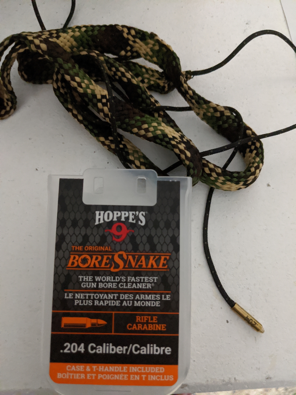

I'm learning that my LW barrel likes to be REALLY clean. I had been taking the barrel off to clean each time with a rod from the breech end, but I had my kids get me this for Christmas (wife asked for ideas).
Today I finally got around to cutting the brass weight down short enough to make the turn into the barrel from the breech cutout. Brass weight was about twice as long. Also gave it a blunt point while I was at it. I was afraid the reduced weight wouldn't carry it down the barrel but I turned the gun muzzle down and it fell right through, no issues with the Donny moderator even. Quite pleased with how it worked.

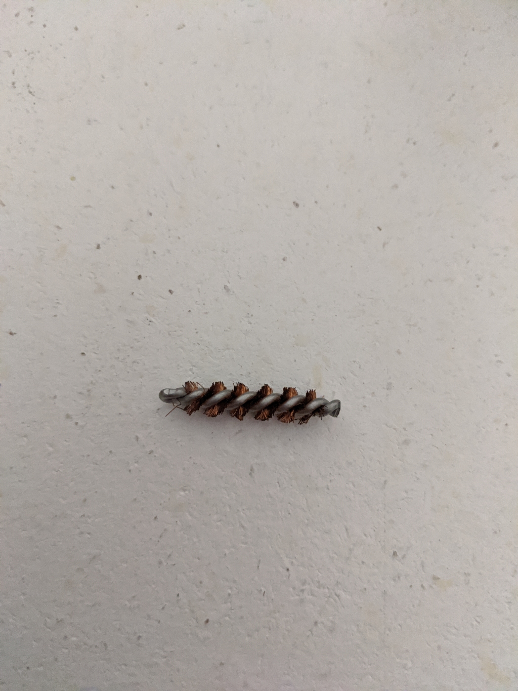

I should probably point out that I removed this little gem from the pull through too. I'm not against a brass brush in an airgun barrel, just think it's a bad idea if it's passing through an oring. The bore snake is just braided around the brush so it's not too tough to carefully separate the braiding enough to remove the brush.

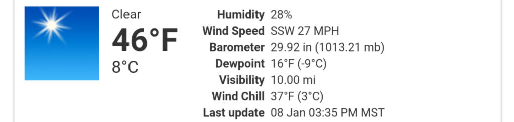

This was my weather today. Pretty windy.

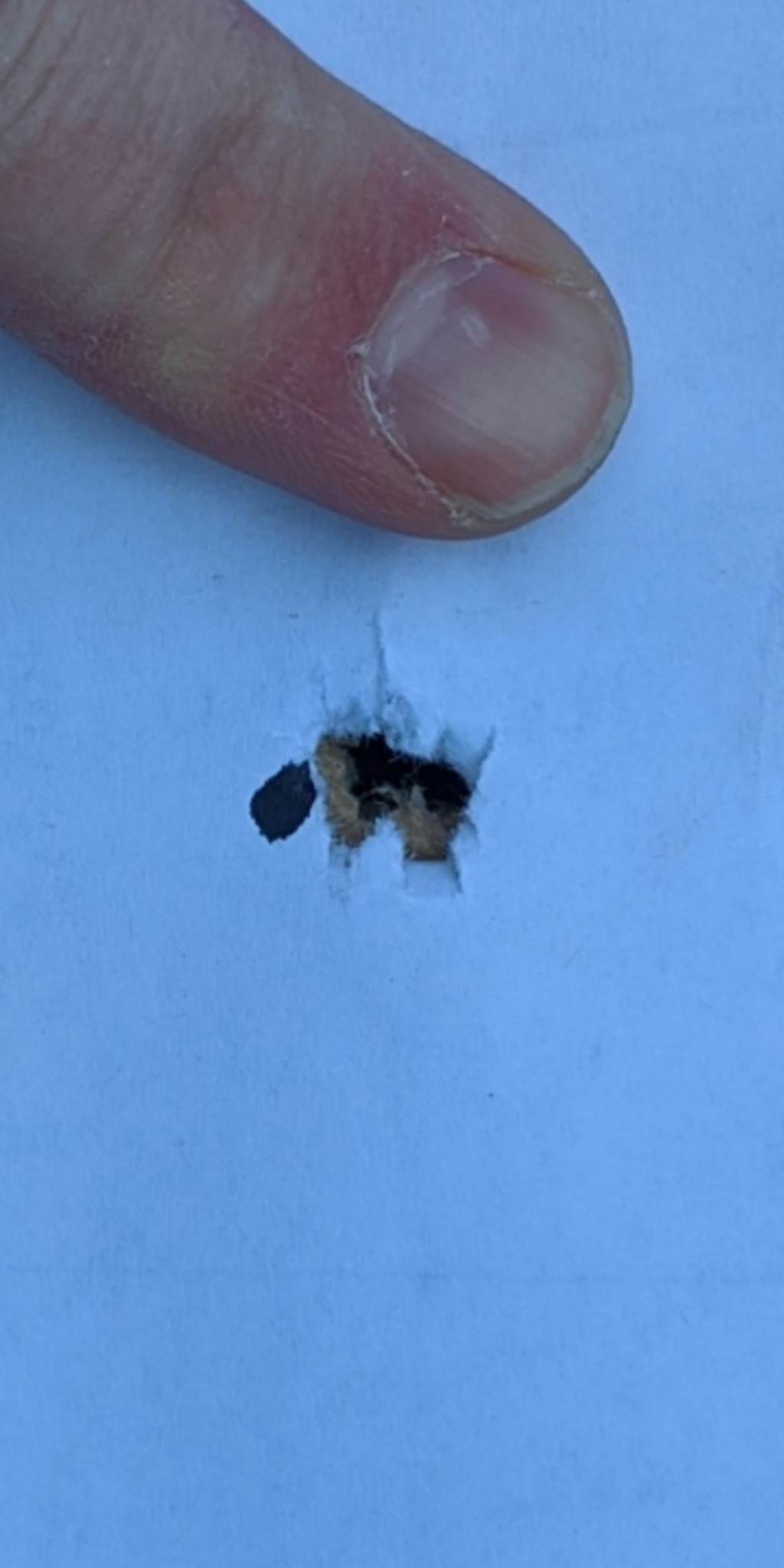

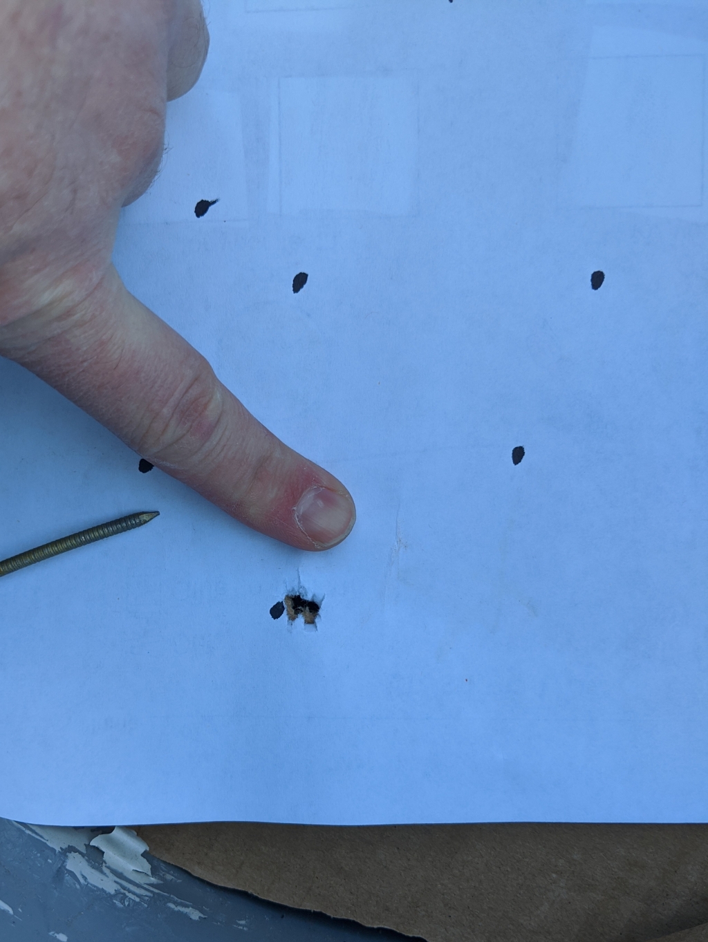

So, after the pull through, these were the first five shots at 30 yards to verify that my zero is still good.
It kinda looks like two shots but a close up shows the lead marks on the paper, three across the top of the hole, one on the right side, and one bottom left. The group is a hair to the right it seems. Possibly subconscious accounting for the right to left wind though.
Then I took it to 54 yards. This is ten shots, wind grabbed two of them just a bit. I was holding dead on for all 10 shots, as I was curious to see what kind of wind drift I'd get.

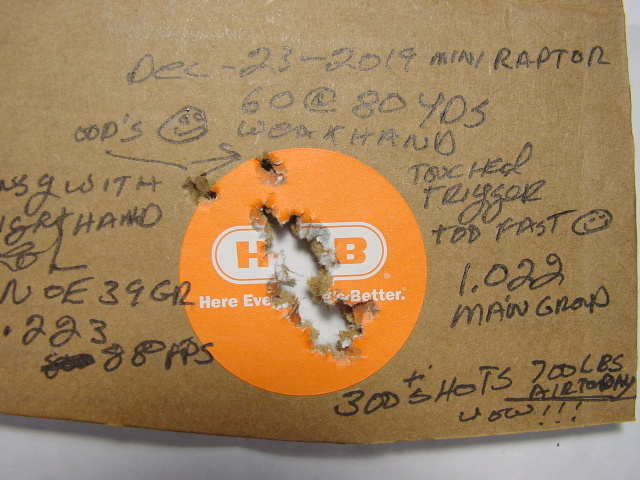

You mentioned concern about the twist rate being possibly bad for lon
g projectiles in the .22. My barrel is 1-20 and is shooting slugs at 39 grs, quite long and is deadly accurate. More so than the 1-16 the slug calls for. Odd, but barrels like what they like. LOL!
The pic is 60 of them at 80 yards. Hand hurting, and shot them with my off hand. Terrible trigger control that way.. GRRRR!!!

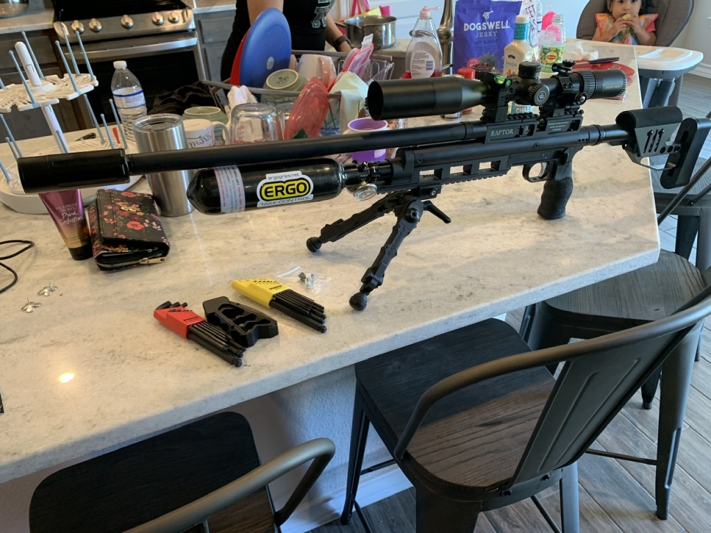

Just a few days after I got the Raptor back with the adjustable regulator installed, it went to a machinist friend's house. We had gone in together on the last 4 Career 707 barrels in .22 (new/old stock) that a gentleman in New York had. I don't know the whole story, but that guy was somehow involved in importing the Korean Career guns in the 90s. The plan was for my machinist friend to make one of the barrels fit the Raptor.
The Raptor plan all along was for it to be my tinkerer platform. I really enjoyed swapping barrels and playing with hammer tension, and barrel length, and caliber, and transfer port sizes, etc with the Crosman guns when I first got into airgunning. While I had bunches of fun with those Crosmans, I always felt like the metal was too soft for frequent teardowns. Things would get sloppy with all of my tinkering. I also felt like the Crosman trigger was kind of holding back accuracy. So, the Raptor was purchased as a testing platform. I hoped that the good trigger, adjustable regulator, adjustable hammer tension, easily swappable hammer springs, and easily swappable barrels would let me test to my hearts desire.
So it went to the machinist friends house with those 4 Career barrels. I heard from him a couple weeks later and the Career barrels weren't long enough for the factory shroud to be used. He had also decided to machine me up a regular .22 polygon barrel LW barrel, no choke, as well as a barrel that came out of the Daystate ART testing program. I don't know all the details, but I believe it's close, if not exactly the same as the poly LWs that are going into the current production Red Wolf HP and Safari barrels. AOA was on board with the barrel going into the Raptor. My opinion about this is that placing their barrel into the Raptor gives them yet another data point for the ART testing that they're so passionate about. With the Raptor being capable of such big FPE, but also being a non-electronic gun, this will give them more information about the barrels they and Lothar Walther have worked so carefully to perfect. Let me state here that I am not part of the ART program, but the friend that did the machining is, and he shot the Raptor with the ART barrel in it prior to returning it to me. He also told me that other ART members had shot the Raptor while he had it. I'm guessing there was some ART testing happening there. So, I guess I'm a guinea pig, which goes back to that tuning and testing platform that I had envisioned for the Raptor from the get-go.
All said and done, I have 4 barrels for the Raptor now: the .20, 12 land and groove LW, thimballed barrel that it came from JSAR with, the .22 thimballed Korean barrel (guessing it's about 18-19 inches long), a .22 unchoked LW poly that is the same length as the factory .20-this one is thimballed too, and finally, the .22 polygonal Daystate/LW ART barrel. The ART barrel is a couple inches longer than the OEM Raptor barrel, and also has a transfer port cut directly into the barrel (no thimble).
My machinist friend went above and beyond, machining a delrin spacer (white in pic) so that the factory length shroud could be used with the 23 inch ART barrel. He also machined new end caps from brass for both ends of the shroud. Exceptional work and, although I paid him for it, I still feel like I took advantage.
Overall length is now 47.5 inches with that moderator on there. Definitely a bench gun. And it shoots quite nicely from a bench.

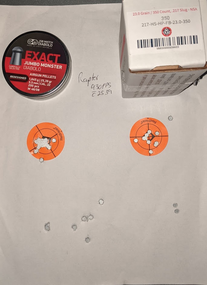

It came back to me with the ART barrel installed and I've not yet had the time or desire to remove it for fiddling, in fact, up until this morning I had shot it less than 100 times, and only to 54 yards. The reg pressure is 1800 and it still has the spring with the reduced wire diameter (from the hammer spring it came with from JSAR). I scrounged up that lighter spring when I had it for a couple days before going to the machinist. That spring does 20fpe with the .20 barrel and is quite a bit lighter than the OEM one.
It's doing 930fps with the JSB 25.39 redesigns, for about 49fpe. Here are some of those couple of shots I've thus far taken with it. This was at about 54 yards from a couple weeks ago. Shots at the bottom of the page were sighters. 10 shot groups.
Not bad at all.

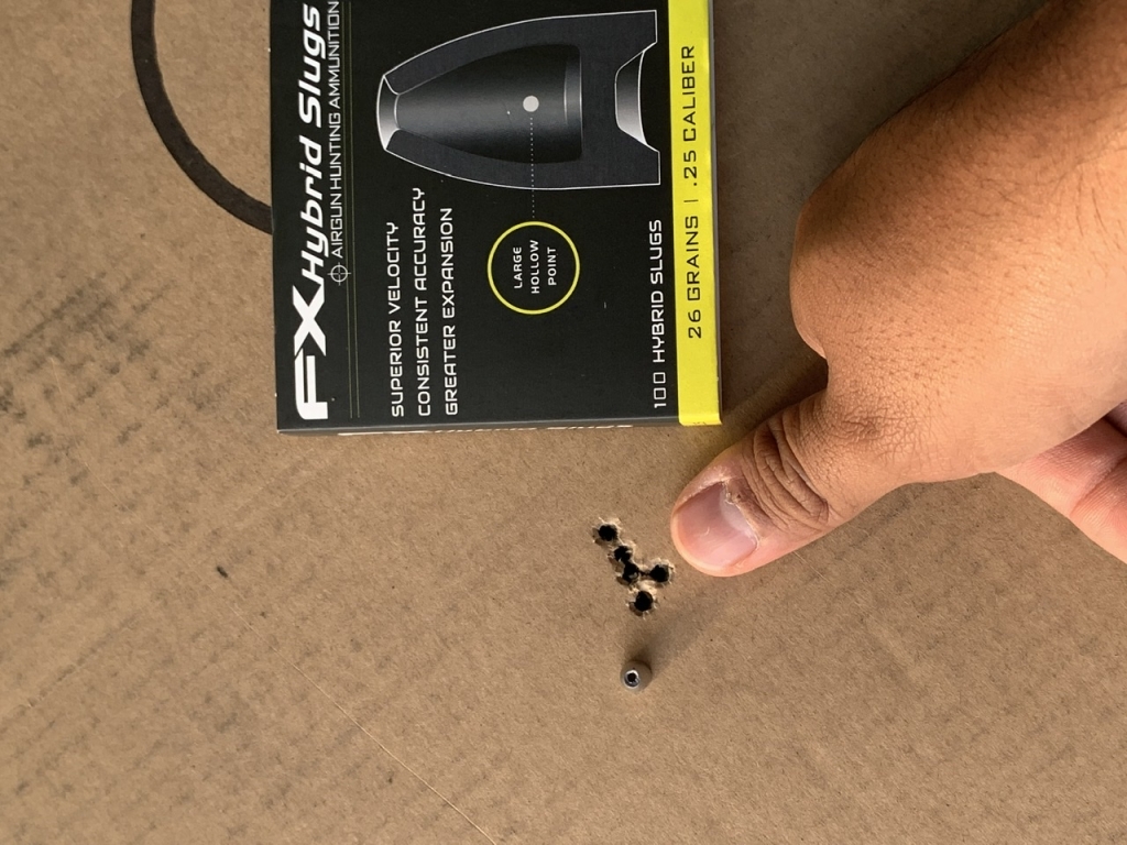

Fast forward to today. I woke up early to go do some low wind, 100 yard shooting and decided to throw the Raptor in last minute. Prior to this morning, 55 yards was the max it had been shot.
Most of my shooting time this morning was used for a different gun, but I shot the Raptor with some slugs and a little bit with the .22 JSB RDs. For slugs, it seemed to do best with the NSA 17.5gr. I had no idea how fast it was going, but was able to do 1.5-2 inch, 10 shot groups out to 100 yards pretty easily.
On the way back in I found some ground squirrels and pest birds and had really good luck connecting with those NSA 17.5s. I made a handful of 150+ yard shots on the ground squirrels, the furthest being a 167 yard shot on a juvenile. Luckily they're young and dumb and let me walk it in with a couple shots. Even that far out, it smacked the crud out of him, could see the effect of the slug smashing into him in the scope, kinda lifted him off his feet and carried him backwards. Hella impressive!
Was texting the machining buddy and we got curious about how fast the slugs were moving. He said they really need to go at least 1000fps. I used strelok and what I remembered for the holdover and was thinking 950fps seemed about right. Got home and put ten shots over the chrono (NSA 17.5s): 1023, 1020, 1026, 1019, 1021, 1021, 1022, 1018, 1025, 1024. Pretty decent ES, and LOTS faster than I thought. That works out to about 41fpe. The 167 yard squirrel that got hit so hard just made me realize these slugs don't shed the energy the way our skirted pellets do.
