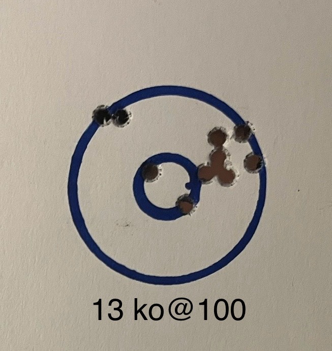

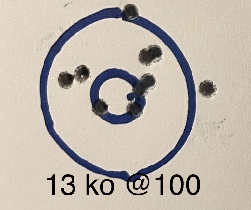

I just got 28” 177 barrel for my ghost and it really likes 13 gr ko slugs and it’s surprisingly accurate at 100 yds. Outer circle 1&9/16” inner 1/2”

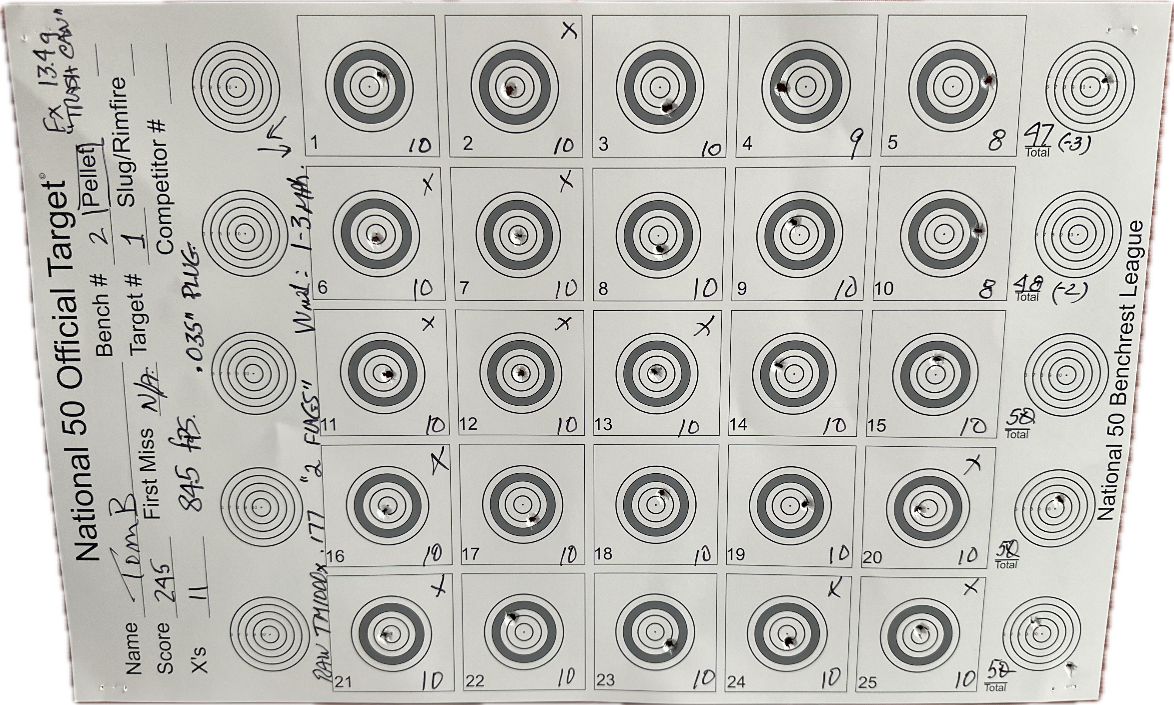

I recently bought a Martin built TM1000X .177 and I am delighted with the accuracy so far out to 50y for BR.
Shot my first N50 card with it on a quiet wind day. It's perfect for the 30 and 40y target challenges as well.
