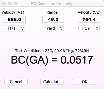

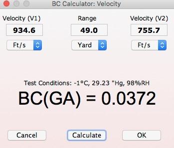

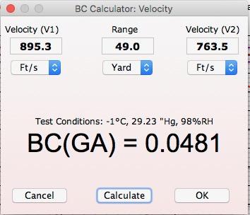

Update: I took the day off today to go speak at the Wisconsin State Capital regarding a proposal to allow ‘high powered air rifles’ during gun-deer season (went extremely well-but that’s a tangent), and I had some time to recheck my BC’s this morning, now that the temp was warmer (30F) and calm. I followed the same procedure discussed above (~1’ from muzzle, then 49 yards back from there). I checked the BC from both the JSB heavies (Mk I) and the H&N Barracudas through my Polygon barrel. The results are as follows:
JSB Heavies:
H&N Barracuda:
It was really something to see the Baraacudas start off 40 fps faster and then drop to slower speeds compared to the JSB’s.
