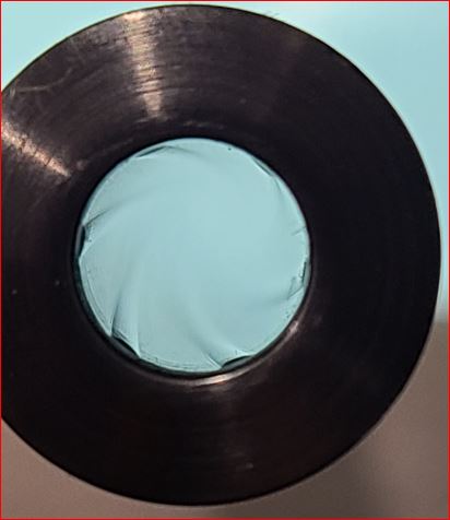

Agreed. In fact Martin was offering a special Cut Rifling barrel made in US.
I wanted to know the comparison between polygonal and that special barrel.

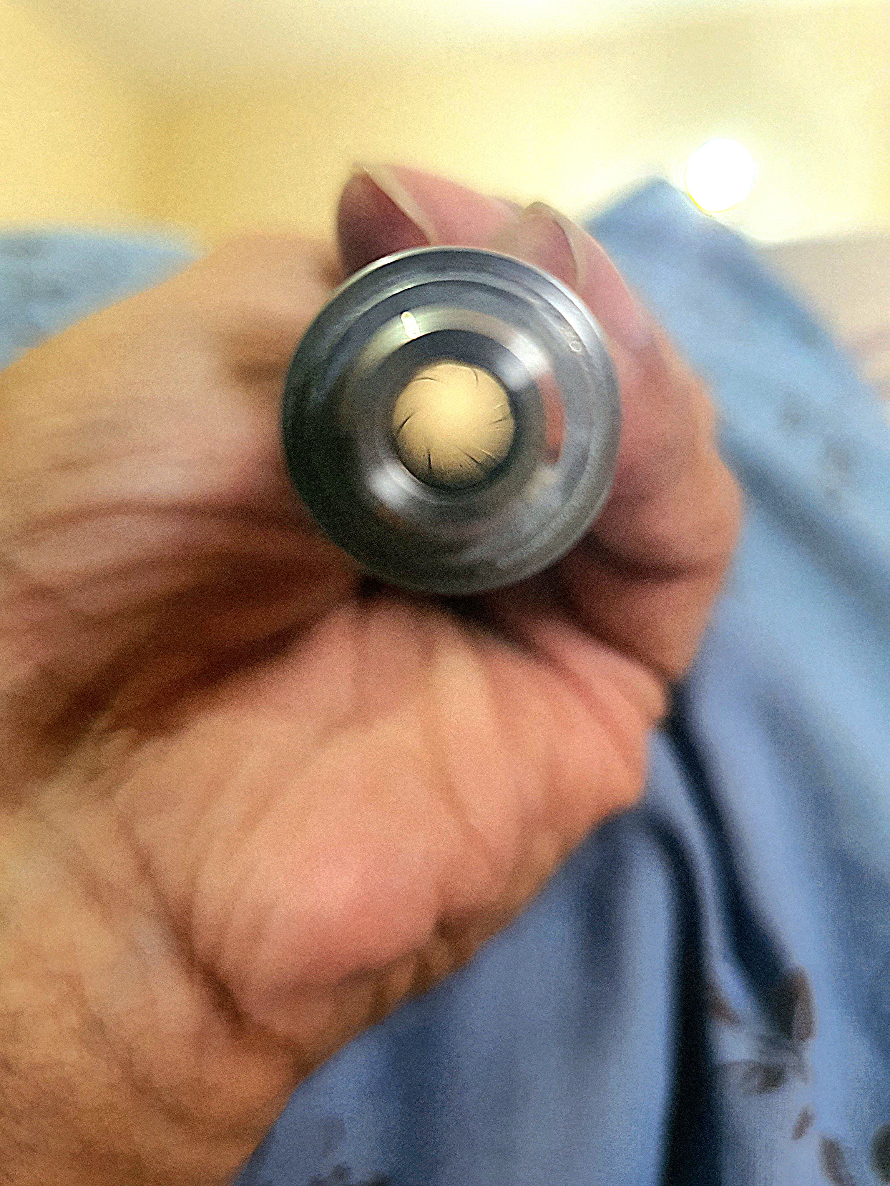

Today contacted Martin and he confirmed that the barrel of my BM500X .22 is cut rifled barrel.
It's neither LW regular barrel nor Polygonal barrel.
However he refused to disclose the name of manufacturer.

You are very lucky to have a cut rifled barrel of any brand on your gun!, especially with that small a Diameter. It would be very interesting to find what Manufacturer produced them, I’m sure he probably had a batch of several made to his specifications.
If you had the time it would be very interesting to do a comparative test between that barrel and a L.W. Poly in your gun. I would assume the cut rifled barrel is at least 3 times the cost of a L.W.
