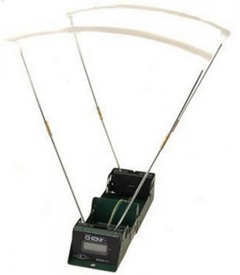

...just a thought...to be done obviously carefully - no wind day...try at 50 yards on bench rest. Use a chrono down range in front of your bulls eye, since you say the groupings are tight and you wont destroy your chrono - to obtain final FPS ; then if you are confident, extend the range to 100 yards and also get those readings... final terminal velocity before hitting the target with same pellets in either barrels...
PS: This is what you have ? >
https://www.rapidairweapons.com/xcart/product.php?productid=17756&cat=262&page=1
How Fast? 6 Best Shooting Chronographs 2017 [Really Fast!][/QUOTE]http://tacticalairsoftmagazine.com/best-shooting-chronograph/embed/
yes that is the gun i have. but with the lrt stock in forest green.
100 yards is no problem ding chroney work with this gun and will do when i have time.
