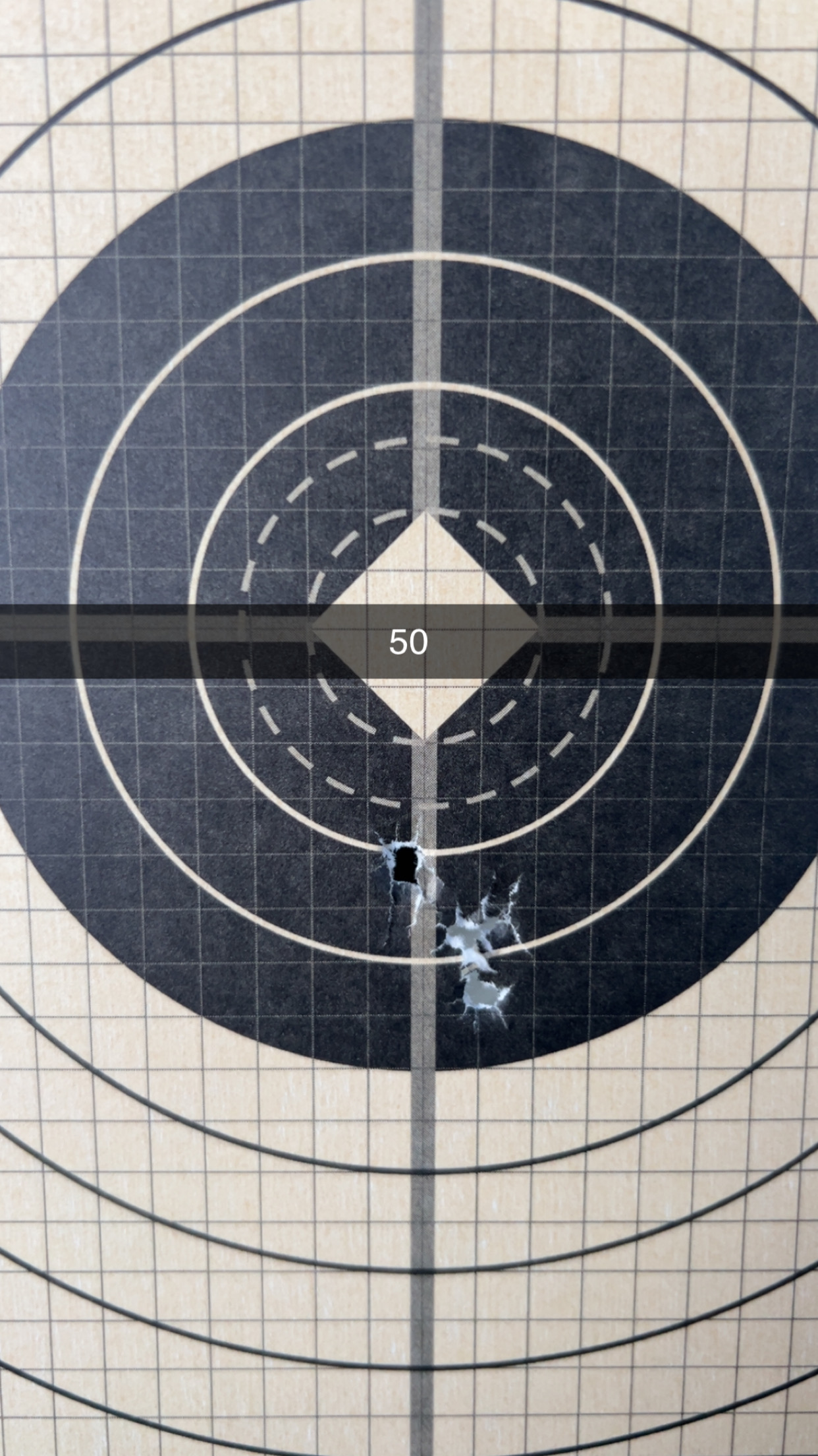

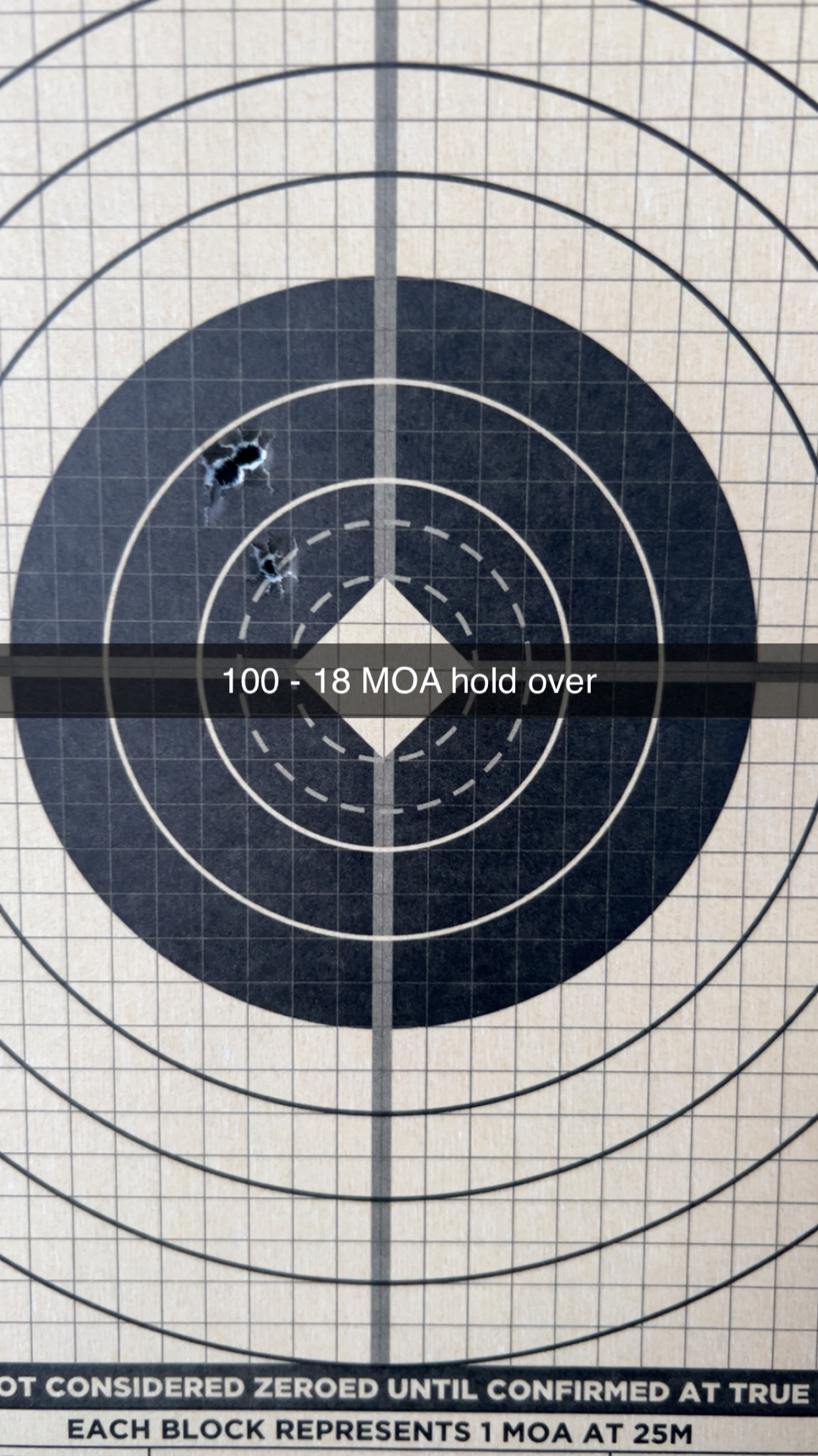

Update for anyone interested. I appreciate your feedback.
I made some wind flags and did some more shooting. I shot at 100 yards for the first time with the RAW. I was able to shoot a 5 shot group that measured 1.125” and several others around 1.5”. There was a small amount of air movement so it’s certainly possible that it’s a 1 MOA gun indoors clamped in a vice. I’m satisfied with that.
Today I mostly shot at 50 but my last 3 shots of the day I stretched it out to 100. 5/8” group!
Funny thing is it’s still shooting .75” - 1” at 50 yards under the same conditions. I wouldn’t have expected to see respectable groups at 100 based on that. I still got a lot to learn I guess.
The gun has been tuned at 100 yards for extreme accuracy. When you come to 50 yards, the tuning gets compromised or you would need to readjust the hammer spring a bit for extreme accuracy at 50.
It is very routine phenomenon.
