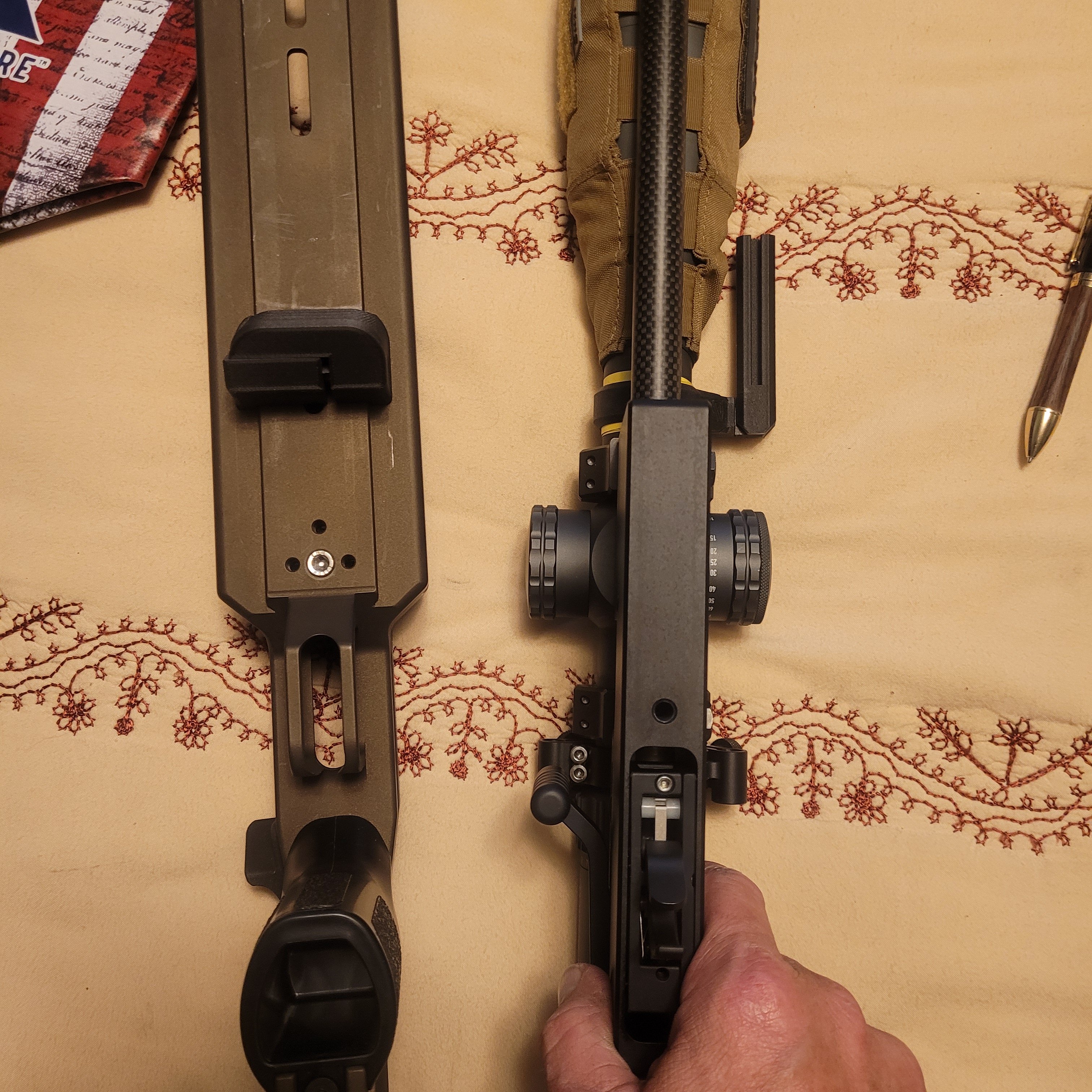

Does your rifle have that plug Emack?
Martin gets all his receivers from airforce, I know only because he is waiting on a shipment of .22 caliber actions. I do not have my .22 caliber action as I am waiting for him to get them. How were you shooting it without the plug ? You can order a bottom blanking plug from the airforce raw website. I just ordered some bottle o-rings. I just found out the bottom plug is 1/4" BSP THREADS not 1/4" BSPP Wich I thought they were. With the adapters I just ordered I will now put a regulator gauge on the bottom of my RAW and when my action comes I can put one on the MPA chassis because as you know the chassis already has a hole we're the blanking plug is wich is awesome.
There is no slot for a plug, just a solid bottom.
So I have nothing to plug my gauge into to measure the regulator.

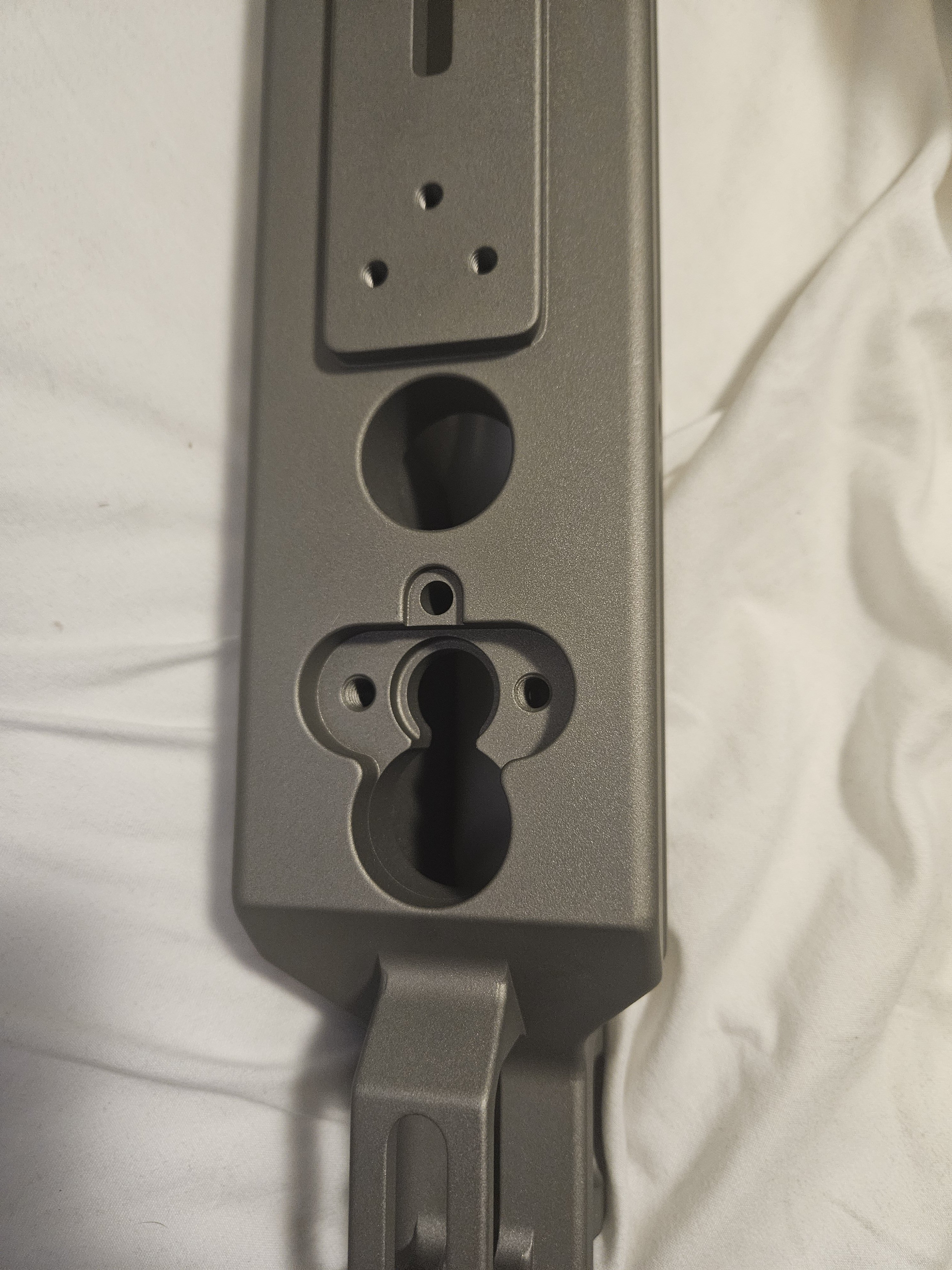

Oh man that sucks , I had no clue the new actions had no bottom blanking plug. I was looking forward to a drop down vertical external plenum on my MPA CHASSIS. Here is a picture of the bottom of my chassis, wich of all these holes does the single set screw hold the action in the chassis ? And why is there so many holes ?
  • Wow
Reactions: woogie_man
That's not what mine looks like! WTF is going on with these things?
Did you get the chassis for the HM100X or did you get the one for the Crown??
I ordered it for the Raw, I hope it's the right one.... I will have to try and out it 8n tomorrow morning, I will let you know. I think first part is for a baracade stop maybe?

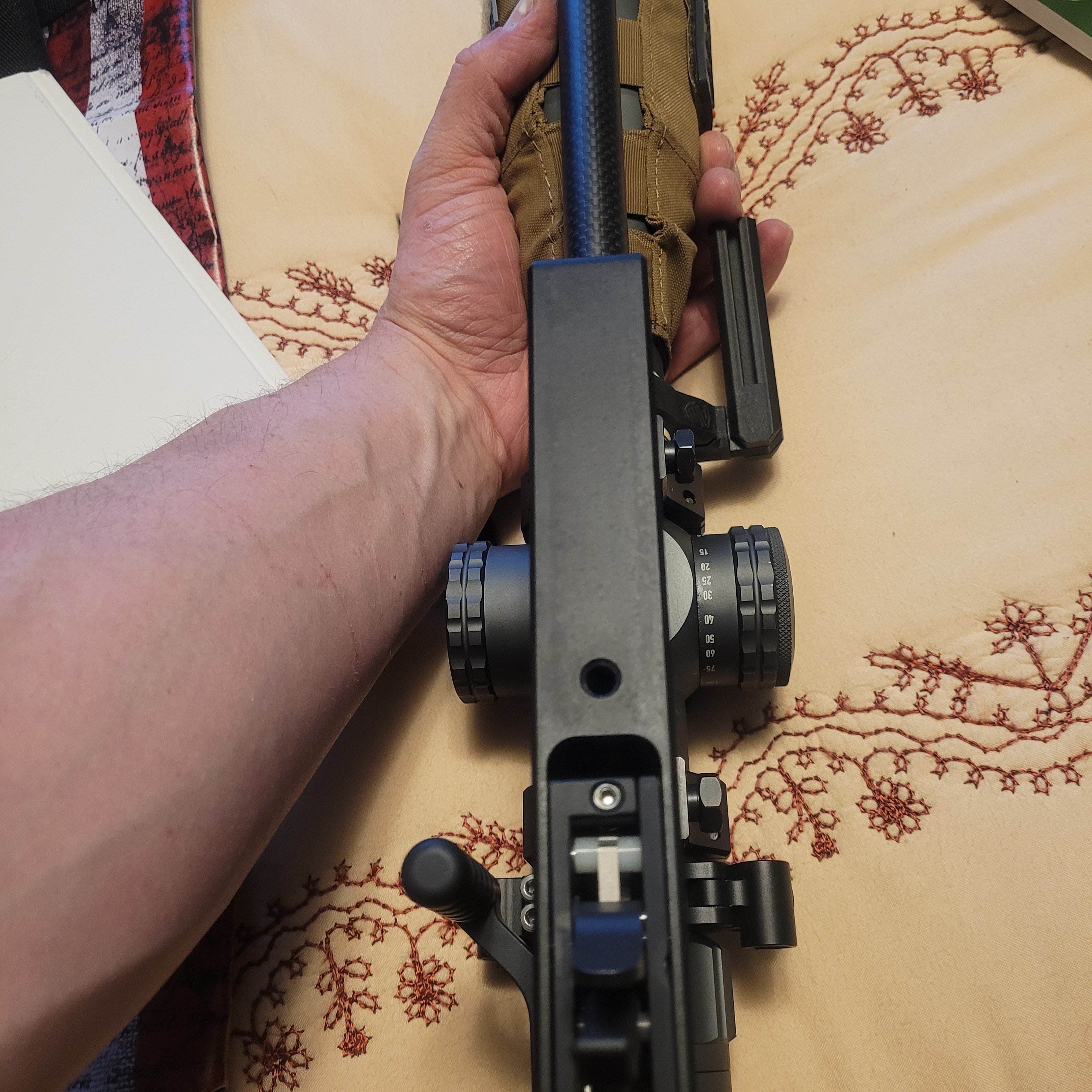

Ok I just got all my bits and parts....removed my rifle from its chassis.....AND NO BLANKING PLUG! DAMN IT!!!! Now I have to figure how to test my regulator set point!

Just talked to Martin. The newer models don't need the plug as ghetto machining abilities have improved, and they don't need a blanking plug.
So the the rifles won't have a plug
I’m guessing they just drilled it from the top. They got three grub screws, not reason one can’t be drilled through to the two chambers.
But it certainly would be interesting if they did anything inside that cavity. 5axis mill would allow angled hole.
