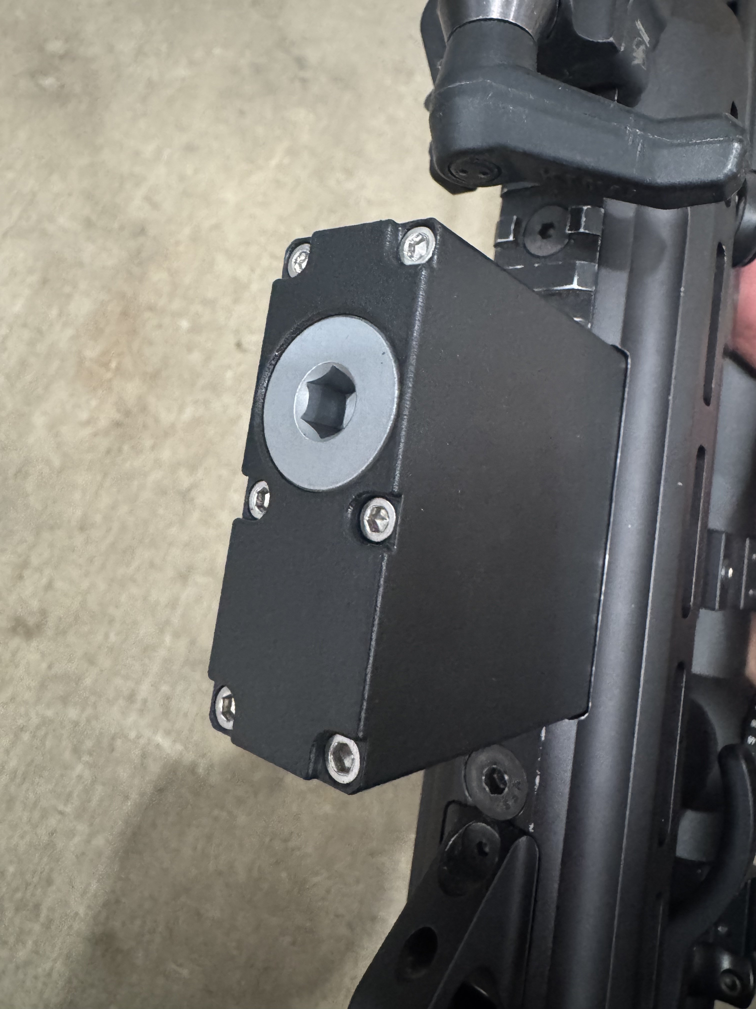

Some years ago a user on here made an external plenum for the raw action with a co2 cartridge. Ever since, I’ve been wanting to built a bolt on external plenum and finally got around to fabricating one.

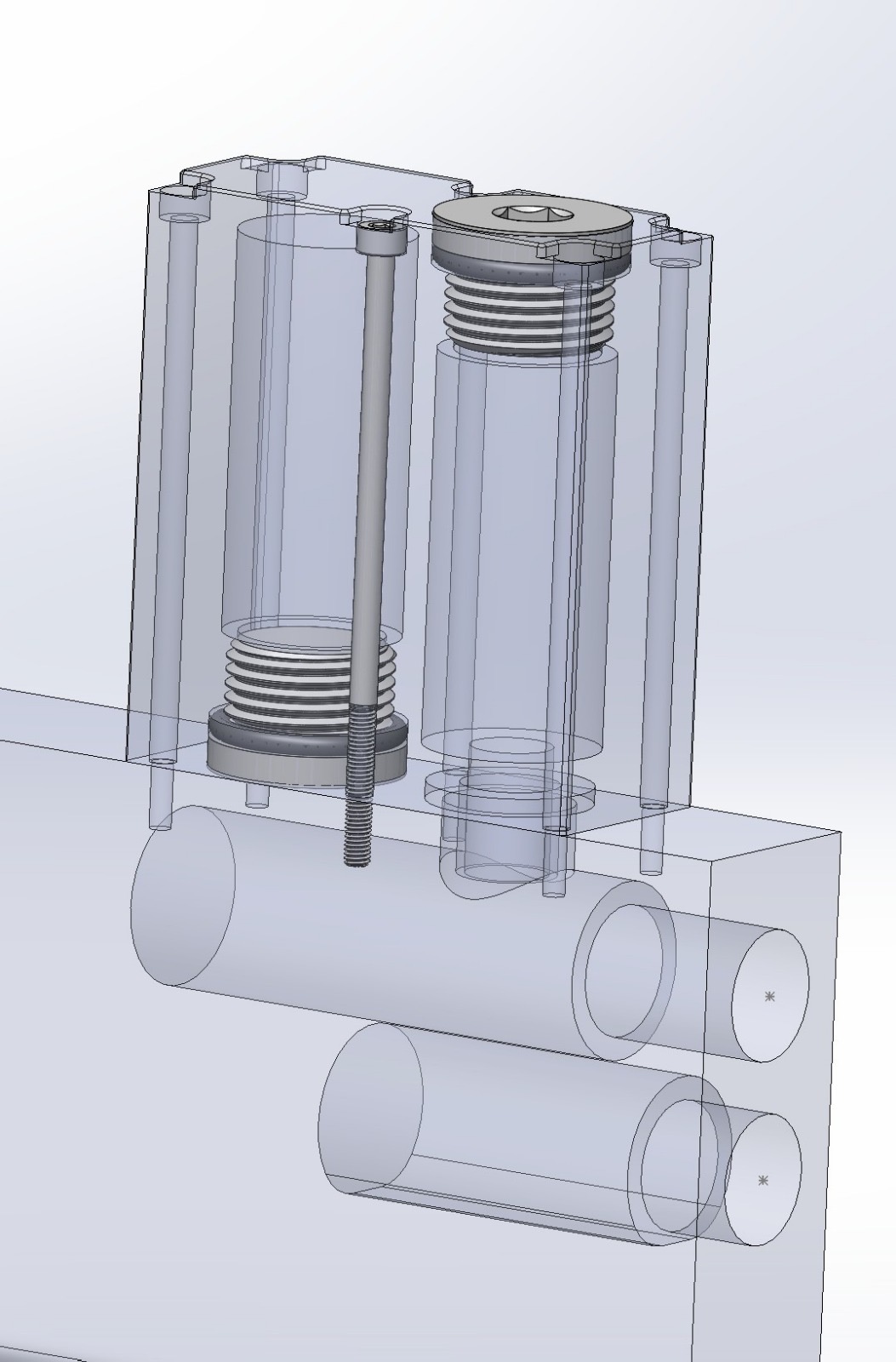

External plenum volume is 34cc
With an additional 33cc in the action. Giving me a total of 67cc.
Pretty pleased with how it turned out.
Rough calculation I seem to have gained around 16fpe

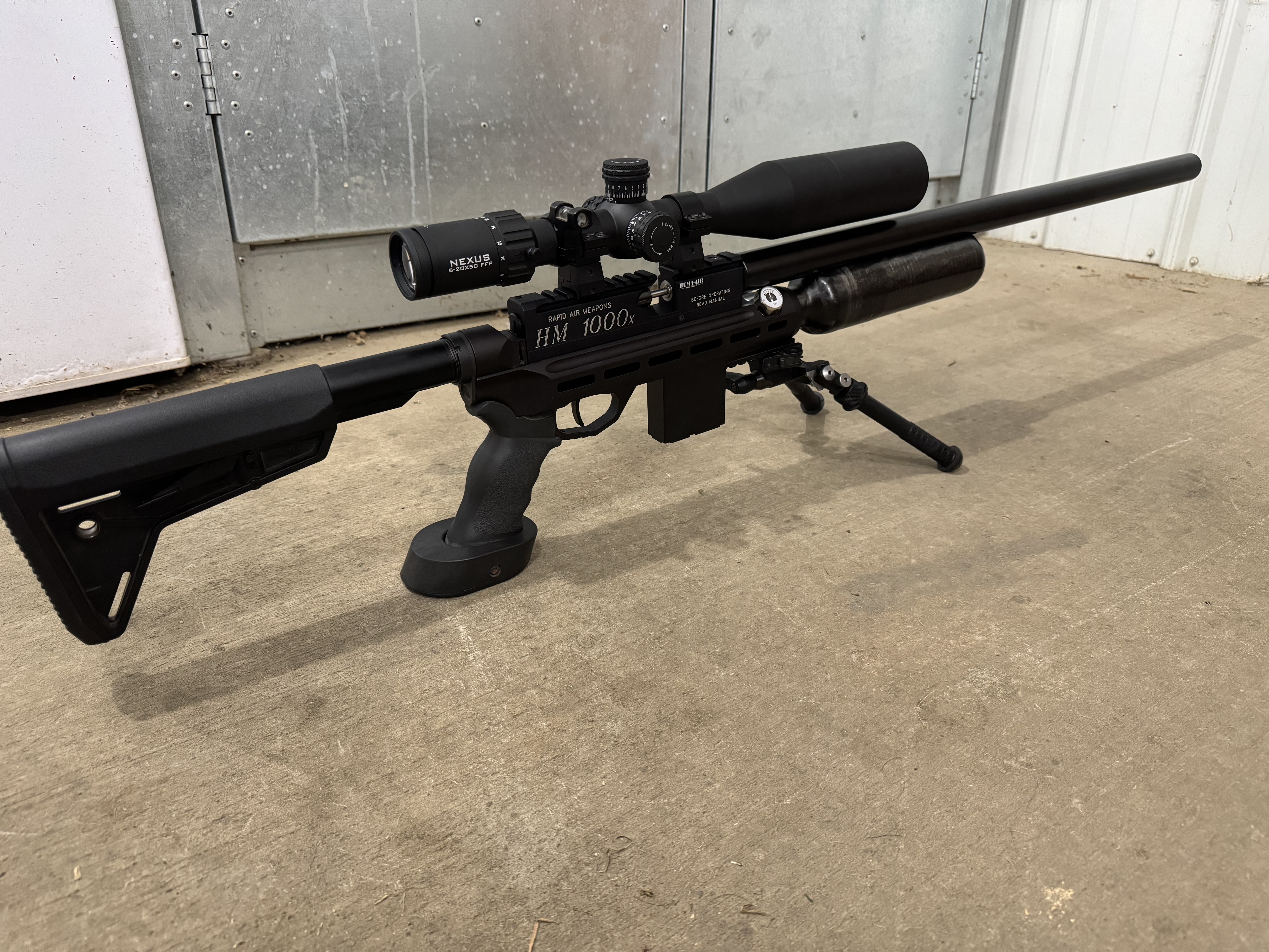

That's.....AWESOME! Looks fantastic too! Is that a AZ shroud!?
