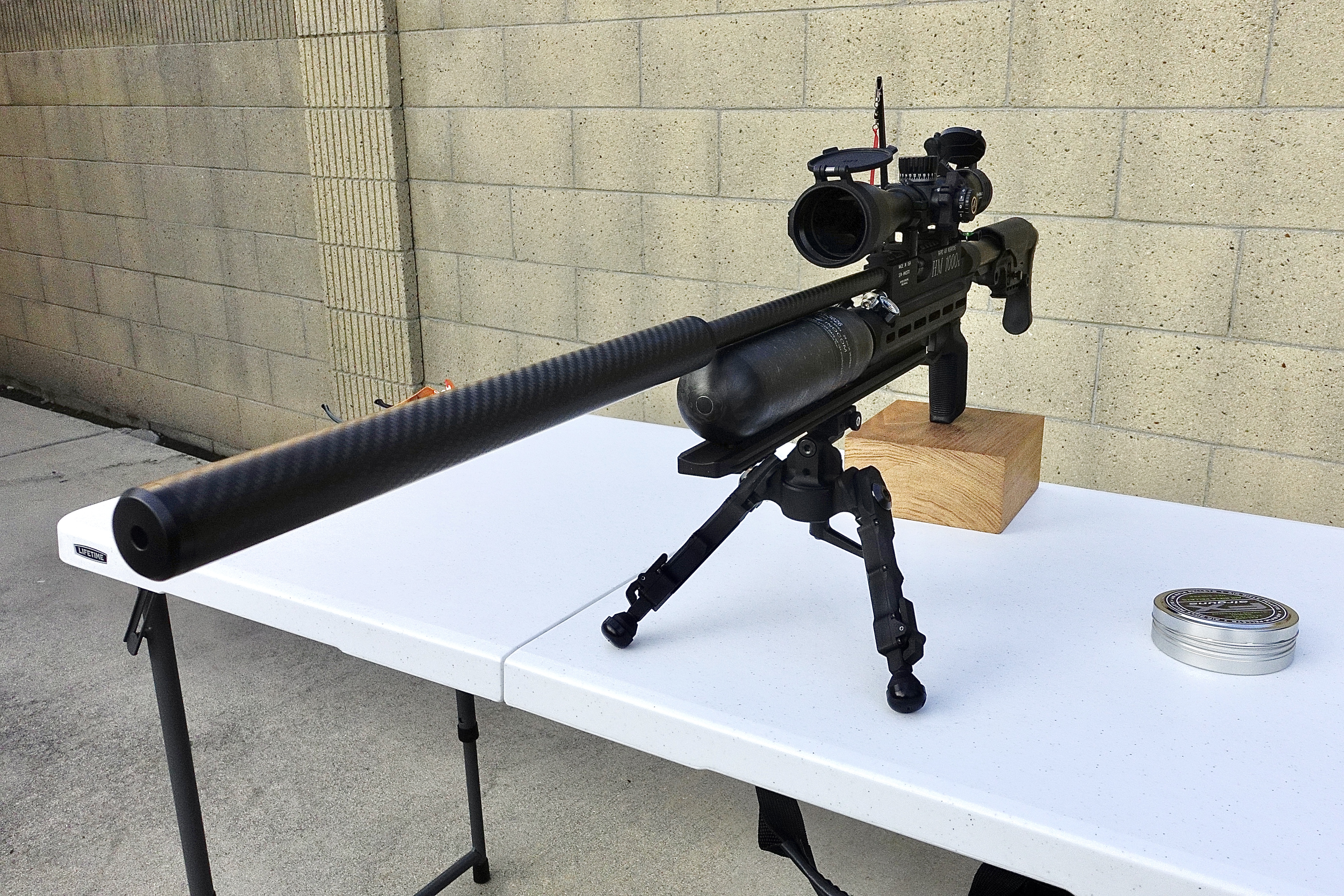

Would that moderator still fit if you have the whole barrel sleeved? I know it goes over part of the barrel and people like that so they can take off the stock moderator and not have to re-sleeve it. Mine is fully sleeved but I want one like that.View attachment 359298Very nice new Neil C's mods! My older HMx RAW has Martin's OEM conventional carbon fiber mod and looks similar to Neil's carbon fiber models and is back yard friendly on my .22.
I haven't taken mine off....I think mine is glued on. If you send yours to Martin, he can install a unf 1/2 20 adapter and shortened carbon fiber sleeve, then you can add any moderator of your choice, I almost did that with mine when I sent mine in for service, was also thinking of adding a 700cc bottle....Would that moderator still fit if you have the whole barrel sleeved? I know it goes over part of the barrel and people like that so they can take off the stock moderator and not have to re-sleeve it. Mine is fully sleeved but I want one like that.
Mine was glued on but it didn’t take much effort to remove it, you can buy 1/2” unf adapters and fi them yourself, just measure the od of the barrel and order the correct size.I haven't taken mine off....I think mine is glued on. If you send yours to Martin, he can install a unf 1/2 20 adapter and shortened carbon fiber sleeve, then you can add any moderator of your choice, I almost did that with mine when I sent mine in for service, was also thinking of adding a 700cc bottle....
