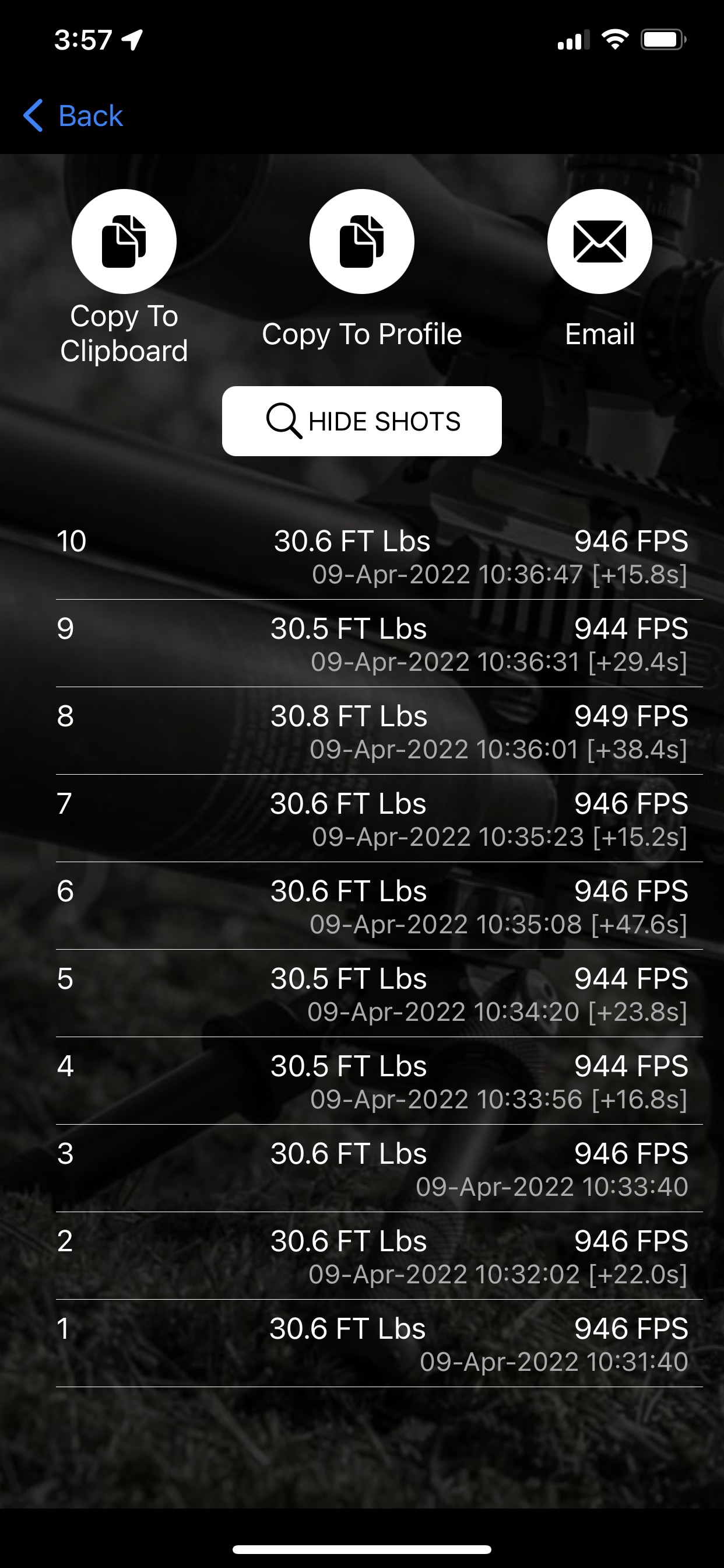

I agree that the issue is probably the typical crappy range of head sizes and weights nowadays with JSB. I don't recommend messing with Martin's usually expert tune. Mine was tuned for monster redesigns at 946. I sort my pellets so I get very tight spreads an single digit std. Also, it might need fairly frequent barrel cleaning with lead remover until it gets worn in.
