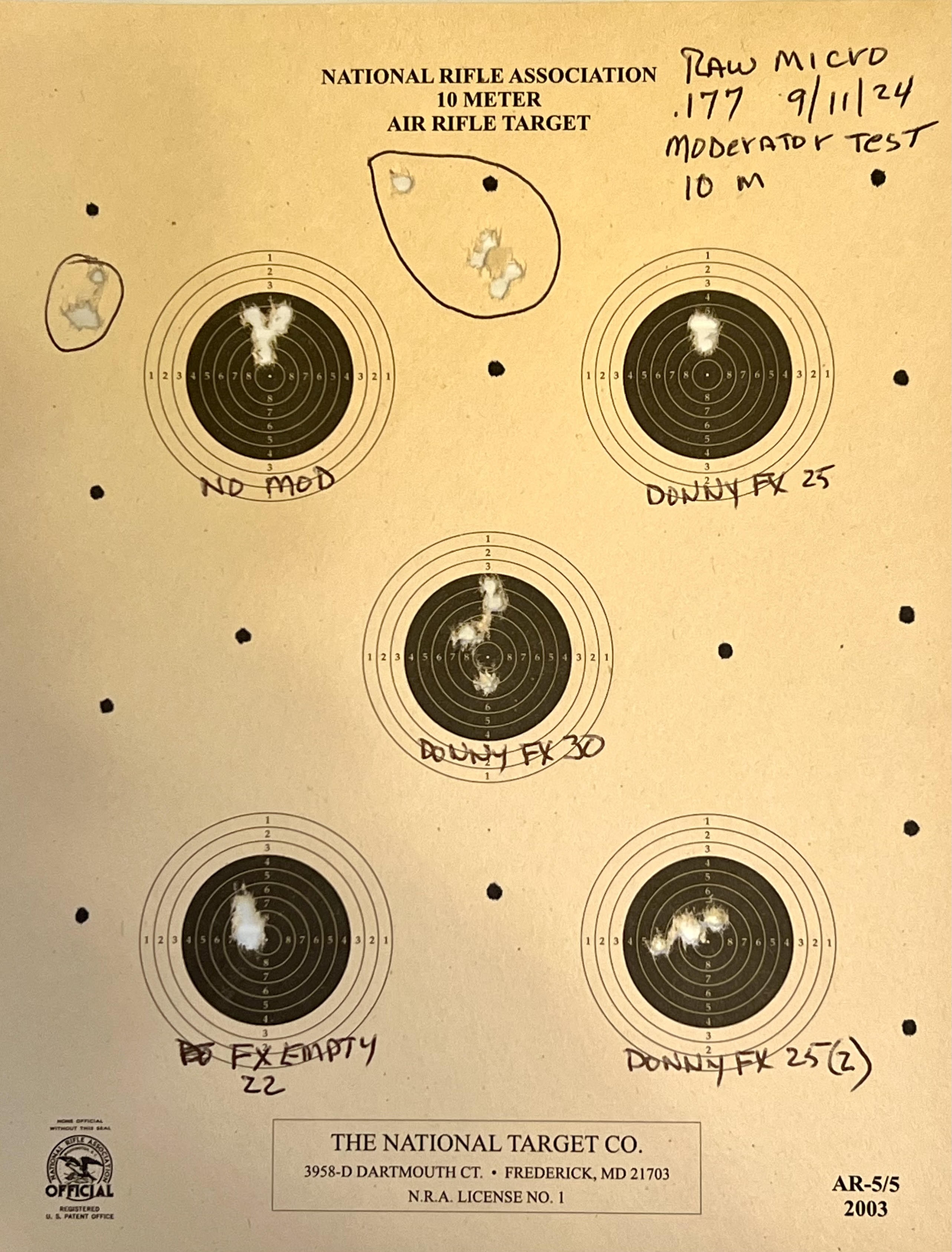

I've run hundreds of pellets over the chrono. JSB and AA 10.3, 8.4, 13.3. Ironically, I'm getting very consistent results with spreads of 11-12 and SD of 2 or 3. That's outstanding in my book, but why the accuracy problems? I've cleaned the barrel, polished it with JB paste and when I slugged it, the rifling marks look perfect. The crown appears fine. I've run it with no moderator, 4 others with different exit hole sizes, all the same. This is becoming a complete mystery. This is what I'm getting at 10M.
