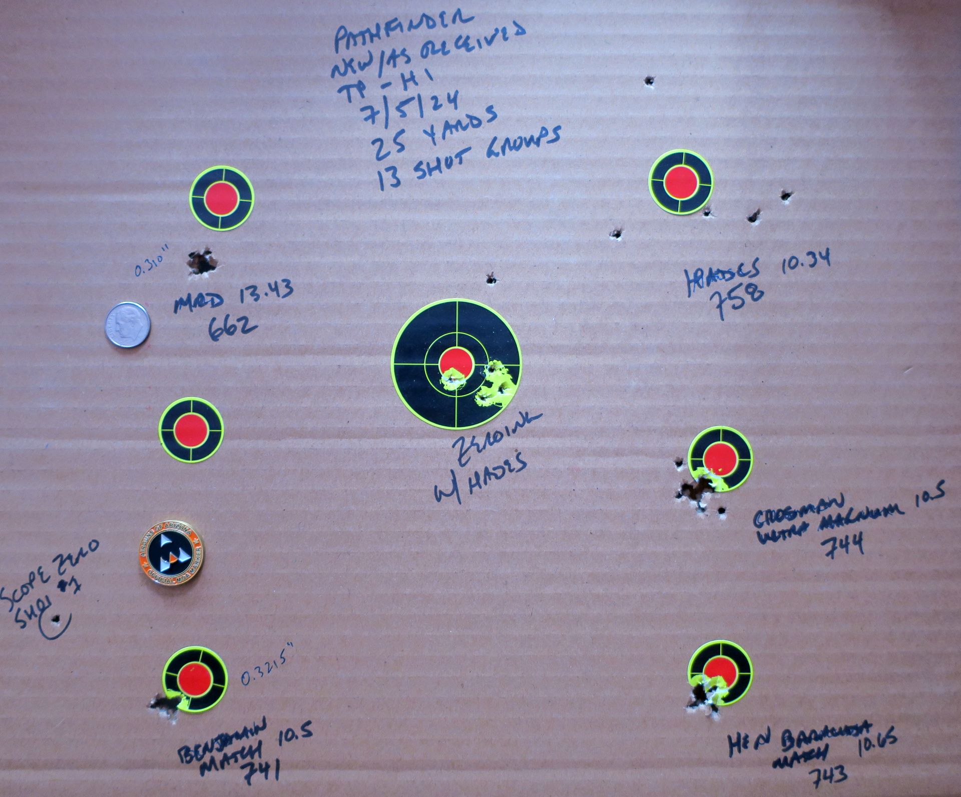

So far my Pathfinder (ctshooter's old gun) totally puts the Micro Hunter to shame in the accuracy department. Of course Sean put a lot of work into to that gun before he decided to sell it.
The only place where the Micro Hunter truly beats the Pathfinder (actually blows it out of the water) is that sublime trigger. So smooth, crisp and precise, and adjustable down as low (or even lower) as one would ever want in a hunting gun.
The Pathfinder definitely didn't like Hades pellets, but give it Monster Re-Designs, Benjamin 10.5's or Baracuda Match 10.65's and it is real happy. And it shot Crosman Ultra Magnum 10.5's pretty much like the best groups I can get out of my Micro Hunter (i.e.: Not real good).

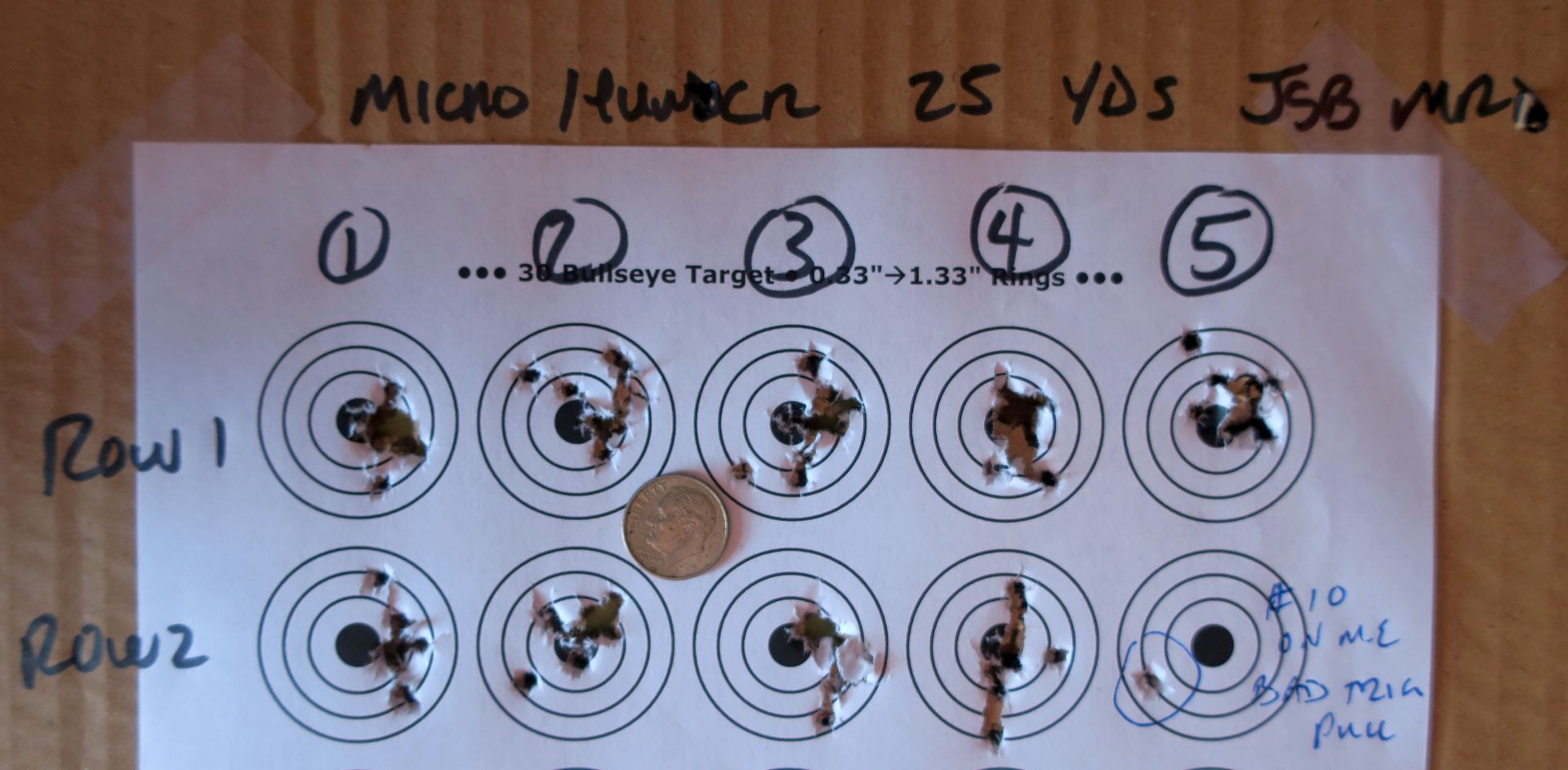

Here are the most recent groups which I am having reviewed by RAW. All are Monster Re-Design 13.43's at 25 yards, no wind but heavy air (on the order of 60 F and 90% RH). Pellet velocity was almost 720 fps (as recommended by RAW). Different groups are testing different air stripper settings. Some groups have the same AS setting, if the first group shot showed promise. Gun always refilled as it approached 150 bar on the gauge. Shot off Caldwell stable table, Accu-Tac bipod and rear bean bag. All groups are 10 shots.
I am comparing these groups and considering them sub-par based on other .177 cal guns (including the Pathfinder), and RAW's specification that the Micro Hunter produces "10 meter accuracy in a compact hunting rifle". Many of the group sizes might be acceptable to to me - if not for the flyers!
Note one bad trigger pull I called on myself in the last group - trigger is so light it broke before I was fully ready.

When you refer to RAW, do you mean Martin, or the Texas folks. Assuming favorable variables, those are terrible groups for a RAW at 25 yards. I just shot my .22 HM1000 in the yard at 25 yards. Sitting on my deck step and using only my knees and a shooting stick, my groups were one-hole, which is typical for me and that rifle at that distance.

My groups are a lot better than that. I don’t have any targets laying around that I have shot woth the Micro. I would say nickel sized groups at 30 yards with JSB 8.44 or H&N FTT. Before it was turned down to 12fpe it did the same with JSB/AA 10.3 and almost as good with Crosman Premier Heavies. Norma 8.4 & 9.1 (I think the are 9.1) shot a bigger group, about the size of a quarter until I stuck the RYU moderator on it and the Norma’s went crazy. All the groups I am talking about are 1 magazine worth of shooting. Maybe not a full magazine everyrime as once you have a ragged hole you tend to start another. I have not done a proper job of phoning in on making the rifle more accurate (pellet testing, air stripper adjustment, etc). That’s my project for the spring. I really like the rifle. It’s a 5lb rifle. I don’t expect it to be a full blown match rifle as that was not what it is designed for though It does share a lot of the RAW pedigree.
I am editing this as it occurred to me my shooting has not been off the bench. I shoot in the seated FT position like I would in a FT match. I could probably do better off a bench.
