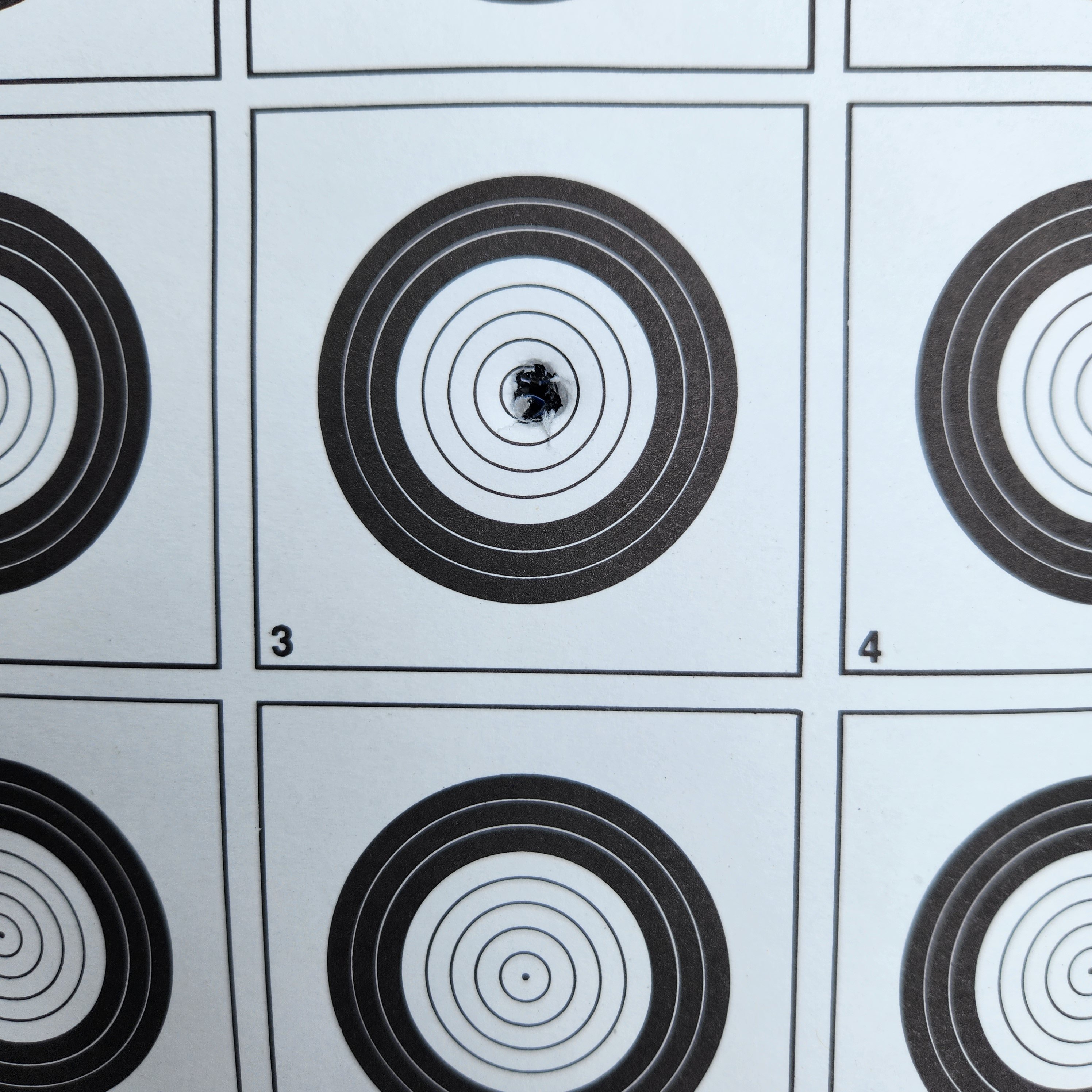

This is a group at 25 yards, shooting seated with a shooting stick. A well tuned RAW with a good barrel should do this, not every time, but consistently.
What is acceptable accuracy at 25-30 yards with a compact .177 ? Your own preference anyways.
Sorry for the derail but guys were comparing w the Pathfinders accuracy so just another compact .177.

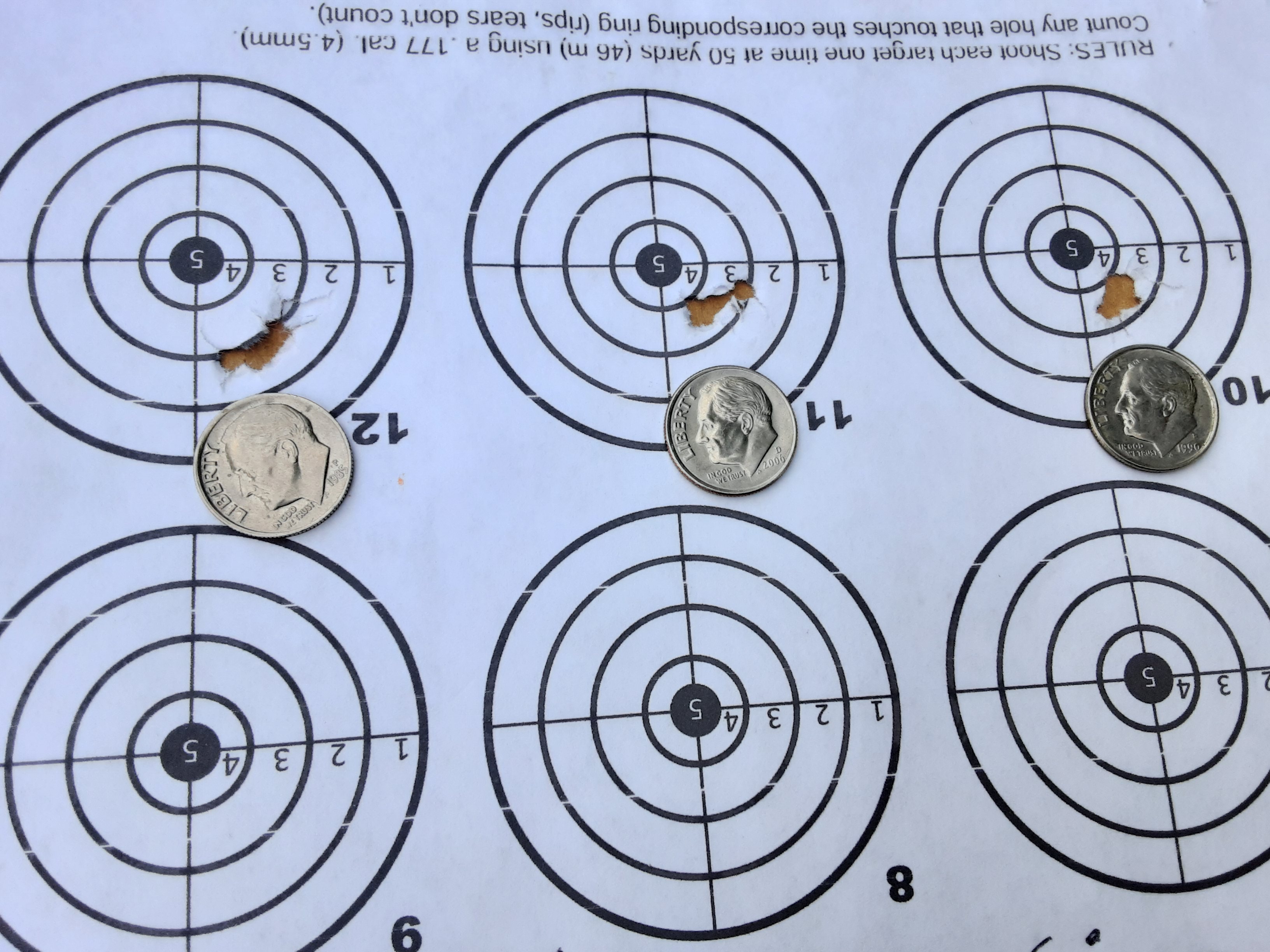

Have you tried the JTS 10.4s ? I just shot some groups and they are much better than the JBS 10.3s that's shown in the target I posted . 3 , 5 shot groups . 2 are quarter inch and one is an eighth inch . Best I've shot w a .177 at 30y . Now I can try the 50y challenge when my compressor shows up . JTS did it again , now in .177 amazing stuff . I didn't adjust the scope from the JBS pellets zero.
Hope you get yours shooting better . I know the frustration

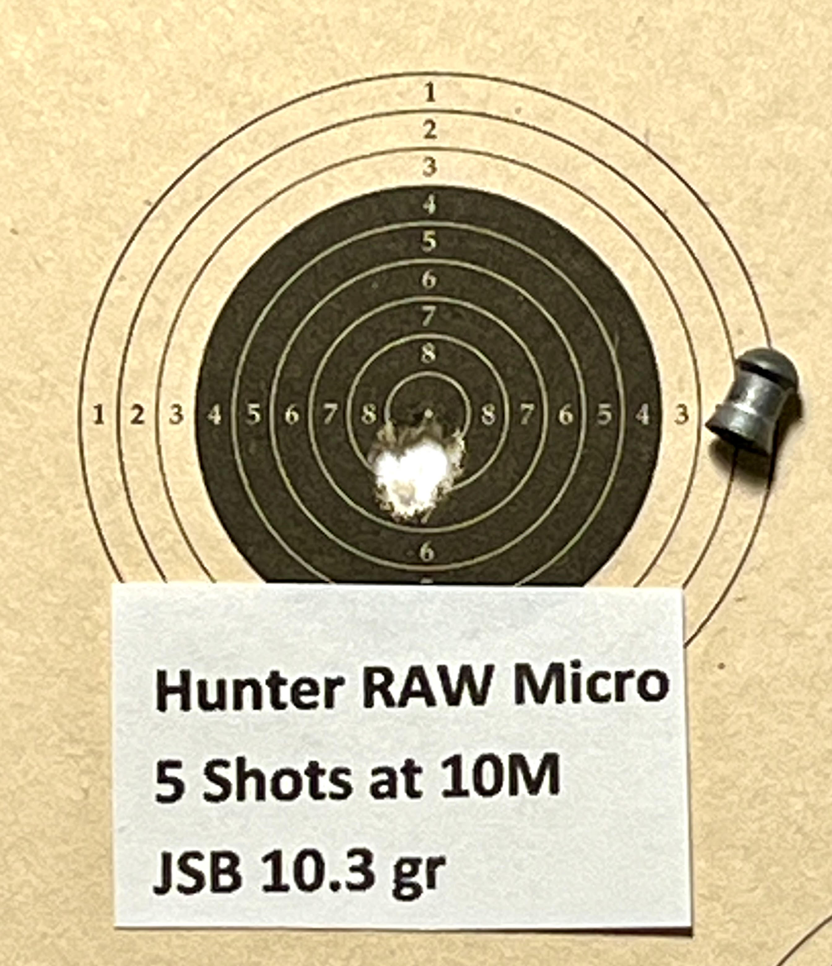

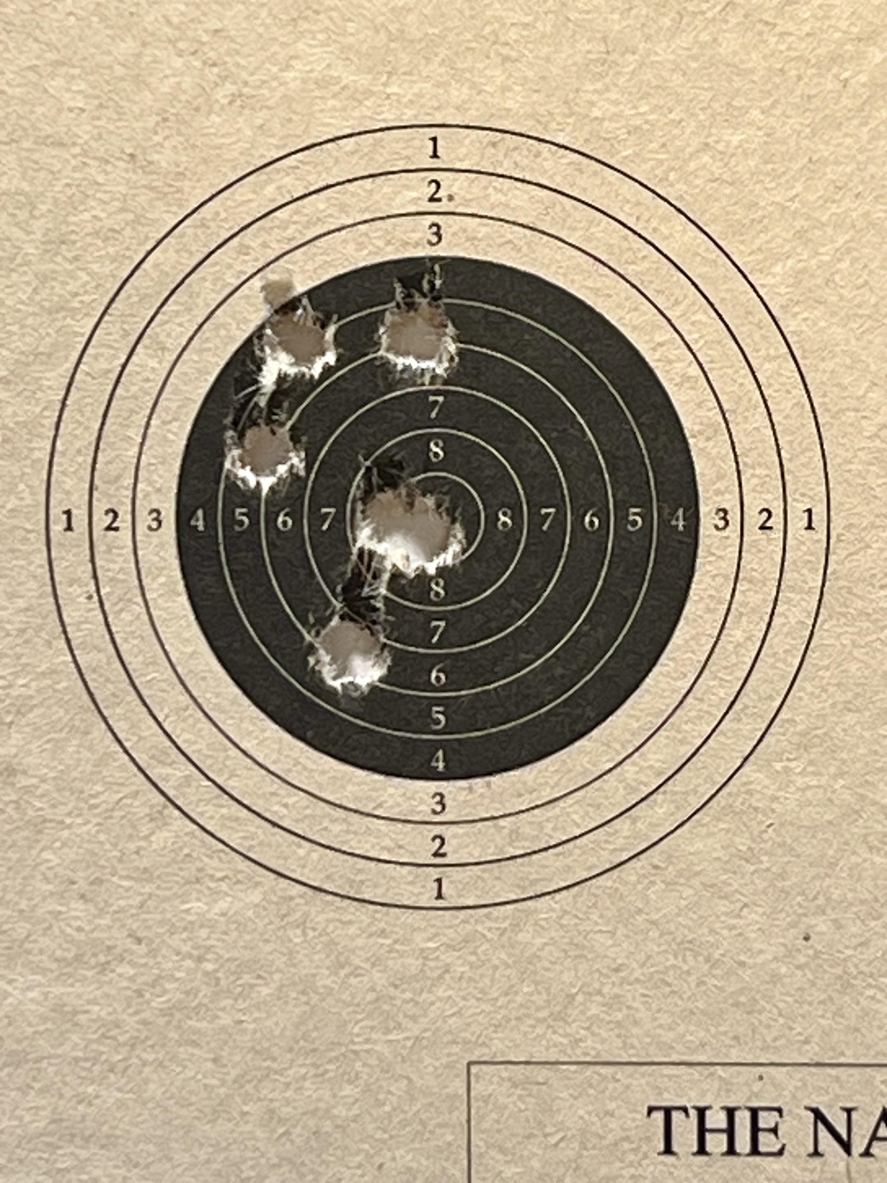

I sent my RAW Micro Hunter back to Air Force for warranty service because of poor accuracy (see my other posts). I was shooting 8.4 gr pellets consistently but just over 800 fps. I received the gun back from them. They replaced the barrel and rebuilt the regulator. It now shoots 8.4 gr pellets at 887 fps or just around 15 fpe. Accuracy is now exemplary as all of my other RAW rifles were. I initially tested it at 10M indoors and it now shoots one hole 5 shot groups. I'm going to test it at 25 yards later today. I suspect the reg was the culprit but am surprised this one got out the door. BTW, Martin no longer has any significant association with Air Force.
As received. After repair.
Happy to see the outcome jps2486. My Micro Hunter is currently back at RAW, and I am hoping mine gets taken care of like yours!
