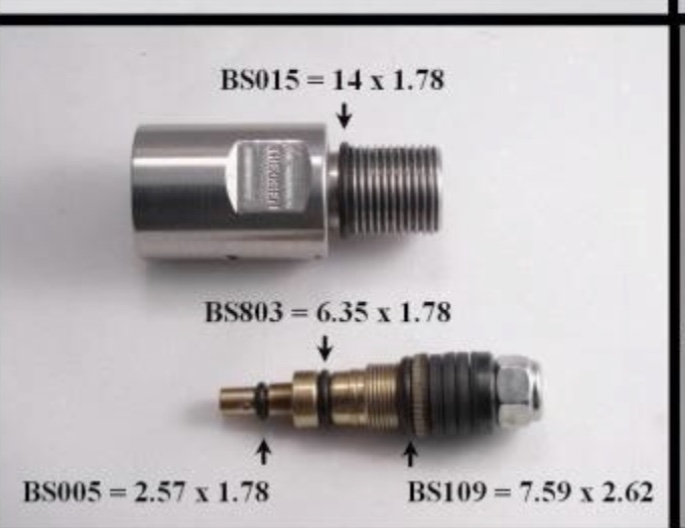

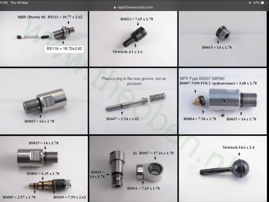

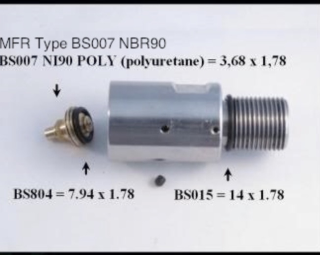

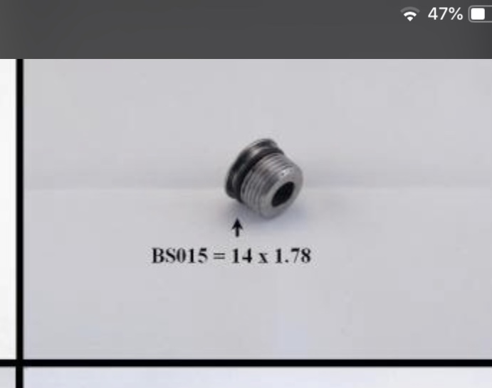

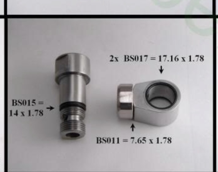

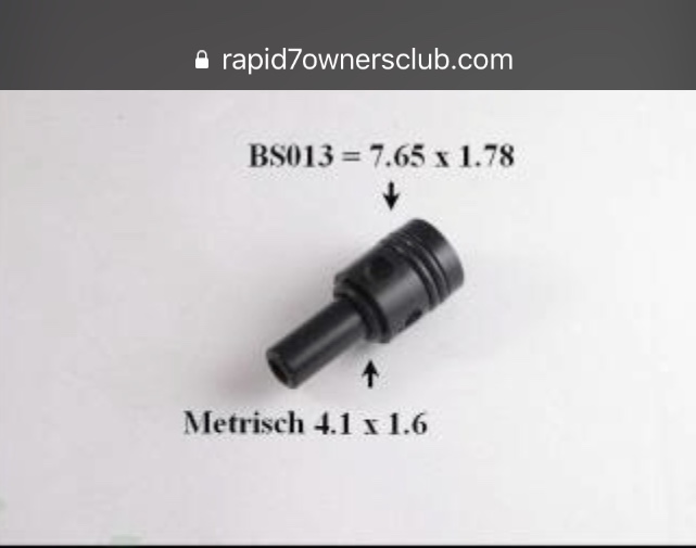

Here is some info i copied for the TM 1000 regulator and valve + some others
changed most of the orings out and all is looking good. Reg is still shooting where it should and nothing appears to be leaking with leak detector fluid.
Have it aired up sitting for a week or so to make sure. Still have one to figure out and one to locate.
The BS607 looks like it would have to come from over sea's, but don't know if the valve steam oring is ever a issue.
The one listed as "Regulator core to body" is the oring in the reg by the knurled area. I will post pics later.
T = Theoben Drawing
M = measured O'ring
Not a RAW but a rapid, most of the parts are the same
1577611452_13097841545e0870bc682e68.14215241_EDA0787D-41B1-4CEA-928F-773075B6138A.jpeg
if you have problems getting these sizes in the US, let me know
