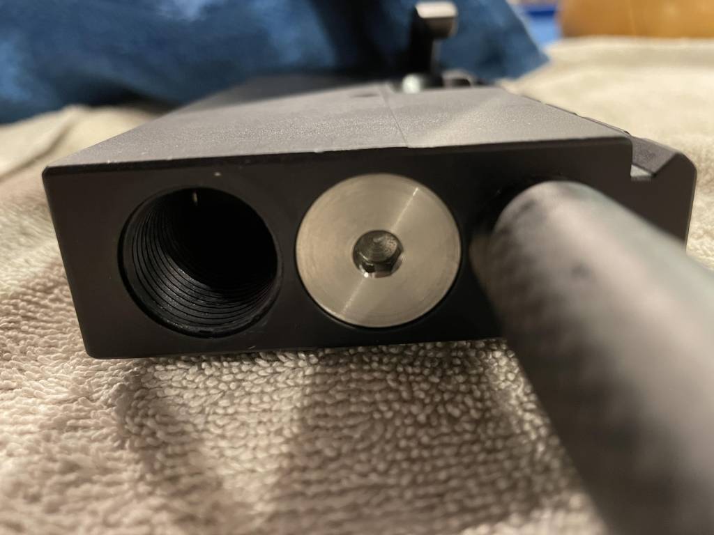

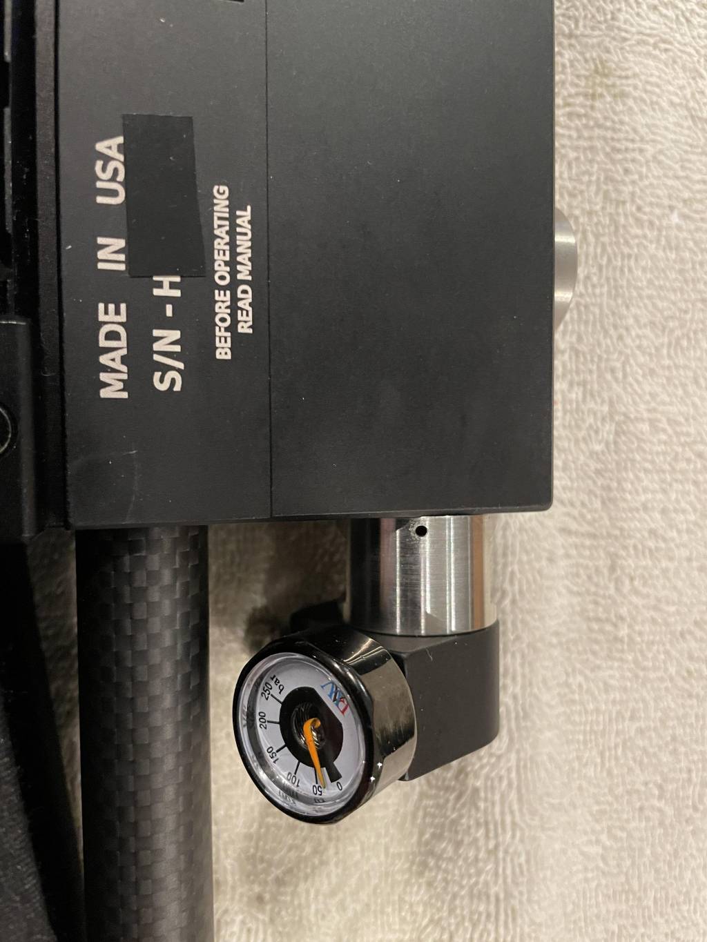

Why am I getting a small slow leak of air at this vent for a second after a shot then stops, then again after every shot? Is it bottle side or Reg. Side?
Hmmm, possibly you may have messed up the seat of the piston.
Do you have a reg tester? Does the reg seem to function? And hold/regulate air?
Seat damage ( If present ? ) has NOTHING to do with air leaving the vent hole.
ONLY pressure getting past the HP or LP side of spool O-rings gains access to the vent. ( All Air Gun Regulators )
Yeah…that’s true.
Damaged seat would have different symptoms. Thats why I’m wondering if it’s regulating properly

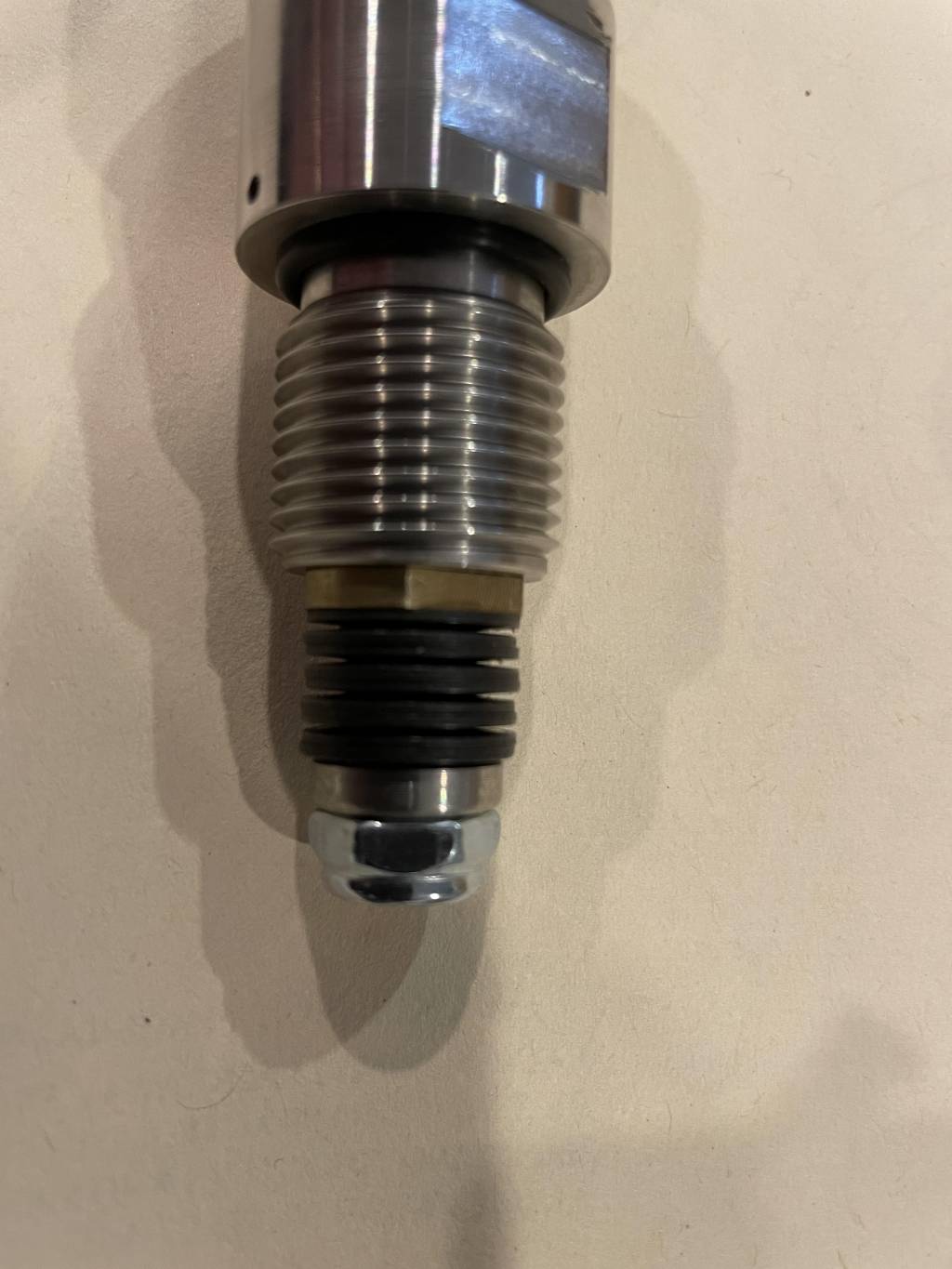

New style reg ... easy peezy "Spool" o-ring servicing !!! Unscrew at the brass collar w/ flats and 2 o-rings are right there !
Screw back together with no set point change ... Nice !
While pressurized ... Spritz a bit of WD-40 at the caps and around all joints etc ,,, bubbles will happen at leak.
You have these areas that may need fresh o-rings too ?
Fill foster X2
Fill Y manifold X2
Bottom blanking plug X1
Bottle and Attachment manifold X2
Valve seat to receiver X 1 or 2 ?
Likely the poppet / valve seat is NOT a problem being there very reliable as designed.
I have used the O-rings supplied for these replacements, will try again with your leak detection method. Also will source more O-rings and make sure I used the correct ones for each replacement. (Some are obvious)
One more note, you are 100% correct on not having to disassemble valve stack but I didn’t have a thin enough spanner wrench so I did disassemble the valve stack, I took measurements and pics to get reg. Back very close to factory specs. Will find out for sure though when I do velocity checks.
