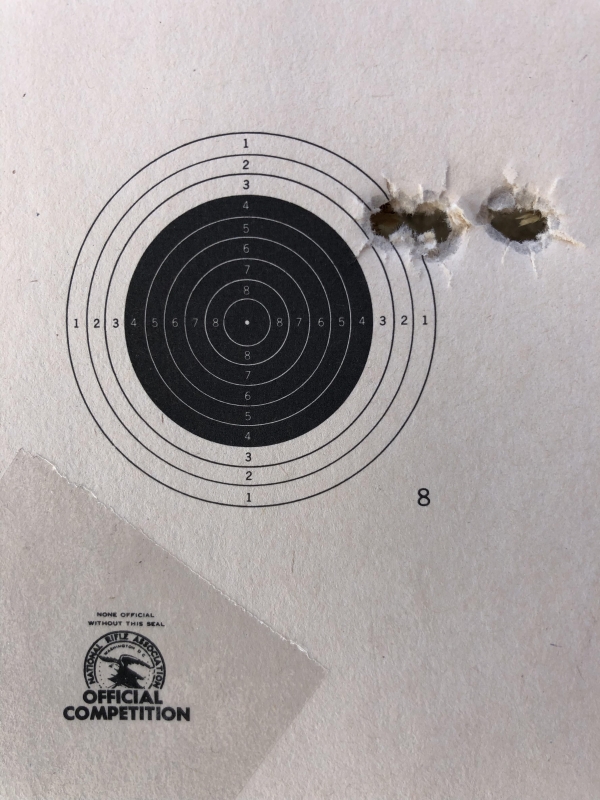

Could only manage about 5/8” ctc group (5 shot) in the 5 deg F temps today. Obviously a lateral wind was present (8 mph), and I wasn’t trying to compensate for it-just shooting the same point. Edit: group was at 50 yards. Fingers were FROZEN to the point that I had to stop because I couldn't load pellets any longer...

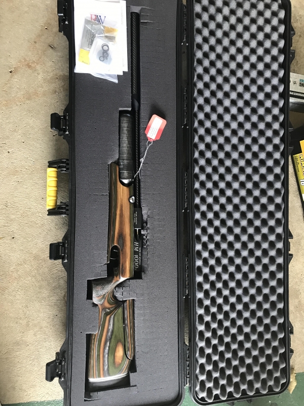

"PCP507"Today I received my RAW. Abosolutelly disappointed. I have a great White, and could not fill the gun. at around 100 Bar the air was coming back on the foster fitting.
Have any of you had any issues filling your RAW for 0 to 230 Bar? I don't know what to make of this
No, I haven’t had that problem. I’m assuming you checked to make sure the foster fitting is fully seated onto the valve on the gun? From there, make sure the other side of the fitting isn’t leaking (hose side). If that’s not it, call Joe B and confirm you have the correct fitting on the hose-or see what he suggests.
The gun-each gun-goes through a leak test at pressure prior to leaving Martin’s facility, so I doubt the gun can’t take a fill above 100 bar. Nevertheless, if you can’t sort it out, call or email Martin-he replies ASAP so you should not have to wait long to find out what’s happening.
I could finally fill my RAW. Apparently you cannot fill a RAW from 0 to 230 with a great white because of the slow fill of the tank, so you have two options. The first being getting the gun with some air in it, and the second one, being filling the gun from 0 to like 150 Bar with an Air Hog and once you get the air tank to take the air you can use whichever tank you like.
It's just a heads up if it ever happens to any of you guys. Here are some pictures
