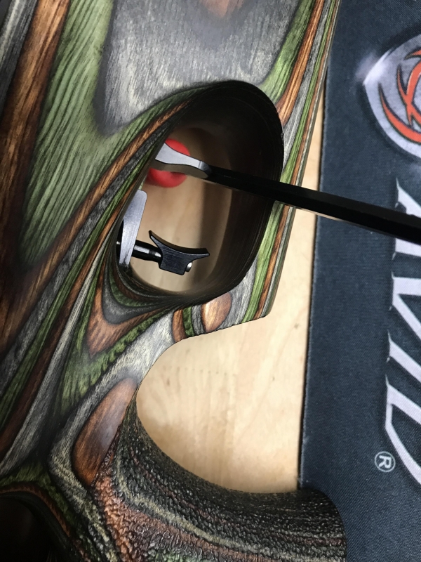

"Salticon"i can't keep them in stock! lol, The Rowan Trigger is nice because you can move the shoe fowards and aft, for those smaller handed shooters, also the shoe rotates outward for better finger contour. Ive found that the stock needs to be slightly shaved on the back part of the trigger drop hole for clearance on all non BR stocks. Very noninvasive and not visible when done. I used a rat tail file or a rotary tool. Tomorrow i'll be installing one in a .357 i'll post pics.
I would definitely like to see a pic of that.
Well i installed the Rowan trigger in Jim’s .357 with a sporter stock and it didnt need any modifications to stock. Learning all the time when your doing something new with these RAWs.

I like that and it’s definitely something to think about. Hard to tell but is there any side to side on that trigger or is it just up/down forward/back adjustments?
"Imold"
"Salticon"Well i installed the Rowan trigger in Jim’s .357 with a sporter stock and it didnt need any modifications to stock. Learning all the time when your doing something new with these RAWs.
With the current shoe shown on the blade, the unit can only rotate about the shaft it’s connected to. The shaft itself only slides fore-aft, and does not rotate. So the trigger blade can move fore-aft, and the shoe can rotate about its post-but cannot adjust laterally.
hope that description is clean? I’m send my unit to Ken today for him to compare it to other units he has.

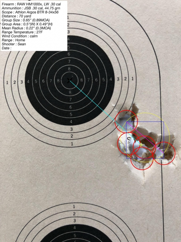

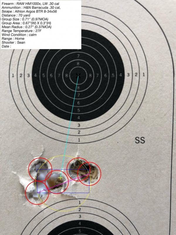

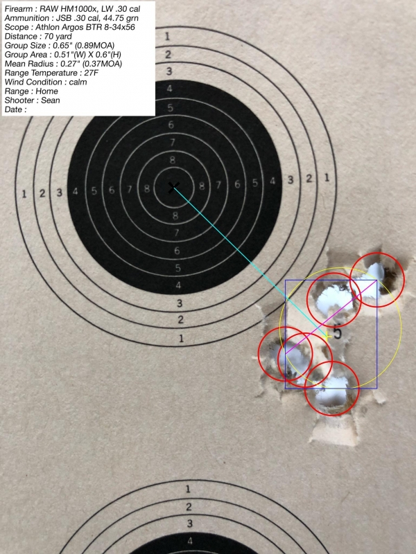

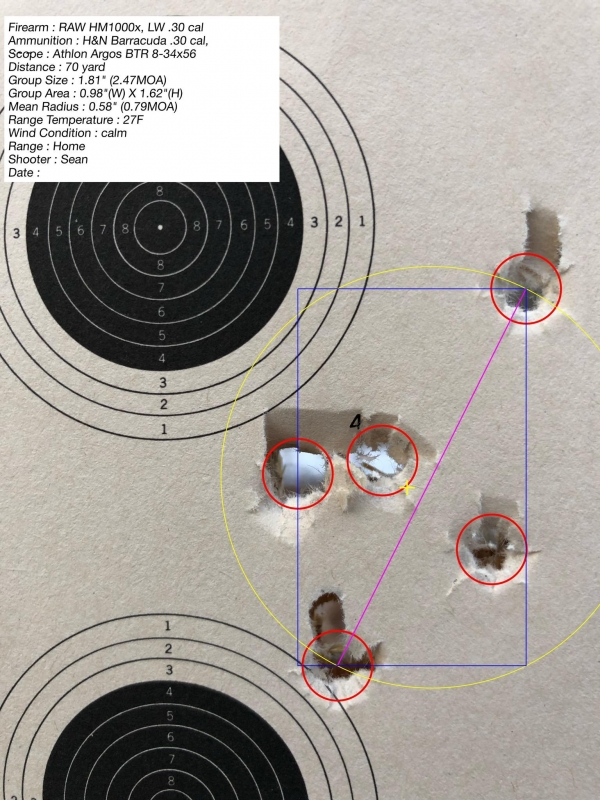

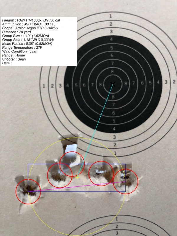

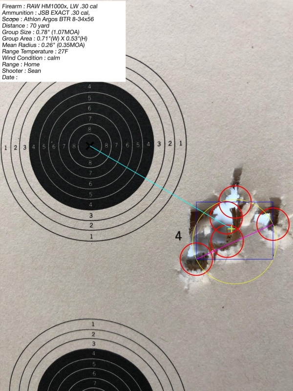

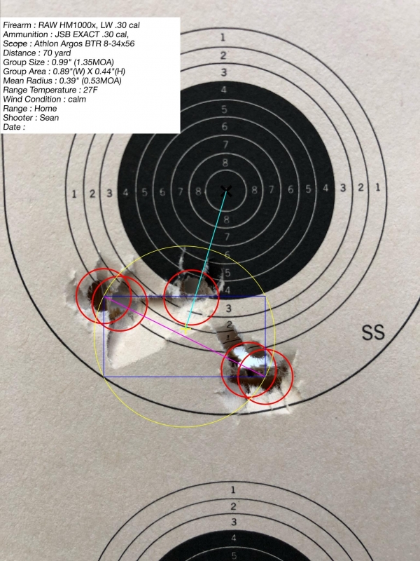

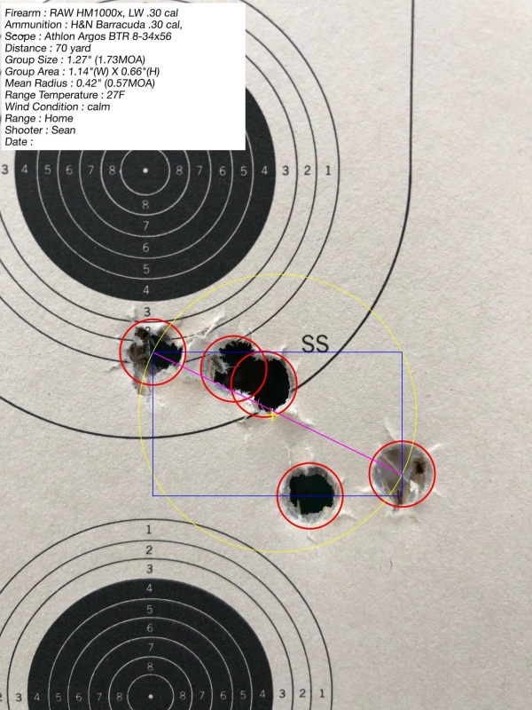

Yep, I was just posting about it in the thread on the pellets forum. Here’s a duplicate post, with details. One more note: the way these big .30 cal pellets seem to tear through the paper makes it difficult to measure some of the shots, due to difficulty determining where the center of the pellet is.
I had a chance to shoot them today (50 & 70 yards), from my RAW .30 cal. Short story: they’re not too bad, but the JSB 44.75 grains do seem to shoot a bit tighter. At 50 yards, my best 5 shot group was 0.56”, and my best 5 shot group at 70 yards was 0.71”. By comparison, my best JSB groups were about 0.45” at 50 yards, and 0.65” at 70 yards. The difference comes in that the average group size of the H&N pellets is 1.263” (ctc) (largest of 1.81”) at 70 yards, vs .852” ctc (largest of 1.19”). Note: the largest groups for both pellets were shot when I was getting very tired, and very cold-I blame those on me, so don’t draw too many grand conclusions off those numbers for either pellet, or the gun. After sitting out in the cold for 1.5 hours, you will understand...
I don’t know the velocity I was shooting either pellet at, but I think i am around 865 fps for the JSB.
H&N:
JSB:
I don’t have BC information yet either, but will gather that in the next few days.
I hope this info is helpful to you guys?
