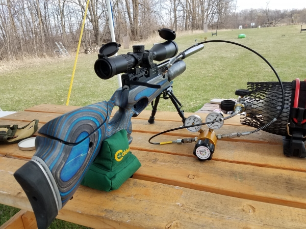

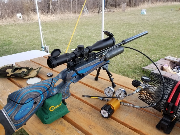

Anyway as you know I like my pics so here are a couple from today and yes I did scratch my stock on the side back by the butt and yes I just about shed a tear but I held it back.

I have my RegMan regulator set at about 225 bar or 3250 for both my HMx’s and Wildcat which are all 230 bar rifles and I find it perfect so far, I keep it like this just Incase one of the regulators is off and with that said today when I hooked up my Wildcat my 1st shot was a ringer and same after that, with my 30 it only took 2 shots to get it in the bullseye and with the 357 it took more then it should of but I think the Emerald might have a issue but I’m going to see it those turrets work themselves a bit looser and now with that said I have also read that the 1st shot after fill can be off due to the regulator but so far I’ve been lucky I guess.
When I tether one of my rifles I slowly turn the main air supply on then with my RegMag closed I open my intake side to 4500 psi then let it sit for a minute or so then I opened my outlet slowly until I get to my set pressure of 225bar or ruffly 3250 psi and I also kept a eye on my rifles gauge to make sure the outlet gauge matched the rifle gauge, now when I stop shooting I just turn my main tank off and bleed the line and disconnect this also keeps the rifle full of air and the RegMan set for next time then all I need to do when I hook up is just turn the main tank valve on slowly and make sure the pressure is the same and I’m good to go with the same pressure I was using before.
I do have to say that tethering is new to me and I will be testing other pressures down to 200 bar just to see if it makes any difference but I have a feeling that since 3 of my rifles are shooting just fine at 225 I might leave well enough alone BUT I do have some suspicions with the 357 in that it might shoot a bit better at 220bar so I will be investigating that one a bit more but like I’ve said so far I’m happy being tethered the way I am now.
I should add that it is nice when I can just glance up at my RegMan gauge and see where my tank pressure is without having to look at the small gauge on the tank valve, gives me a good look at when my outlet pressure will start falling off. I should keep notes on this so I’ll know at what pressures the different calibers will start being affected and shot count for each caliber.

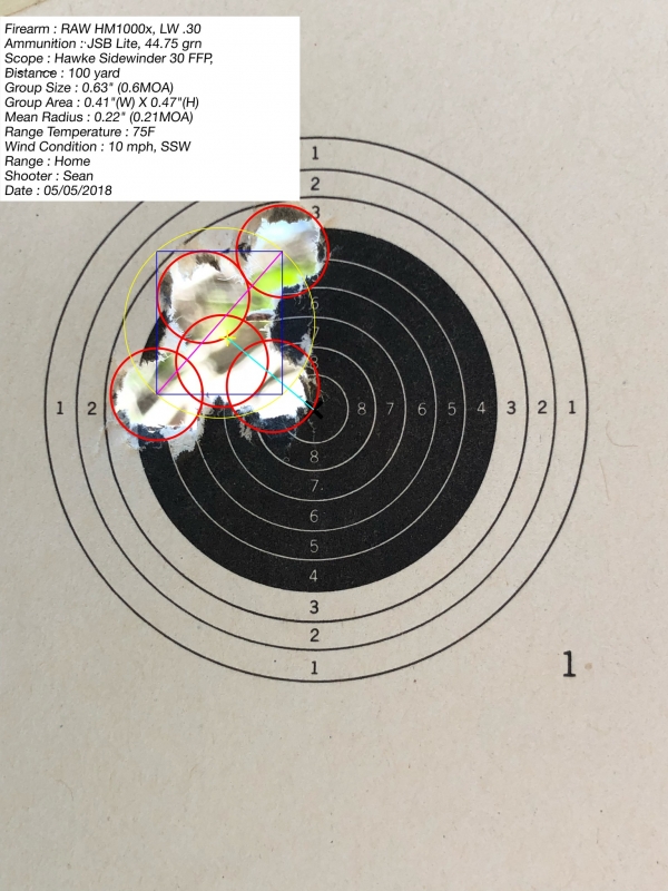

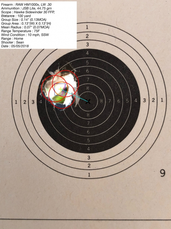

Well, I went to the club today to shoot at 100 yards. Immediately things were different for me, since the range was slightly downhill there, and it required me to raise up my rear bag (a LOT) to get down to target. My position was pretty bad as a result-struggling to get correct eye alignment most of the day. I need to add some holes to my shooting bench to adjust it to shoot downward next time.
Then came thw wind-it was blowing pellets (.30 cal!) all over the place at 100 yards. Most groups were in the 1.2 - 2” region-not at all what I’ve come to expect. My son kept callimg, range lawn mower was creating a ruckus, people talking, and my bench was only supported on 3 legs (and was rocking the whole time shooting-making a steady sight pocture impossible!!!)-a far cry from my home range conditions.
I did have a few times where I had a lull in the wind, and got one excellent 3 shot group in, and one pretty good 5 shot group in (see below), and then the next groups opened way up again-pretty frustrating, but fun to visit with old friends nonetheless.
Best 3 shot group (@ 100 yards), .30 cal, JSB Lites:

Best 5 shot group (@ 100 yards), .30 cal, JSB Lites:
1525549241_14898147505aee08b9afd495.94186151_2128330C-11F4-4031-B1B2-15216AAD5430.jpeg

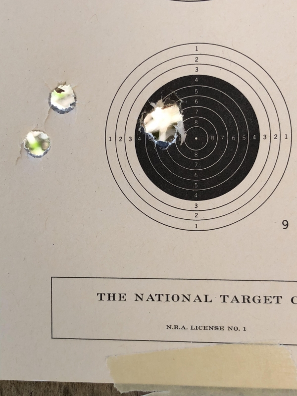

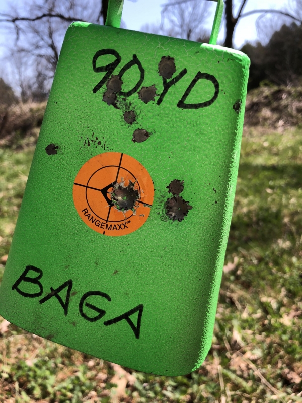

I then decided to shoot the cow bell (@90 yards) lying prone with my fake Atlas bipod. So I threw my adapter on, laid down dialed in the correct adjustments (3.0 mil), and squeezed the shot off-hit the x first shot! Then another shot was slightly right if the first. I realized I was damaging the bell so I stopped at the point (can you tell which two shots were from the .30 caliber?!?!)...
I have some adjustments to make to my bench for next time. Today was a definite learning curve kind of day for me. 100 yards is a long way! Time to start learning and adjusting for the wind conditions...
