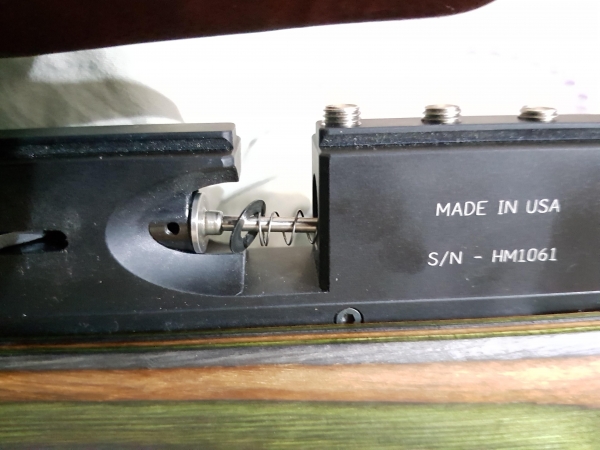

"mubhaur"Dear Sean,
I have gone through the referred document but it appears that the method of swapping of barrels is related to those old models that had adjustable probes.
Please post photos of your guns. I just looked at Craig’s last night and it is the same as mine. I can assure you our are the very latest actions/guns from Martin. Your’s must be different somehow-inless there are different versions for international guns vs FAC / US models?
Sean

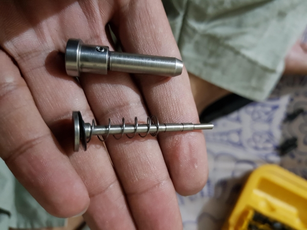

Dear Sean,
Its great and easy to change.
I was trying to remove the white tiny screws that are in probe.
Now as advised I removed the grub screws that are in black cover of probe.
The probe came out apart.
Thank You.

Excellent! Yes, just put the inner probe and spring back in-those are common to all calibers. You only need to change the ‘outer probe’ (The one with the tiny grub screws in it-which you do NOT tamper with). You may need to load those parts in from the front of the action to get them back jnto the bolt assembly-thats how I typically change the outer probe for caliber swaps.
Glad this is working out for you-our designs are indeed the same, based on your photos.
