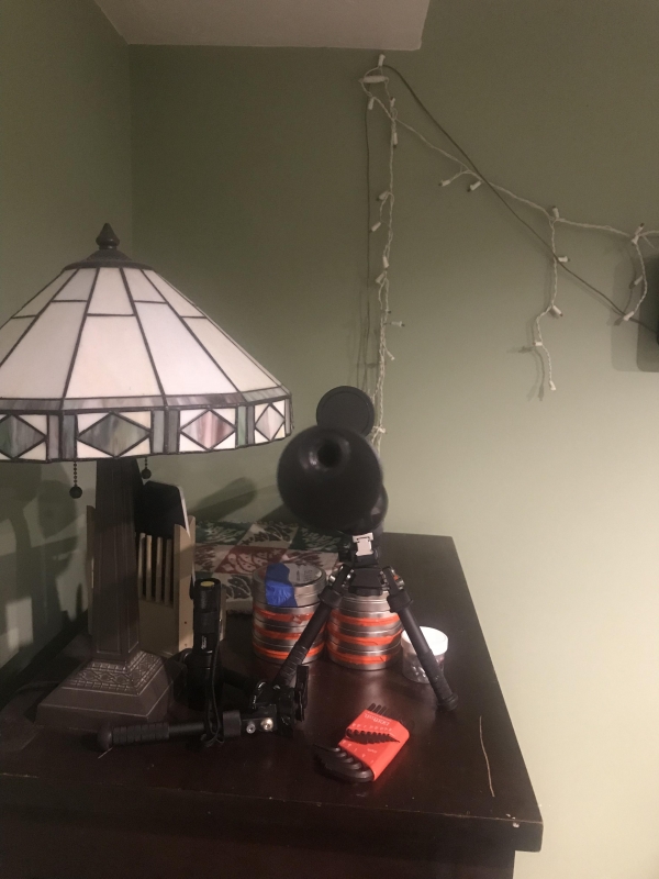

Alright gents, need some help.. I know I asked this before but how do you remove this offset moderator? I took off the big screw to the front of the moderator after that.. no clue what to do. Any help, pics, etc.. would be greatly appreciated! Have a good night.

Once you move the screw in the front you just need to pull straight off.
If only, won’t come off..
The first time it’s a bitch, you take the screw out and the top cap off . Then you have the carbon fiber sleeve. You have to grip it and slowly pull with a slight left and right twist.
But to be clear once you remove the carbon fiber piece the black base it slides off of does not come off as it’s held in place by a blind pinned first chamber of the moderator.
To be honest why do you want to remove it?
The Moderator is only a two chamber system. When I get home I will try to take pictures for you.
