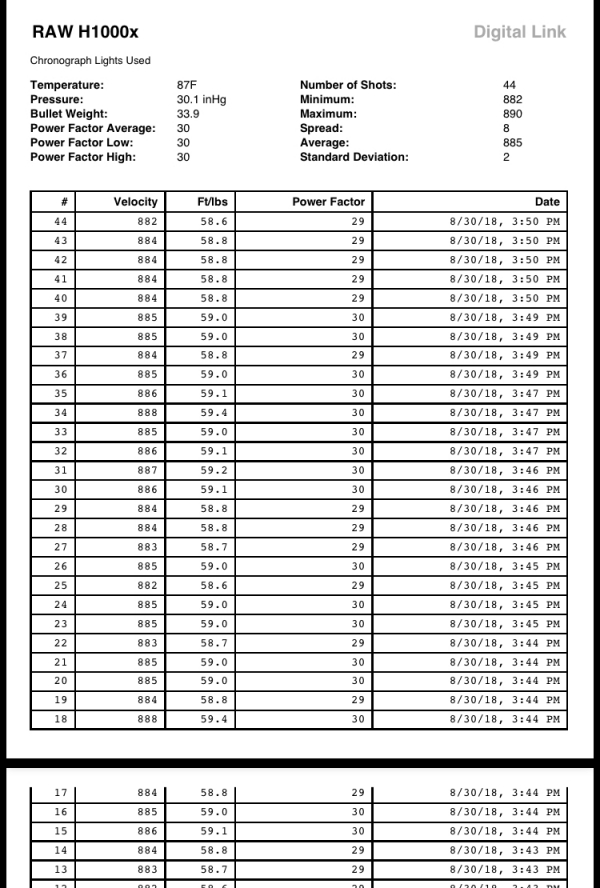

Was doing some work on the RAW yesturday and damn was it hot out... .
1535719656_12730040115b8938e8841fc3.74940345_91ABA88F-30F2-4726-8BBA-EB5C98082095.jpeg
