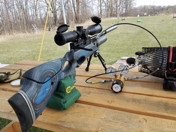

Pic of my HMx357 just because I thought we needed a pic today.
1537218940_16702511345ba0197cb6a360.52452893_8650A90B-A7AB-4664-AE5F-57CA292E300B.png
Sweet Jim! I love that stock color, and your setup!
