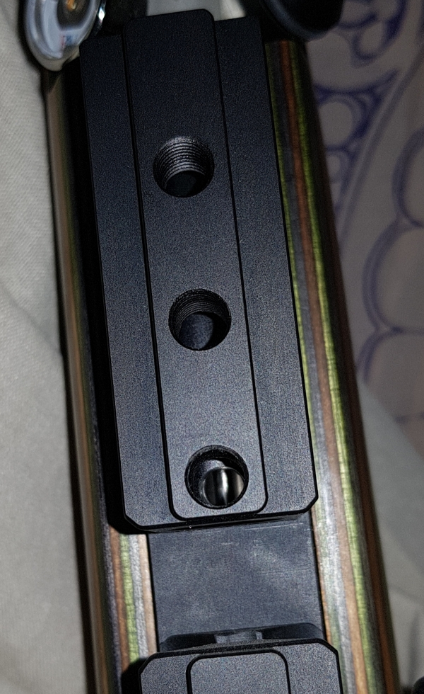

Just inspected the TP hole in the action of HM1000X .25 60 ftlb. It is round. But the TP in the barrel is rectangular.
What can be the reason of this mismatch?
If the TP in the action is round then TP in the barrel should also be round to get full potential of power I understand.
Please correct me if I am wrong.

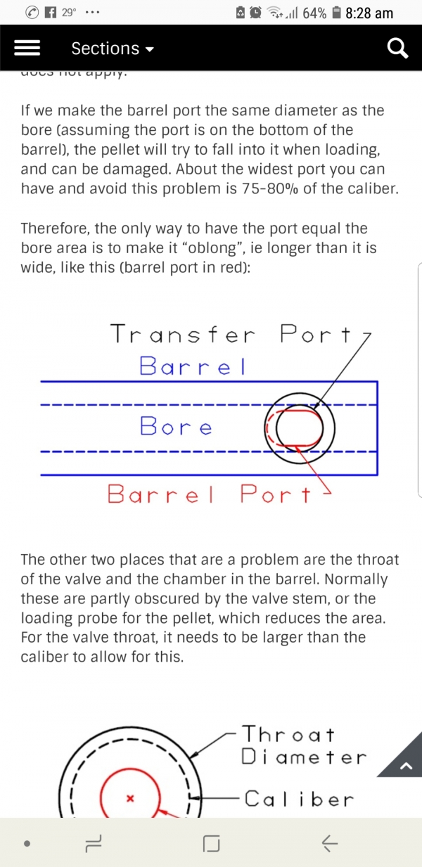

This is the basic info that I found by Google.
