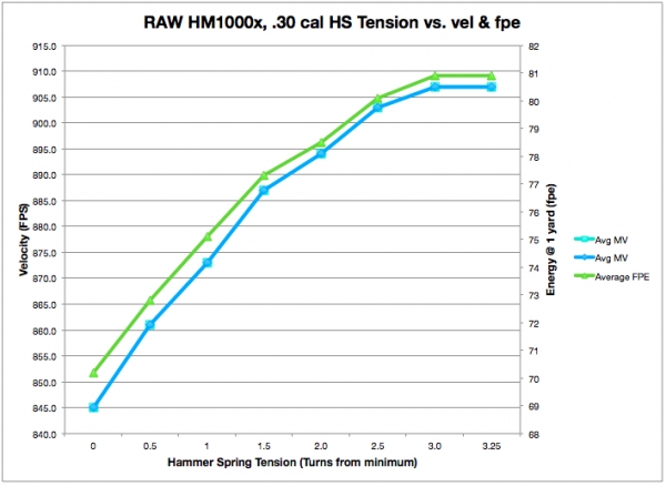

Threads gone a little stale so I decided to mix things up and investigate something that hasn’t been reported yet: power/velocity changes with hammer spring tension. I put my .30 cal barrel back on and shot JSB lites at the lowest setting, and then turn up the tension in 1/2 turn increments until I maxed out, shooting ~5 shot groups over the chrony to see changes in muzzle velocity. Will post the results once I have a chance to process them.
When done with that, I also remapped the BC of the 3 .30 cal pellets I have at the lowest and highest HS settings to see how the BC changes with velocity. Temp is about the same between tests, though humidity and pressure are pretty different. Will post those findings too.
Lastly, I have data to show how muzzle velocity changes over a wide range of temps (~40F up to 97F) ao I should be able to box out the range of power adjustments in .30 cal setting and plot that too.

Here's the plot of Hammer Spring Tension vs. Velocity (muzzle and 1 yard) and Energy (@ 1 yard):
1538843791_12924765525bb8e48fa41e81.93045587_RAW HM1000x HS Tension vs. Velocity and energy.jpg
1538843808_17463731985bb8e4a1003510.30174230_RAW HM1000x HS Tension vs. Velocity and energy.jpg
Shooting the JSB .30 cal heavies at 865 fps muzzle velocity yields 83 fpe. Man does it smack steel spinners hard! I get about 24 shots on this power setting. In contrast, when setup to ahoot the JSB Lites at 840 fps, I got about 40 shots per fill.

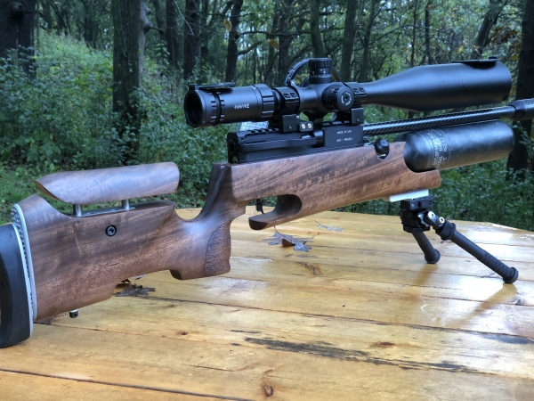

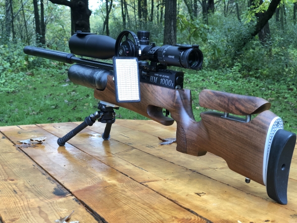

i love that stock SEAN is that a real ATLAS bipod,,i picked up a CALDWELL SHOOTING TABLE like JIMS and a ROCK shooting rest also a pair of HAWKE FFP 6 24 56 scopes ,last week i contacted DONNIE FLA and he let me know the RAW LDC adapters came in but were not the correct size so its gonna take about another 2 weeks to arrive ,HAS any one seen a RAW select black walnut stock thats the type of wood MARTIN uses,,

Thanks Pat! Yes, that is a 'real' Atlast bipod-I finally splurged and bought a PSR model after waiting for a CAL version and cancelling my order due to the wait on their redesign. Let me know how you like the Hawke FFP scopes-I still like mine a lot.
