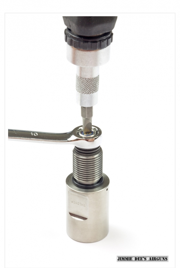

Is there’s some good info somewhere on adjusting the reg on a RAW 1000X ???
Here is an old picture of a Rapid reg. You hold the piston at the end and you tighten the nut for more pressure or loosen for less. Turning clockwise (tightening) compresses the belleville washers thus increasing pressure. CC does the opposite. Make very small adjustments and then test.
