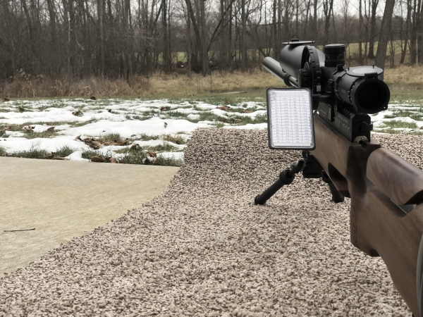

Happy Thanksgiving guys! Its nice when you can go visit friends and take your gun with to spend some quality time shooting! I got to teach his two kids to shoot yesterday (in the 28 F temps). Today is about 25-30F with a 15 mph wind. Hitting the spinners at 102 yards all the time...
Update : my friend’s wife wanted to shoot and was hitting the spinners at 102 yards about 75% of the time-and called it a lot of fun on the process, all in 30 degree temps. Great day today...
