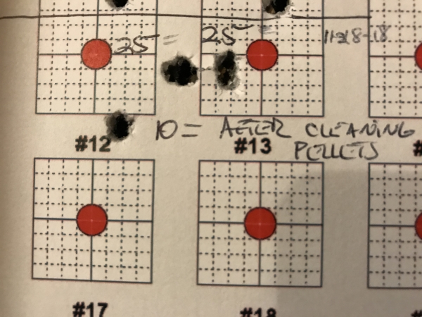

Well because I was up! And curious about a couple things?,thought I would do a 50 shot chrono. String: BM-500 w/poly barrel all stock from Martin, Indoors 70deg.,13.4gr jsb 4.52 head dia. Not weighed straight from tin! 1st shot clean barrel = 802fps, 2nd=809, 3rd 814, next 47 shots were from low of 811fps to high of 822fps! For an E.S. of 11fps I’m not counting first 2 shots as I normally fire @ least 3- pellets to season barrel after cleaning before shooting my first card! As a side note I fired two cleaning pellets (together) after the 50 original chrono shots, then fired a 10 shot group @ 16.5yds, Thought this curious also first 25 group on (right) some vertical! Next 25 (left) more Horizontal!, last 10 a hint of vertical? Now will say first 50 not to concerned about group size!
