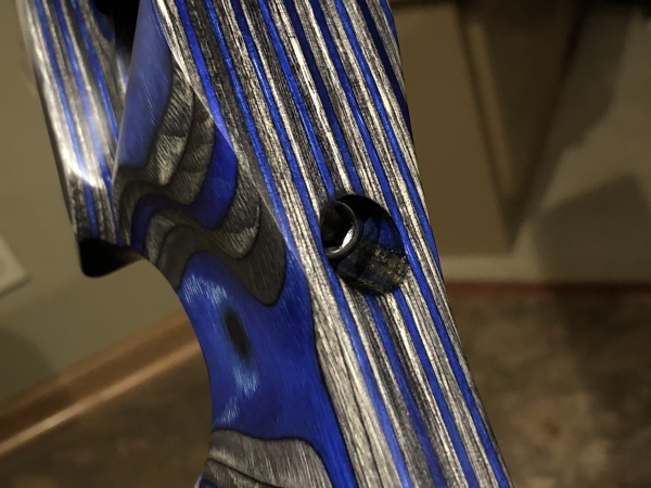

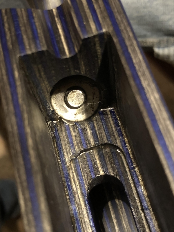

Strever, I know that stock... looks like it worked out well for you!, I think I’m shortening my BM stock about 2”? terrymc my brand new BM-500 came directly from Martin with a pin up through the pistol grip too!, didn’t even notice it till about a week later?, never a mention of this on invoice, or any verbal communication or extra warranty info, etc. that was a little disappointing! Curious if all BM stocks after certain date were automatically pinned as a precaution?

Here are pictures of the reinforced area discussed above, in case anyone was wondering what we’re talking about:

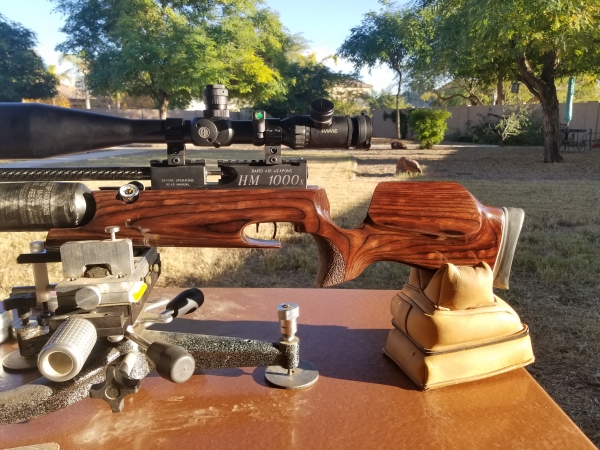

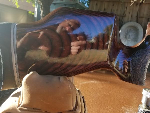

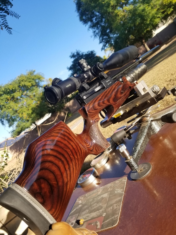

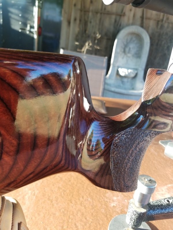

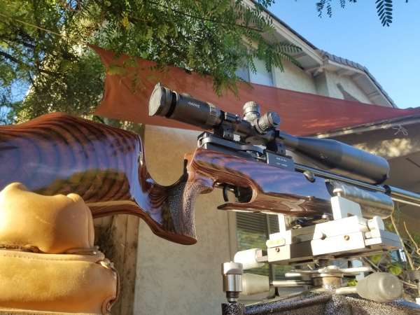

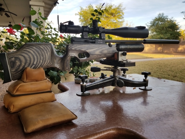

So I said there was more that you would see of the Sporter stock that I did the LRT trigger guard and said it would be a surprise.
I present to you COPPERHEAD.
The worlds only sporter stock with an LRT trigger guard and presentation grade Walnut color laminate stock.
So it started as the Psycho Zebra and was a standard gray laminate Sporter.
So I did the LRT trigger guard and since my BM stock came in this one was a spare so I thought I would experiment with the finish as in color. I mixed some Behlens American Walnut with some Minwax Sedona Red to give it a little extra highlight. Staining is as many have described with Laminate it takes some effort to get it even, even some touch ups in progress. Then I finished off with lots of coats of Formby's Tongue Oil.
I also made sure the stippling I redid only got a few coats of tongue oil so it maintained a mat finish. In addition I stained it with different color Minwax "dark walnut" to give a two tone finish to the stock.
So what do you think should I return it back to what it was? LOL
Actually there are a few touchups I want to do but it is close to done.
Wow Terry that stock is beautiful! I've used wood dye on a LRT laminate to improve contrast and get the color I wanted and it IS a lot of work. Worth it though. It never occurred to me that a stain combination could actually change the color enough to get this kind of result. Now you've got me thinking about a rather drab 2tone gray LRT stock that I have on another gun. Hmmm - gotta get more sand paper tomorrow. Uj
Hey now don't beat me to the finish line.
After this one I am seriously thinking of redoing my LRT stock. LOL
