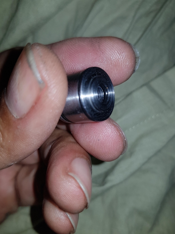

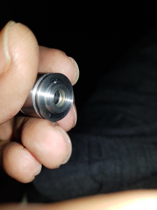

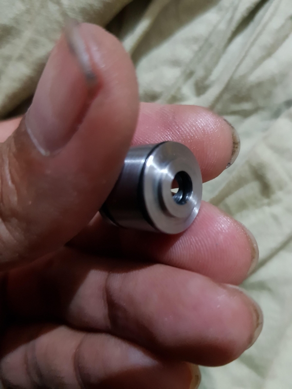

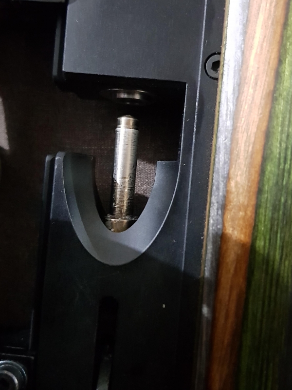

Dear Friends ,
I leaned that A Zasanday puts O ring sealing seystem in breach of many Theoben Rapid guns.
I am always a fan of breach sealing by means of O ring. If this system is designed with due care, it provides 100% sealing without any efforts to close the side levers or bolt actions.
I am only aware of Theoben Rapid and RAW guns that use matel to matel sealing for breach end.

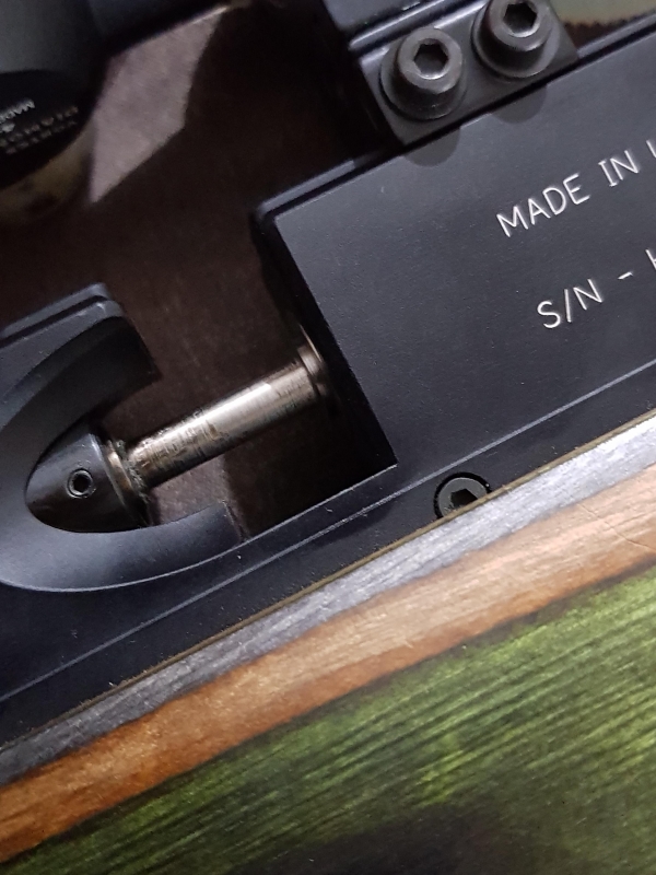

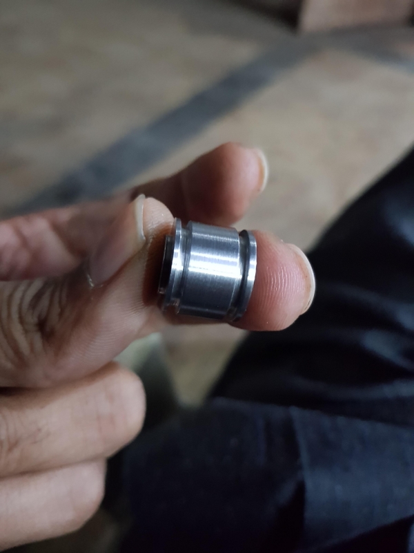

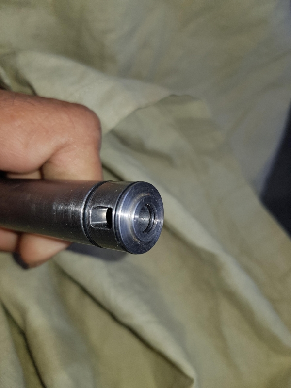

I developed an indexable TP and this time with a grove for O ring inside the bore of TP.
Redesigned the probe also. It's not taper now rather it has a slight edge that sits on the face of the breach end.
Now I have kept very low pressure on the cocking cam of the gun.
Now the side liver closes as easily as of FX Royale series guns. Still my HM1000X is sealing perfectly rather even better than before and is butter smooth.
Some pics are here for your interest.
Regards,
Umair Bhaur
Very interesting and noce job Umair! Thanks for sharing the information with us!
What made you decide to do that modification? Aside from breech closing effort, what other differences have you noticed with the seal in place?
Sean
Dear Sean,
In fact I have repaired a few Theoben Rapid guns in the past and inspected well the material used in the cocking bolt and the side plate where the cocking bolt is locked. I found that both the materials were very high quality and highly resistant to wear and tear even in the extreme use.
Still I found one such Rapid that used to give the blow from the breach at the time when shot goes off.
I had to put a lot of effort to resurface the tapered area of probe as well as probe seating cavity in the breach.
Still I had to adjust the probe a bit hard to lock any escaping air.
Since then I had planned that if nothing worked, I would modify the Rapid and install O ring inside the barrel.
I never did it to that Rapid. But when my RAW came I noticed that it had the same sealing mechanism but it also had a cam on the function of cocking lever that gives a slight sound of click while closing under pressure.
Cam is such a thing that may wear and tear with the passage of time.
Further I did not like the feeling of a bit hard closing effort of cocking lever since I was used to fx guns in the past.
I have worked on Cricket, HW100 and many more brands but almost all used O ring for secure air sealing.
Now the benefit that I get by installing the O ring system is that the effort of closing the cocking lever is almost 5% as compared to when it was in original set up.
This highly reduced closing effort and inevitably translates into 95% less wear and tear in the cam of the cocking system.
I am witness that such O ring system if installed with correct tolerances does not affect accuracy at all and seals perfectly. Also in a good developed O ring system the O ring lasts at least a couple of thousand shots without any problem. Replacement of O ring is very easy.
So the gun became less prone to wear and tear and more consistent in fps and more convenient in use.
I just shot a 5 shot group at 114 yards with this system installed with jsb 18.13 grain at 950fps and the group size is 1". I didn't use bench rest for this group rather just from the roof of my car.
Best regards,
Umair Bhaur

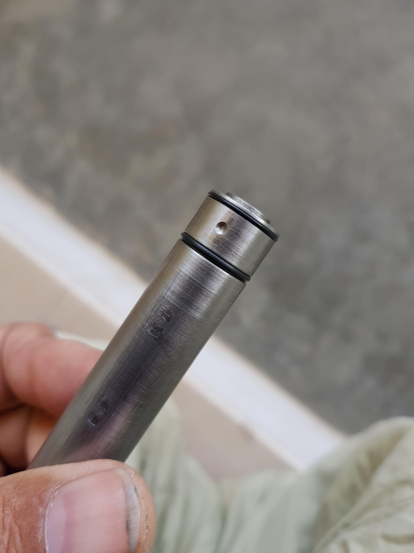

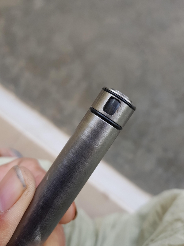

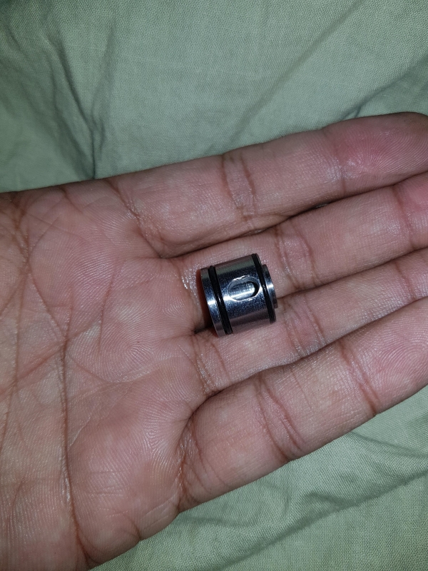

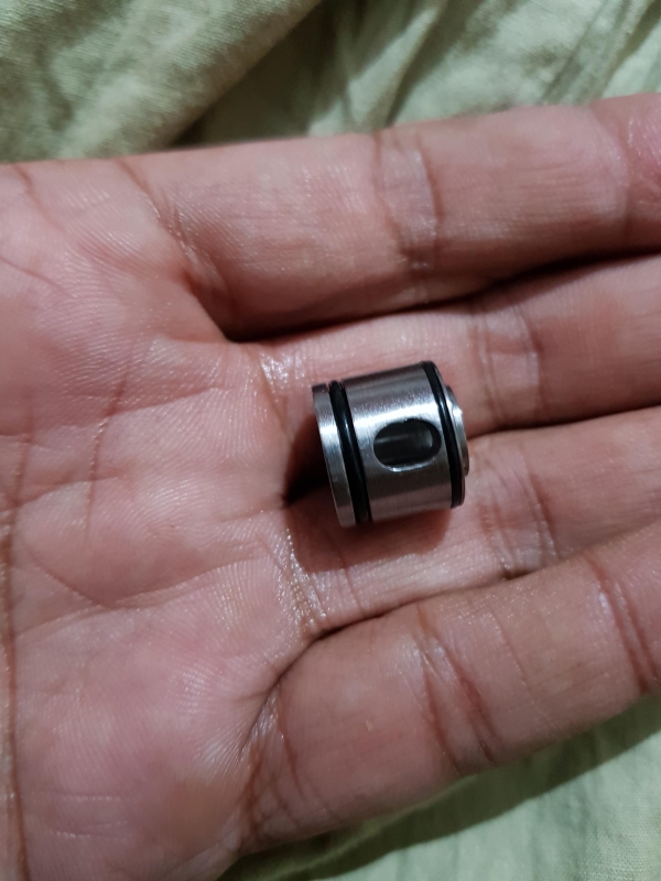

Here is some more work. I not only converted my .22 HM1000X but also .25 60ftlb into O ring breach system.
Both works butter smooth with perfect sealing.
As you see that for my 50 ftlb .22, I made a capsule shaped TP hole.
Also put O rings on outer dia of 60 ftlb .25 original barrel.

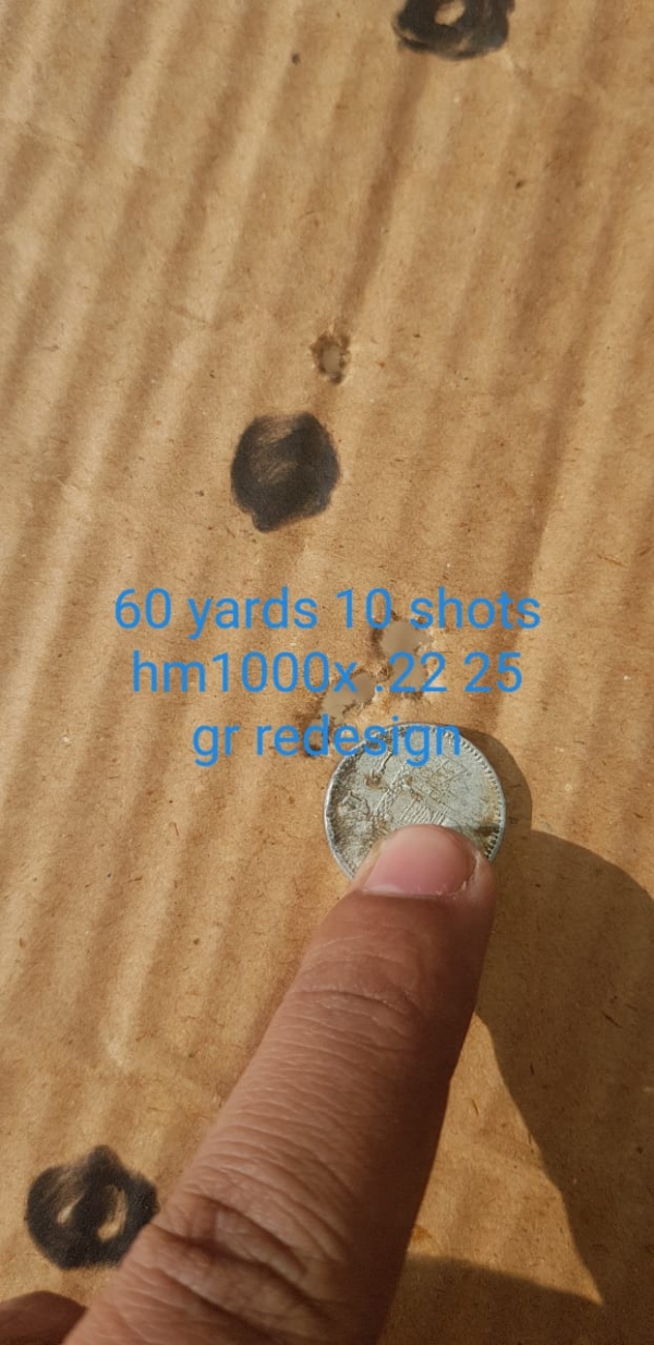

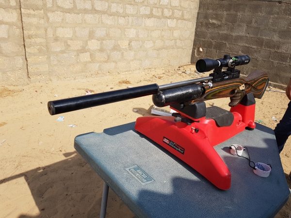

This is 10 shots group of today .22 25 grain redesigned pellets at 935fps in open area and 16km wind at 60 yards.
Later an other group of which I didn't take the pic was not more than quarter inch at 60 yards with .22 25 grain redesigned pellets.
Regards,
Umair Bhaur
