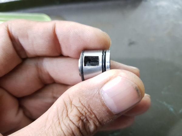

Indexable Thimble: You have rightly pointed out that my initial concern for developing an indexable thimble was to index the barrel and to control the size of TP hole by just rotating the thimble a bit.
My initial experiment was with a thimble that had metal to metal contact with the probe in which I had become successful finally after obtaining the correct angle in probe and breach. But I always feel that the cam of the side lever needs a bit more load (causing wear and tear) than those guns that seals the breach with O ring system.
Metal to metal contact is good for those who cant carefully clean the barrel and ruin the O ring while cleaning the barrel. This is not the case with me. I achieve 100% sealing with O ring system with the least lever closing effort. This is an icing on the cake.
The O ring system appealed to me so good that I also put the similar system in Original barrel of HM1000X. But this time I did not need the separate thimble as Martin sent the gun with already perfect indexing.

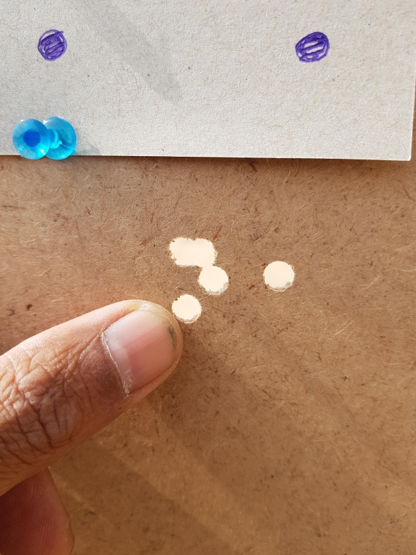

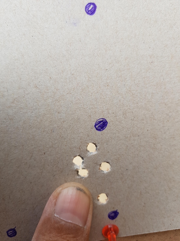

Today's shooting session.

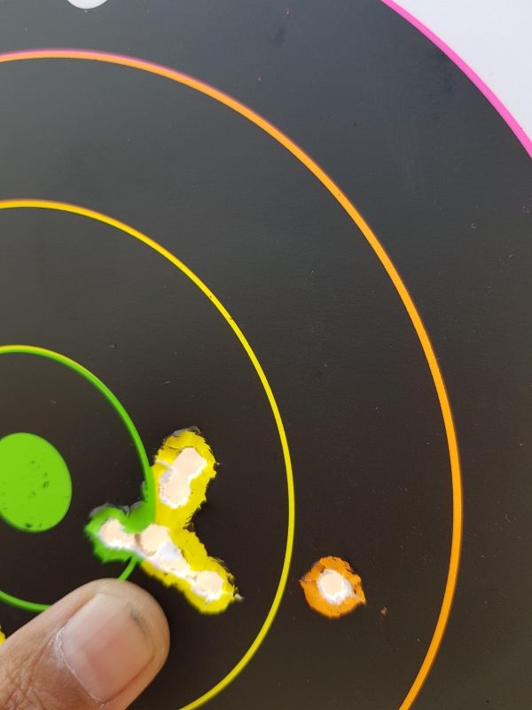

The above 10 shot group is by me from HM1000X .25 34 grain mk2 900 fps at 100yards. 11km wind.
The above group is also 10 shots group from HM1000X .25 34 grain mk1 900 fps at 100 yards.
The above 5 shot group is from RAW HM1000X .22 BSA barrel 18 grain jsb 950fps 100 yards.
During all these groups the wind was around 11km.

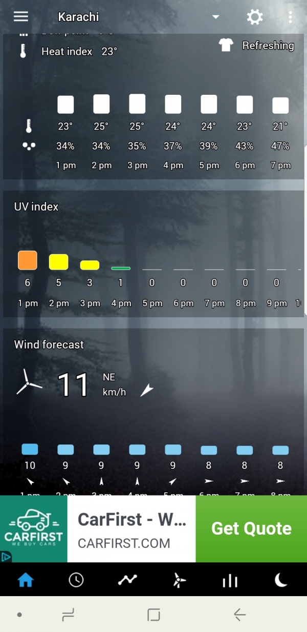

Wind screen shot is here below. But another weather application showed that it was 8 km wind.

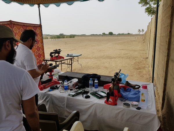

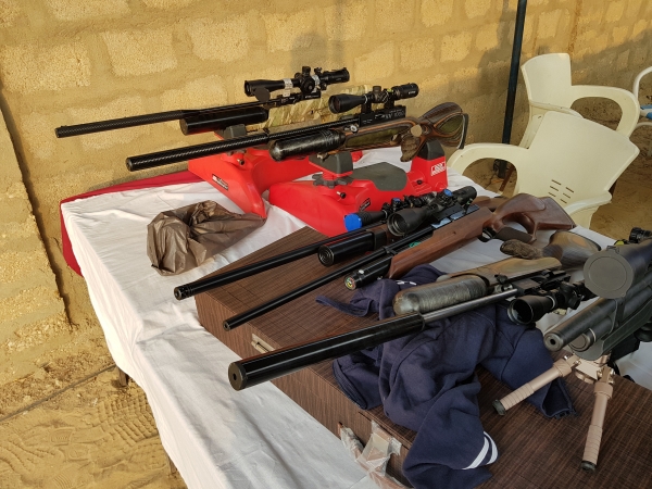

Some more pics of shooting range.
