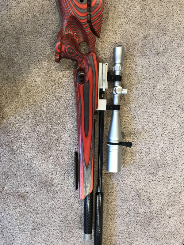

Bored today... so wrapped my air reservoir on the TM-1000 w/ C.F. Wrap, think it’s a pretty good match?

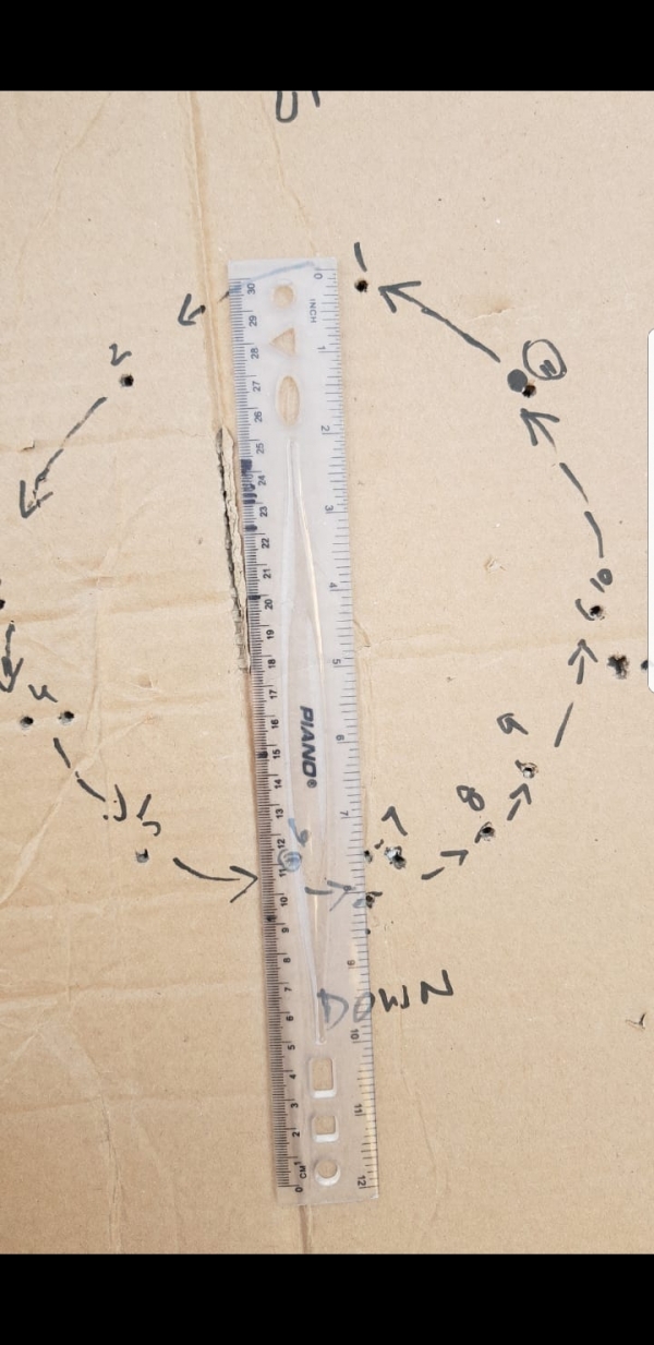

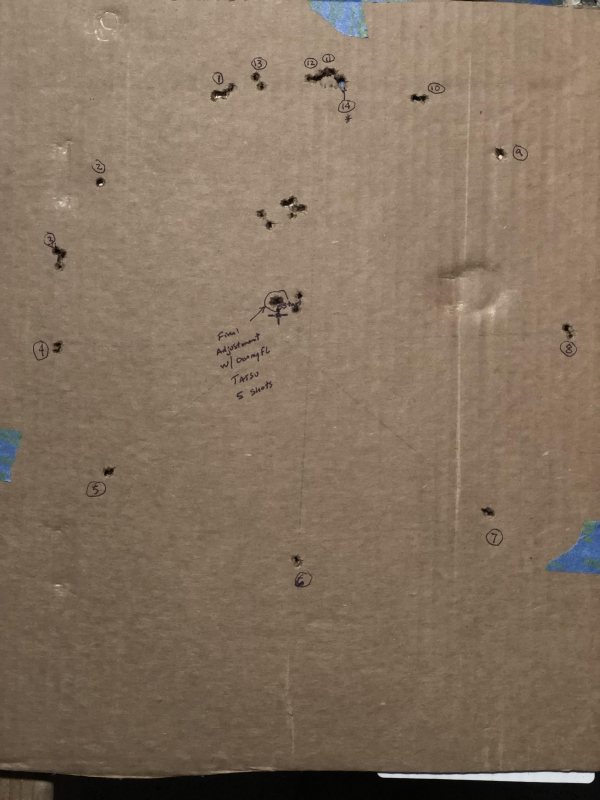

RAW HM1000X barrel indexed
Umair,
What distance did you shoot the target at when indexing your barrel? I'm planning to index mine tonight. I'm guessing it doesn't matter, but wanted to know if I should be doing it up closer than 20 yards like I was planning to do in my basement.
Sean
I did it at 24 yards.
I hope it Will help.
Don't shoot the messenger ..... at 20 yards and no wind ... SINGLE HOLE is what you should be getting.
Pellet barrel speed combo is not happy IMO.
Have seen and personally shot similar group sizes with my TM-1000 using JSB 14.43 monsters at 50 yards ! Not a brag, just some reality on what many others know and get on a regular basis.
Scott
i don't think you have ever indexed a barrel
if you had you would know there is only 1 in a 1000 barrels that will shoot a single hole while being indexed
the smallest dia i have ever seen was about 3" at 18 yrds but i have only indexed maybe 2 dozen barrels
Dick

Thanks Umair-I appreciate the information.
Dick,
Thanks for the comments. I suspect Scott was referring to my group sizes being single hole-not the indexing diameter itself (I may be wrong).
Scott,

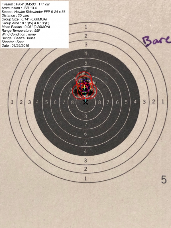

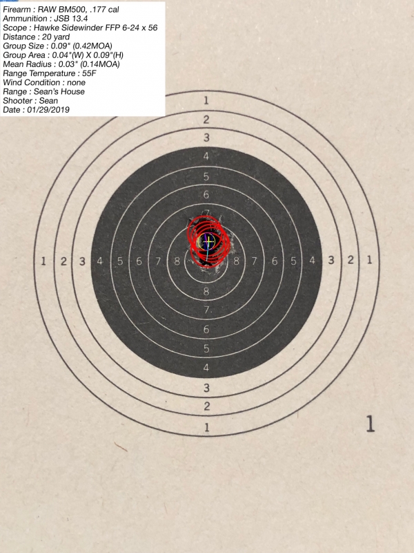

Thanks for the comments and experience. I think there are a number of reasons my groups aren't as 'tiny' as they can be (yet). Here are some of them: 1) I just received the gun and am still getting to know it, 2) I have a Hawke 6-24 ffp scope on the gun (can't afford a true 'BR' scope just yet) at it's max magnification, and it's out of windage adjustment 3) I'm having some issues getting consistent eye placement behind the scope and suspect I'm getting some slight parallax errors when shooting, 4) I'm using un-sorted, un-weighed, un-inspected JSB 13.43 grain pellets-straight out of the tin.
I generally see single hole groups (maybe in the 0.060" ctc size range) and then will get a shot where the group opens up and I notice my eye alignment wasn't quite correct.
Question: generally when indexing a barrel you want to select the 12 o'clock position, correct? It seems like there were other rotational orientations where the barrel was shooting a single hole (2 shot) group-should I be using one of those locations even though it's not perfectly vertical? If I did, I would probably use the spot marked #2 due to the single hole nature and fact that I can gain back some windage adjustment in the scope and get it off from being nearly maxed out laterally.
Thanks for your feedback guys.
Sean
Update: I found an interesting thread on the topic of barrel indexing here that is pertinent to Airgun barrel indexing. I haven't read the whole thread yet, but have already learned a good deal. I also note that (so far) they didn't mention to lock down the barrel set screws in between making rotational adjustments. You're welcome for gaining from my pain...
Question: I understand tuning for the vertical plane based on the forum topic. Why 12 o'clock vs 6 o'clock? I suspect its for elevation gain with pellet drop. I'm asking because I'm nearly at one extreme of my scope's elevation adjustment and would be closer to the 'middle' if I went with the 6 o'clock position. This scope has FX no limits mounts on it so I can gain more vertical if needed with the mounts.
