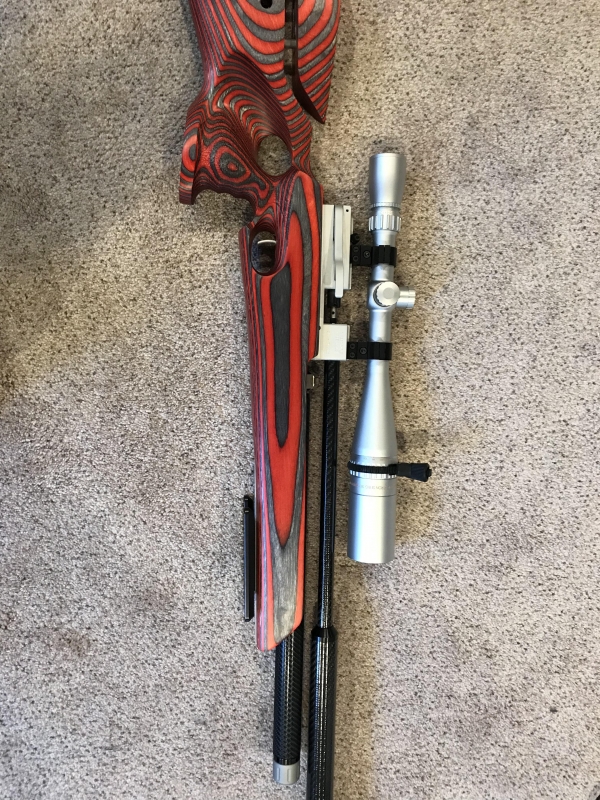

Bored today... so wrapped my air reservoir on the TM-1000 w/ C.F. Wrap, think it’s a pretty good match?
That looks great. I'd like to do the same to my TM with the white tube. If you don't mind sharing, what exactly did you use(never used CF wrap before).

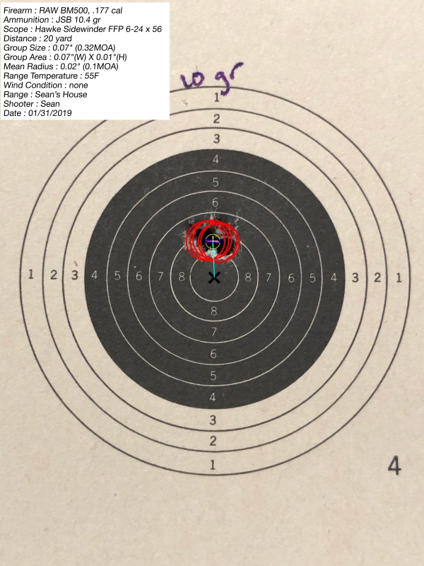

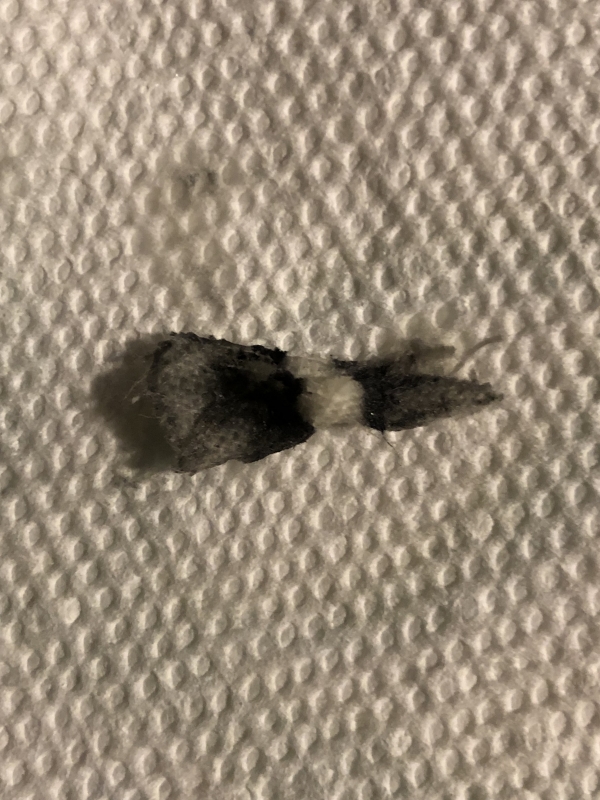

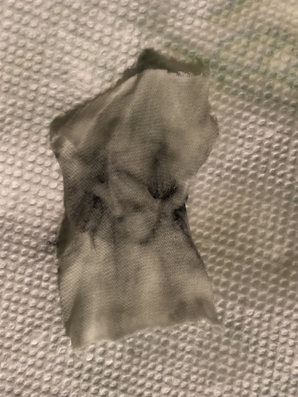

I haven’t tried it yet, but perhaps I meed to clean this barrel since I have jo idea how dirty it is and I have put nearly 400 rounds of my own down the pipe already.

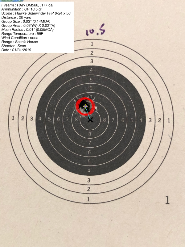

So I think I found out a few things:
1) My barrel was extremely dirty!
2) JSB 10.4 grains seem to shoot better in my barrel: (but still not 'great')

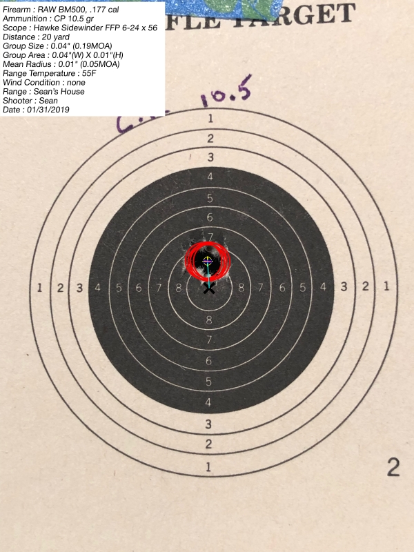

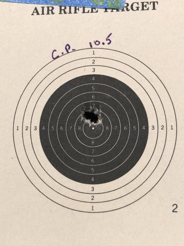

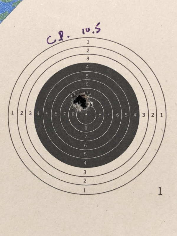

3) Crosman Premiers 10.5 gr rock-even when highly oxidized (from 1998): {unsorted, unweighed, 20 years old, oxidized heavily...}
5 shots, 0.040" CTC!
Followed immediately by 5 shots @ 0.030" CTC!
Needless to say I immediately went and ordered 4 more boxes of CP heavies!
Sean

Interesting because my polygon barrel doesn't seem to like the 13.4 grain JSB's much at all. Now that I've cleaned the barrel, the 10.4 grains seemed to shoot pretty good. Obviously the CP's shot excellent, as shown above.
