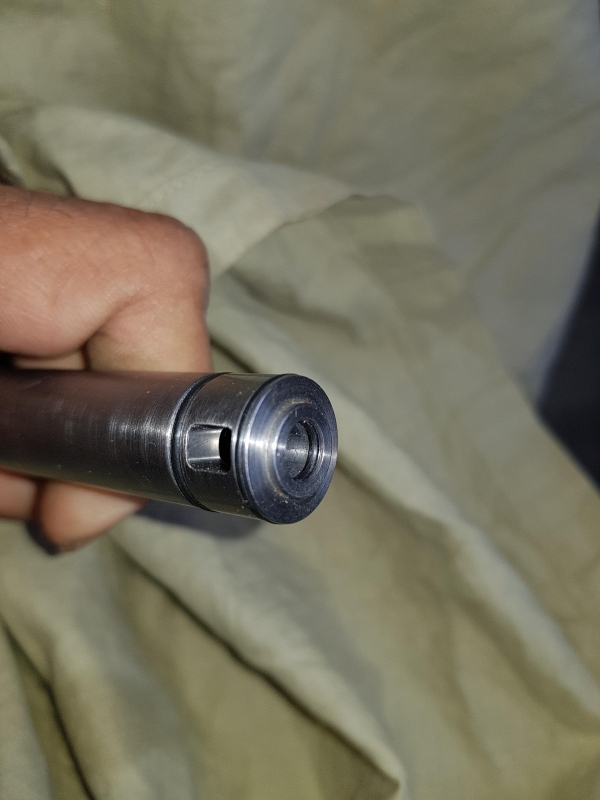

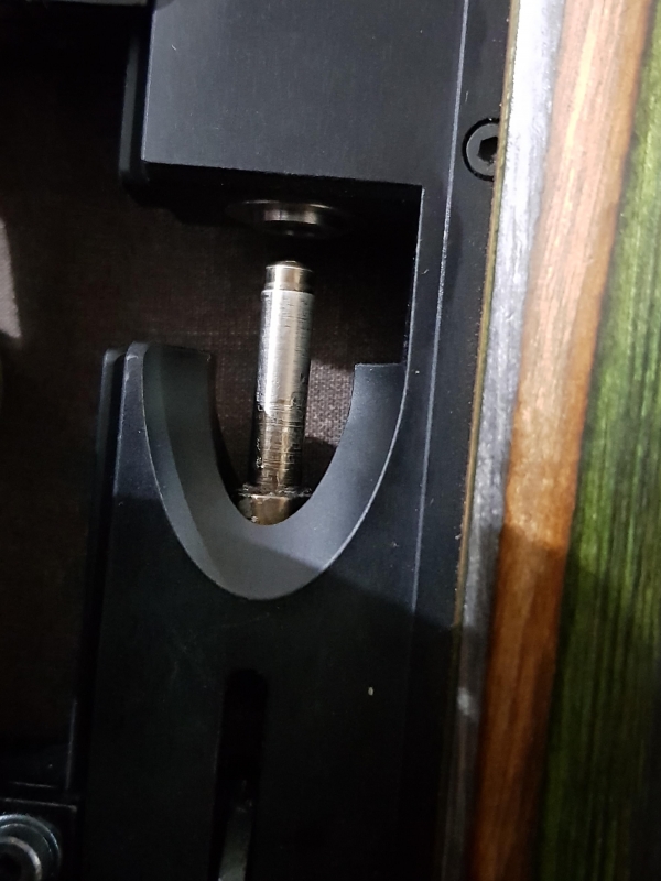

The thimble is just under the 3rd retention screw, remove it and then a full length barrel will fit in the same occupied space. easy peezy

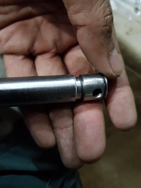

I'm wondering about trying different barrels since its now pretty easy to do (with a thimble on my gun)...
Sean

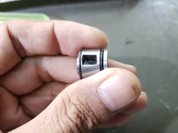

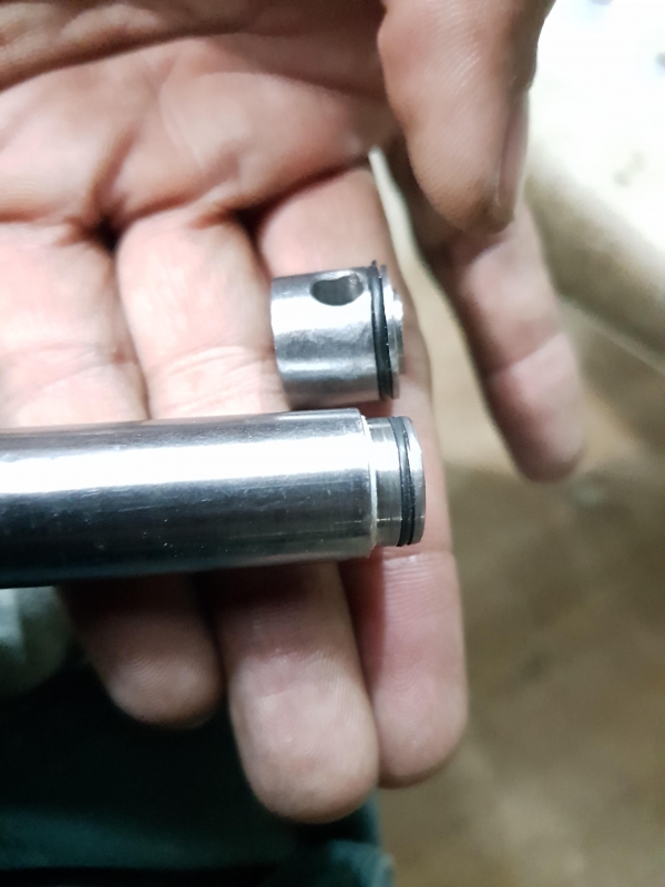

Not a fan of thimbles on "Single shot" Target guns .... With the freebore ( loose leade ) a thimble has you loose the feel of how a pellet fits the bore when loading.
And the case of RAW you loose 1/3 of the barrels rigidity within the receiver too.

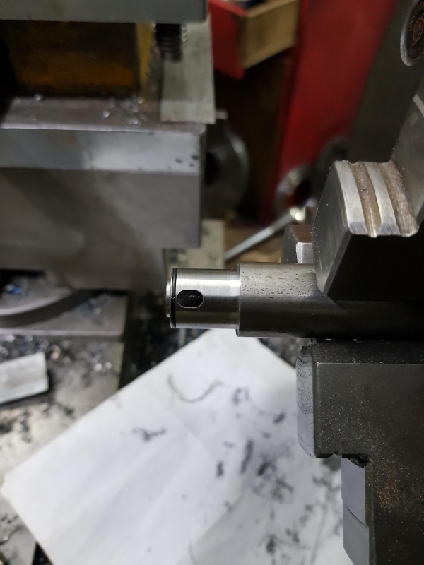

I simply will fit a barrel to receiver and using a dial indicator spin barrel within receiver finding where the run out clocks at 12:00, mark the spot and finish the transfer port and grub screw flats etc ... Done with the full rigidity of receiver front to back.
Scott S

When I used thimble in HM1000X, I feel pellet enganging the grooves all the way to the skirt.
Barrel and thimble overlap a bit and hence not much compromising on the rigidity.
