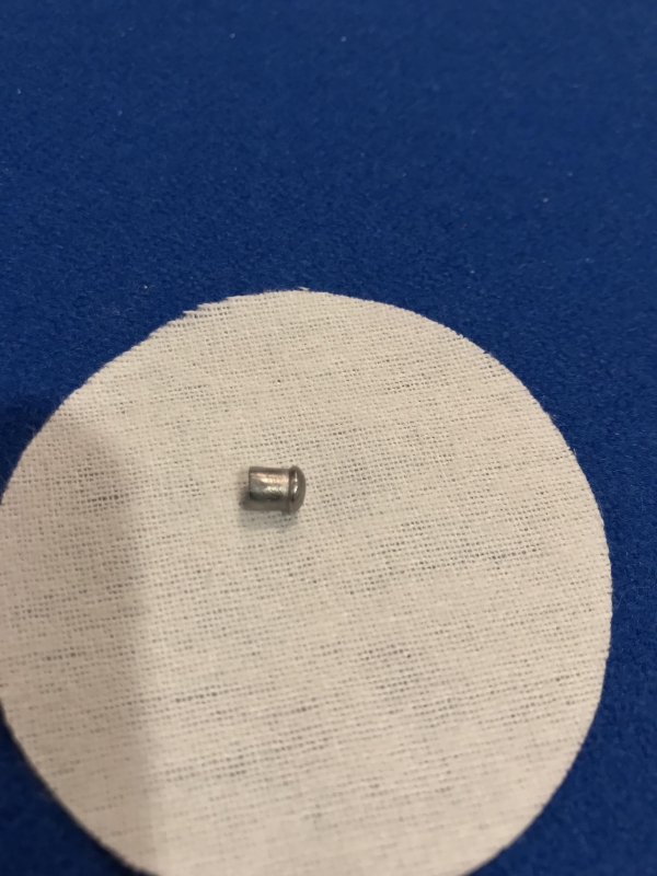

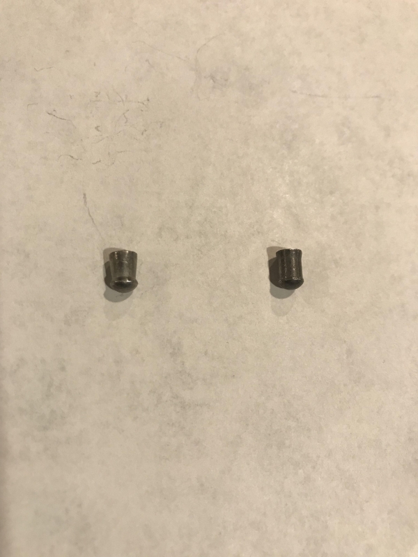

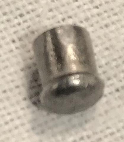

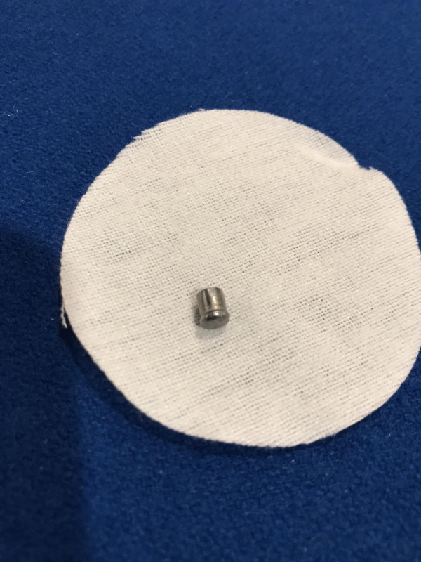

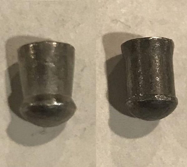

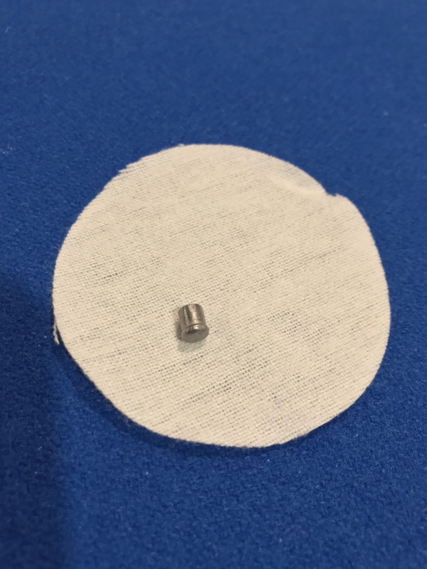

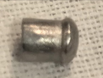

Thought I would add this: these are pics of pellets seated in my BM-500 LW “polly” barrel by pellet probe only!, then pushed back out with a cleaning Rod... 1-RD 13.4 2-original 13.4 JSB’s 2nd single pic is of a fired RD 13.4 JSB NOTE: pics are the best I could manage w/phone camera, these detail how you can see shallow land marks both from just seating pellets and firing pellets completely through barrel “ just though it was of interest? Also note seated only pics were from several months back just found them knew they were floating around my reloading bench!
Joe

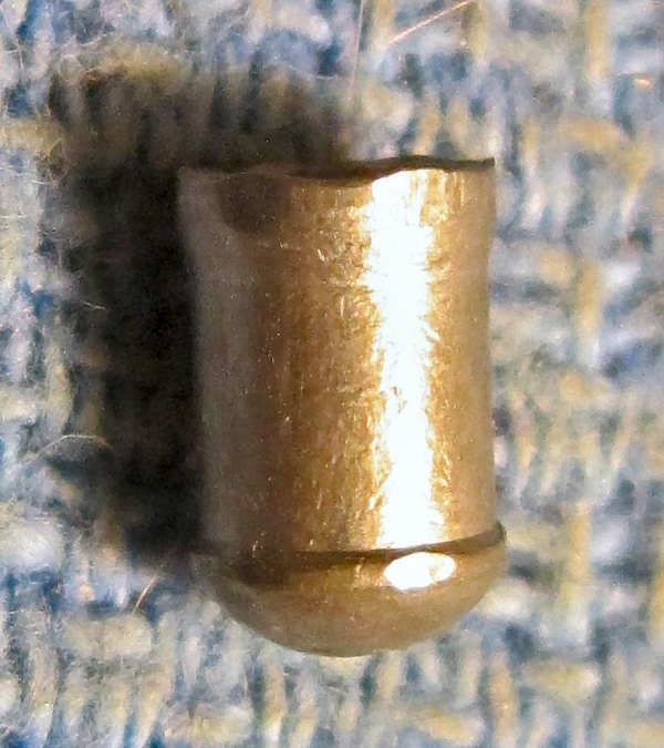

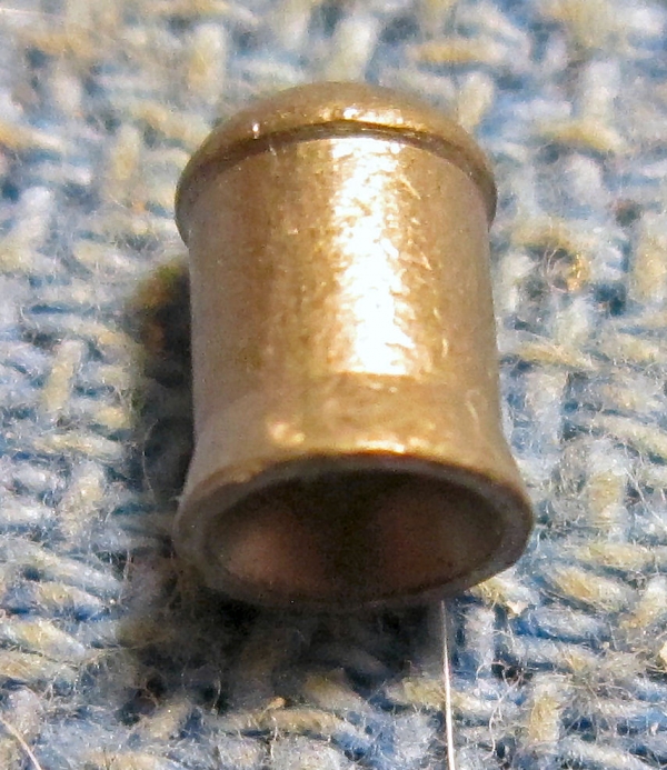

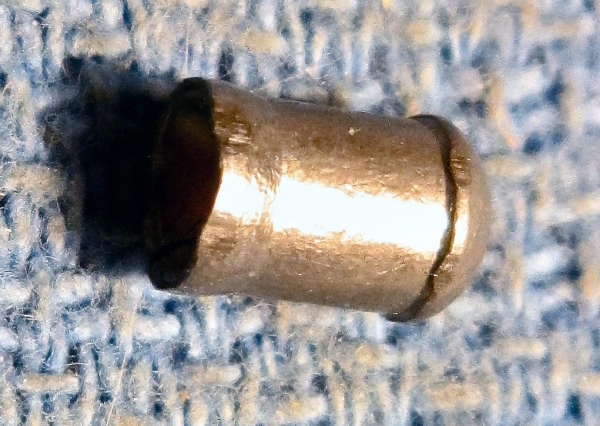

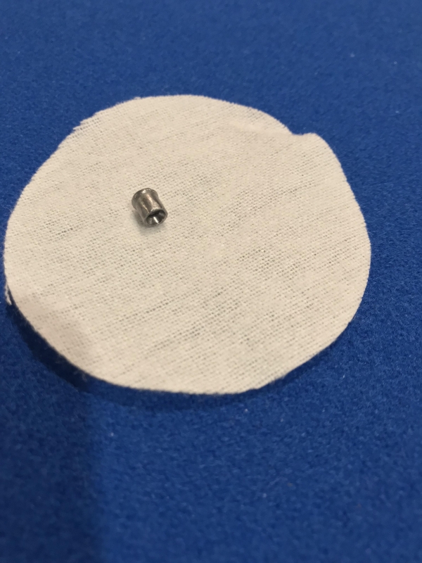

i wanted to show you what cropping your images can do
i pushed a monster thru a poly barrel
the first image is a unused pellet out of the tin showing how much damage is already on it
the next image is thru the poly barrel showing the rifling
and something i had not paid any attention to before this
look at the dregs hanging off the tail, it's not flat any more
