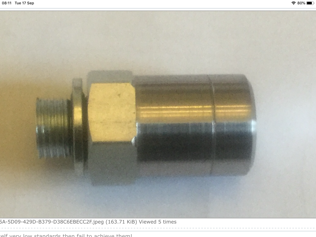

The alterations to the reg are not for power but for efficiency in sub 12. The hole in the centre of the push pin on a raw is 0.8mm, this allows air to quickly pass during the shot for fac power but in sub 12 the flow is best restricted down to 0.3mm. I also change the sealing material in the nose of the reg from Pu to delrin and engineer in 0.3mm of endfloat rather than adjusting it and comprising the collar o ring.
for power you can shorten the core, use stronger belville washer and a smaller profile nut, all these free up prechamber volume or you can attach an external plenum instead of the bottom blanking plug.
If your gun didn’t have a v fill anther simple option for extra volume is a valve chamber extension

Umair,
best people to speak to about short core regs if Nick who makes an excellent nano core reg (these are exceptionally short) or kevg who makes short core regs. Both are on the R7OC pm them, I am sure they can help.
one thing to note, because short core regs have much less stack, they are much more sensitive to adjustment, 1/6 of a turn on the reg nut makes a big difference on reg pressure. It is for this reason I use short core regs when all other volume upgrades are not an option.
bb

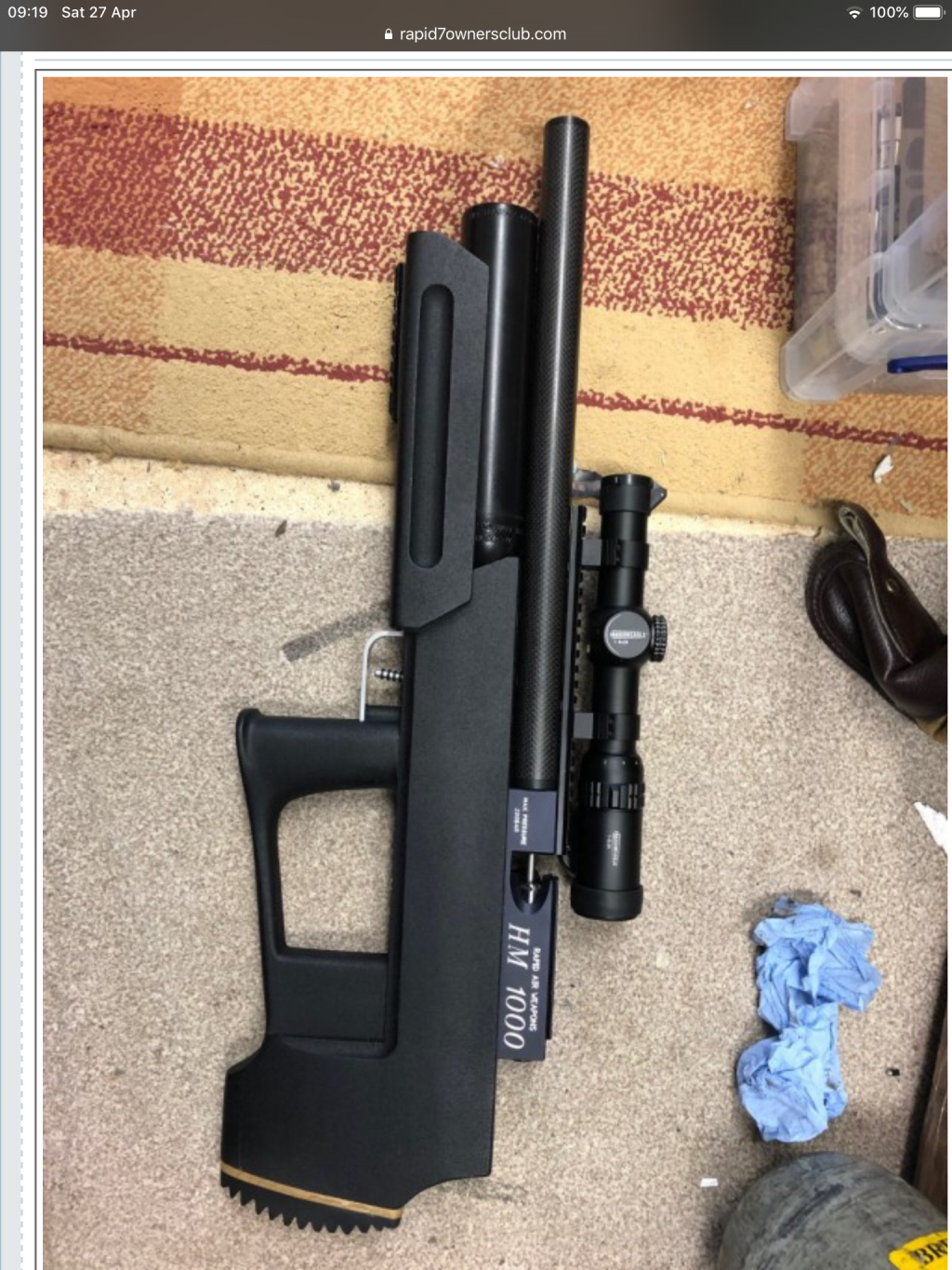

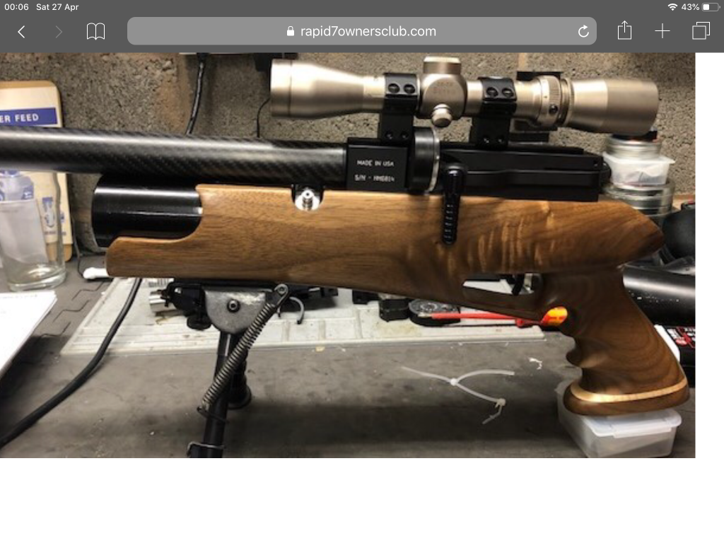

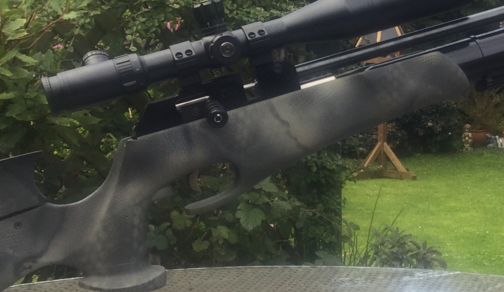

I am not sure if I have posted these photos before, I apologise if I have but here goes.
here are two RAW hm1000 that I have done for the same customer.
a .177 pistol that gives 170 shots for the 100cc fill, not practical but so much fun.
And a .20 bullpup, 14” barrel, 27” total length, super easy to shoot free hand.
RAW purists will be crying now but both can be returned back to original spec in a few minutes and the owner has about 20 other RAWs he can play with
Bb
