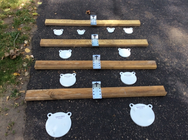

I received 10 gongs/metal plinkers today and I'm getting them ready to be set up on t-posts, I need to go and get 20 pieces of 12" long chain and bolts,nuts,washers to attach them. Slowly but surly I'll get my range set up half way decent.
