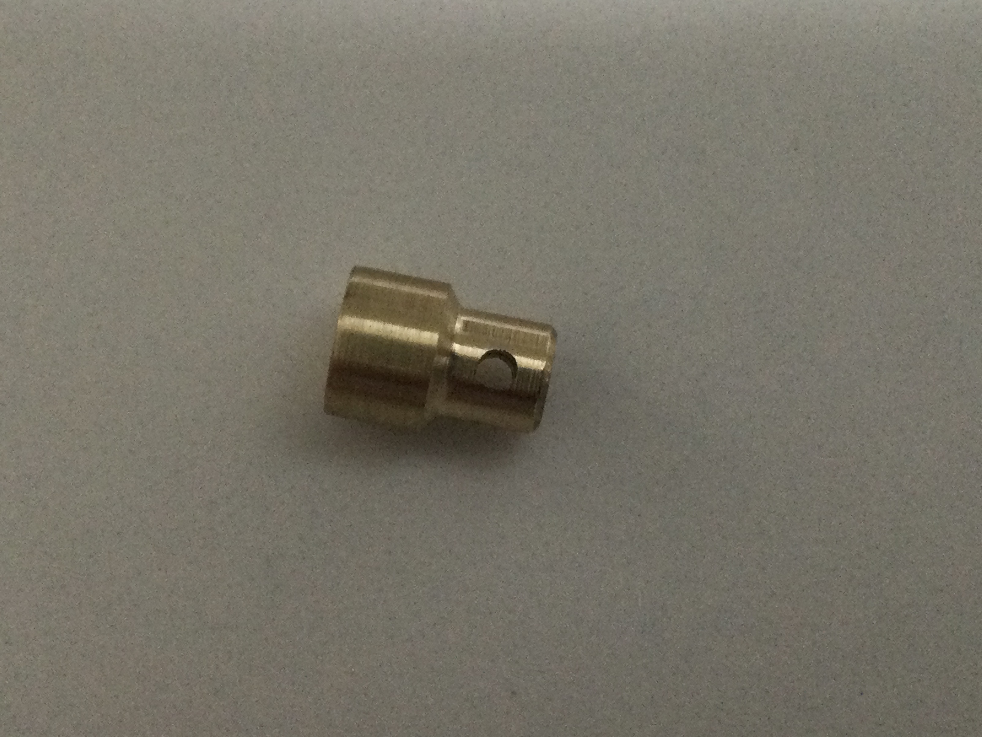

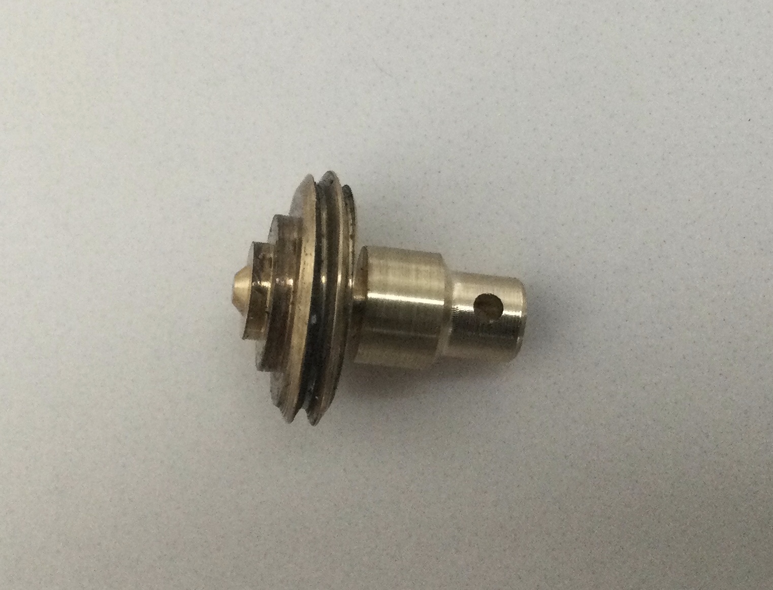

I made this simple adaptor that fits over the reg push pin to enable me to use any of my spare MFR bottle on the RAW the only other thing I did was slip an o ring over the neck of the MFR buddy bottle to allow it to seal, while this is not necessary when fitted to an mfr reg it is not detrimental either.
It works a treat
