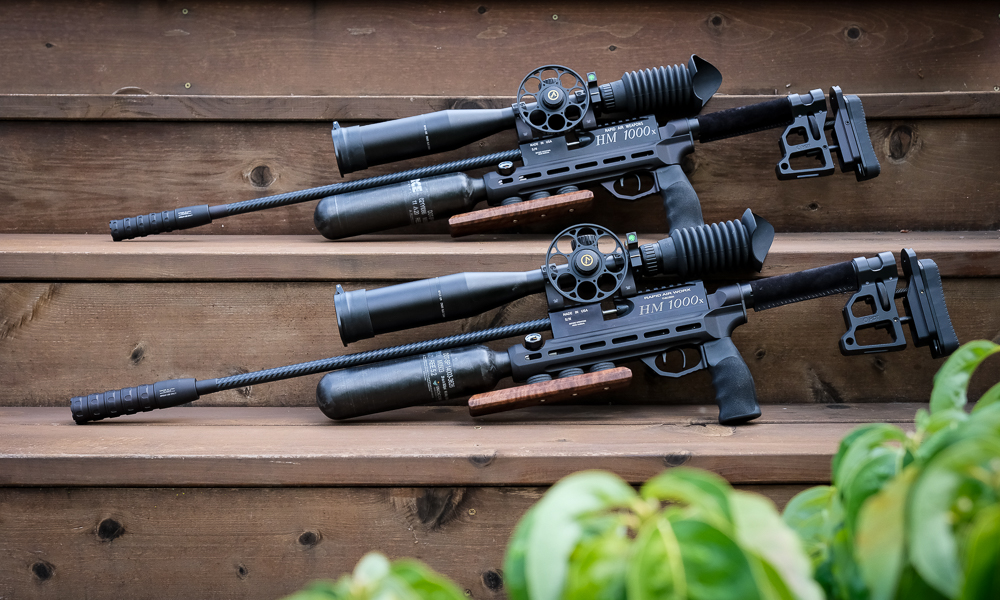

I've tried a couple different Donny FL moderators, an Impulse Air IA-1200, as well as 2 of my own design. I found the IA to be slightly better than the others I've tried. I'm also shooting the JSB Monsters at 810fps. These moderators and super well machined, they are customizable, and work great. I use them on both my RAW's.

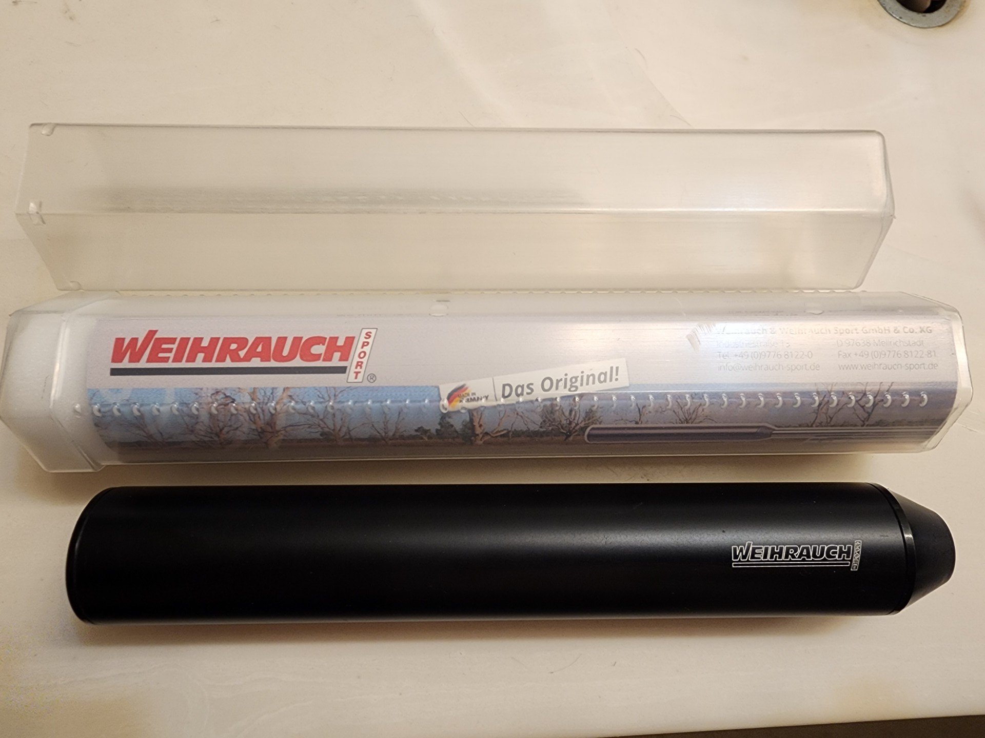

It is unlikely adding a moderator to a rifle will ever actually improve accuracy. Your best hope is to find one that does not reduce your accuracy. Air splitters however might enhance the accuracy a small bit but ultimately it is your barrel, your tune and your ability. For moderators, I tend to go up a size larger than the pellet I am shooting to help reduce the chance of clipping. 177 use 20 or 22, 22 use 25, etc,,, The best ones I have used are the round Weihrauch ones but you can no longer buy them. I have one on my RAW pistol which is very loud by the way, and it tames it down to a puff. Interesting thing on that is I am using a much larger bore on that moderator and it still makes it whisper quiet. I am using one I had reamed out for a 30 cal Wolverine I had and now using it on my 20 cal RAW pistol. It works very well.

The Weihrauch moderator shown above is very effective at reducing sound, but it does not have an air stripper positioned just ahead of the barrel muzzle. This means that unless your airgun has an active shroud with its own air stripper, powerful PCPs may have groups open when the Weihrauch mod is attached.
The IA moderator shown in the OP has baffles that act as air strippers, and so would be able to improve groups over shooting bare muzzle. Especially with an unshrouded barrel.
