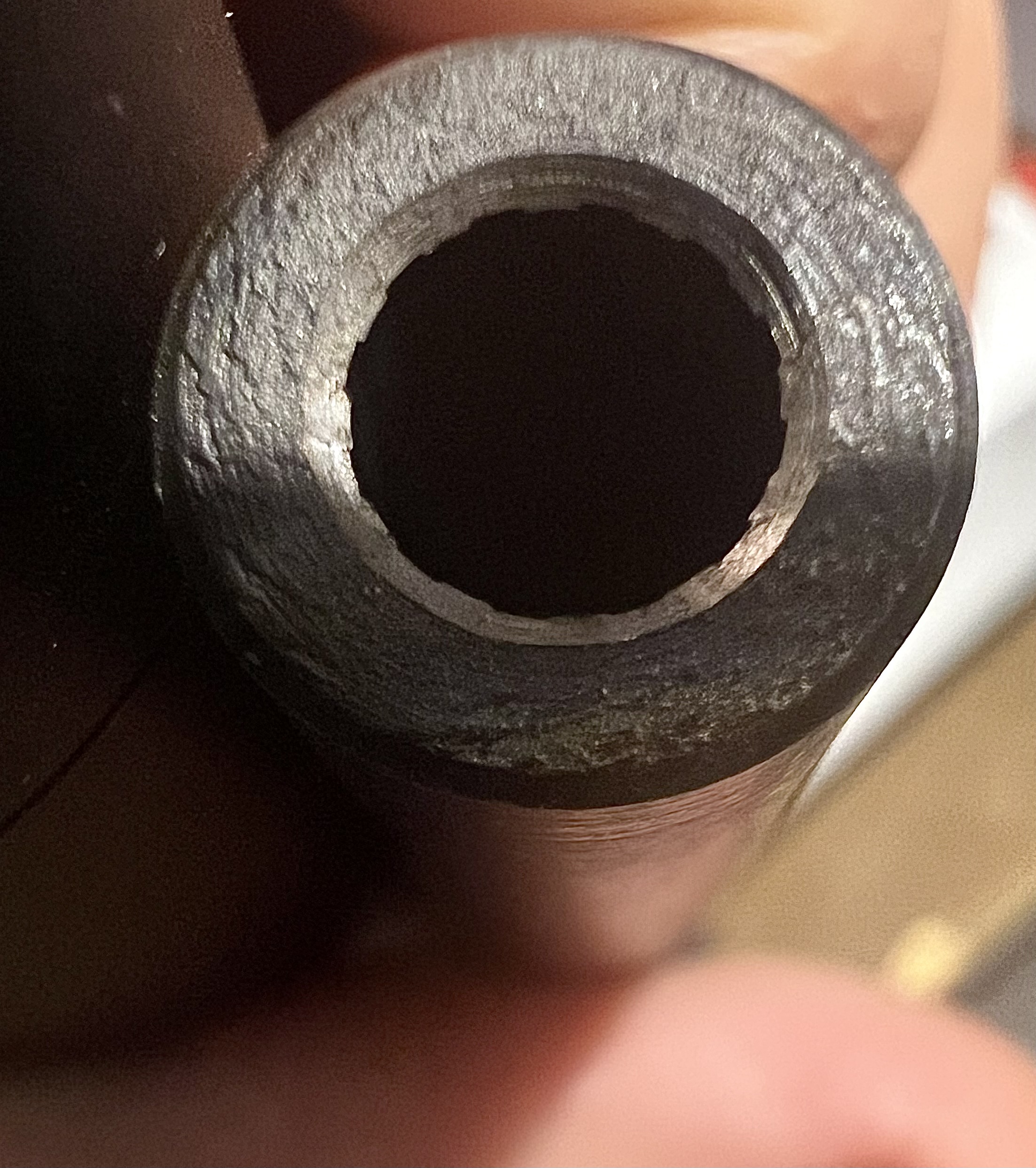

This one look ok?
I have Re-Crowned all my barrels and liners.. as I get them.... It is one of the Most Important Part of the Barrel!!!
