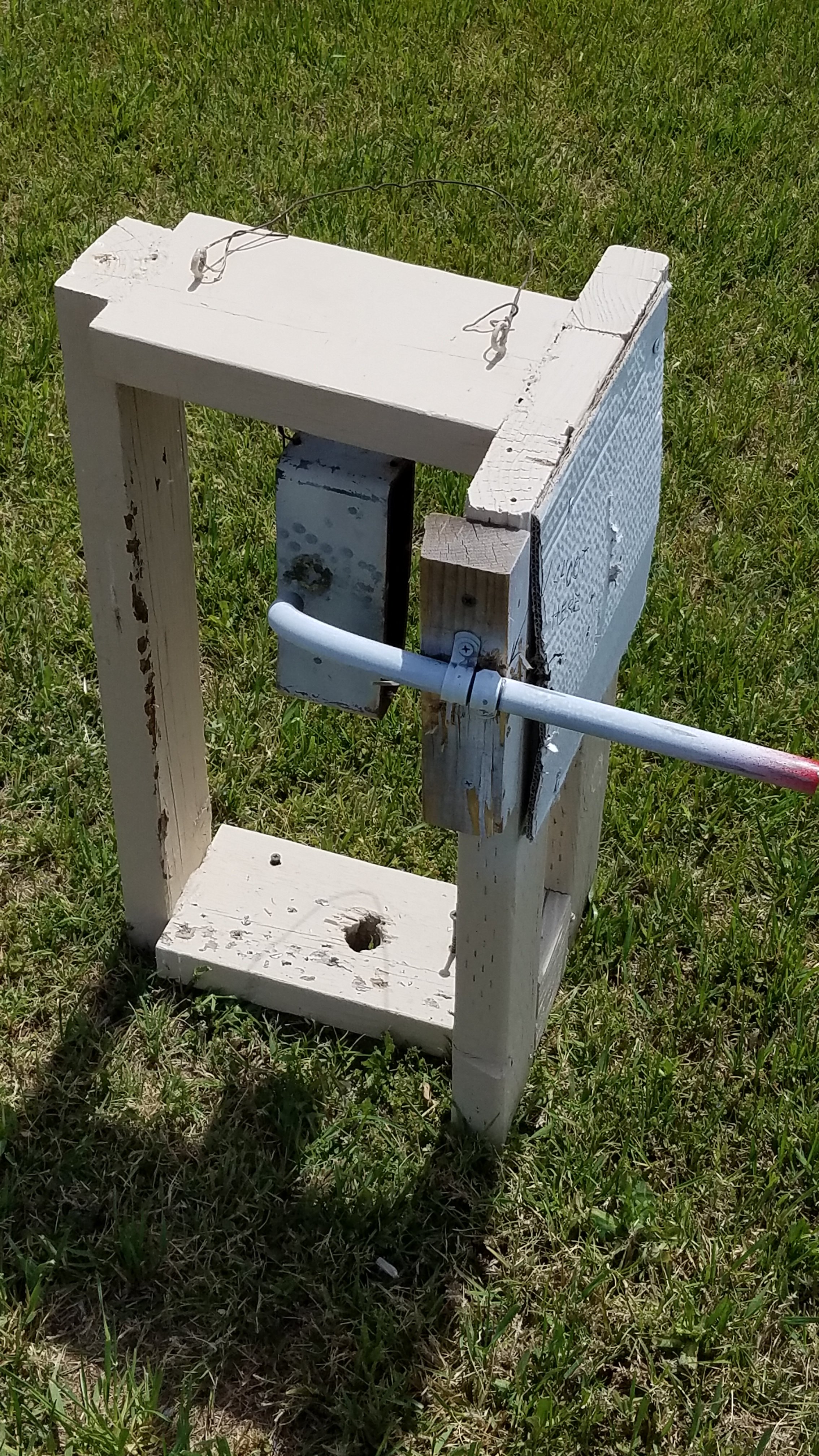

Here is the first crude one I used in one match but oddly, I can't find a pic of the one I welded together with the 2 conduits on a steel stand/faceplate.
The later version was small and all steel. I gave an option to the match winner (Lauren) for prize and she chose the bell. This one is just a repurposing of the normal look... a large and small hole bell that was covered with a piece of cardboard. This 2" x 8" rectangular steel tube rings so loud and sweet 👍
Anyway, here is the match report for that event : https://www.airgunnersofarizona.org/november-2018-match-report.html
I generally ran matches here in April and May and sometimes October or November because temperatures were more tolerable than the other available venues. If you look through the various matches, you can see lots of my target placements and a bit of view of our property/venue.
It was a fun time !!
I didn't mention before but I had lots of help from Cole and another friend - Don. Thank you very much 🙏... They jumped on the idea of interesting target placement with enthusiasm...

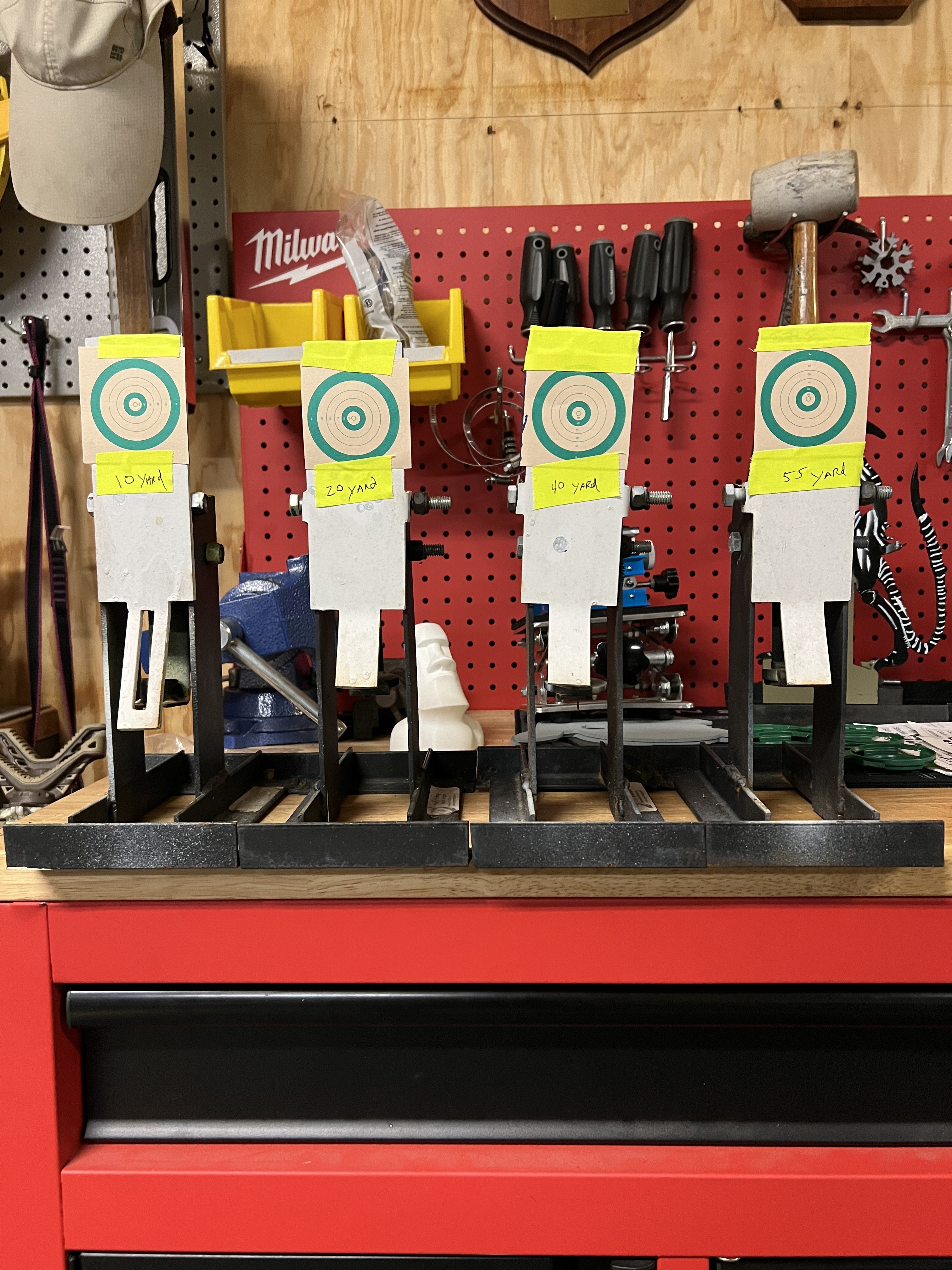

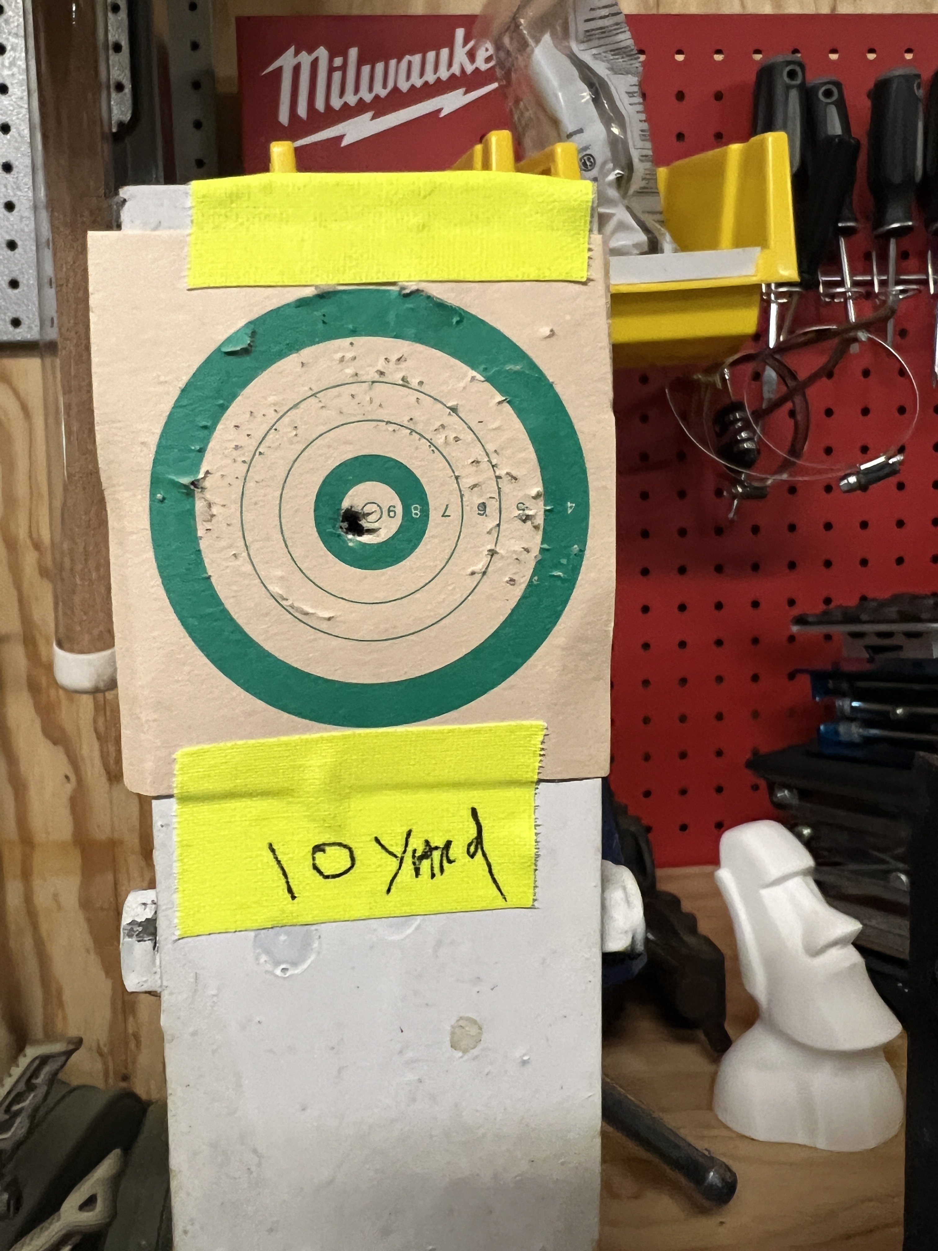

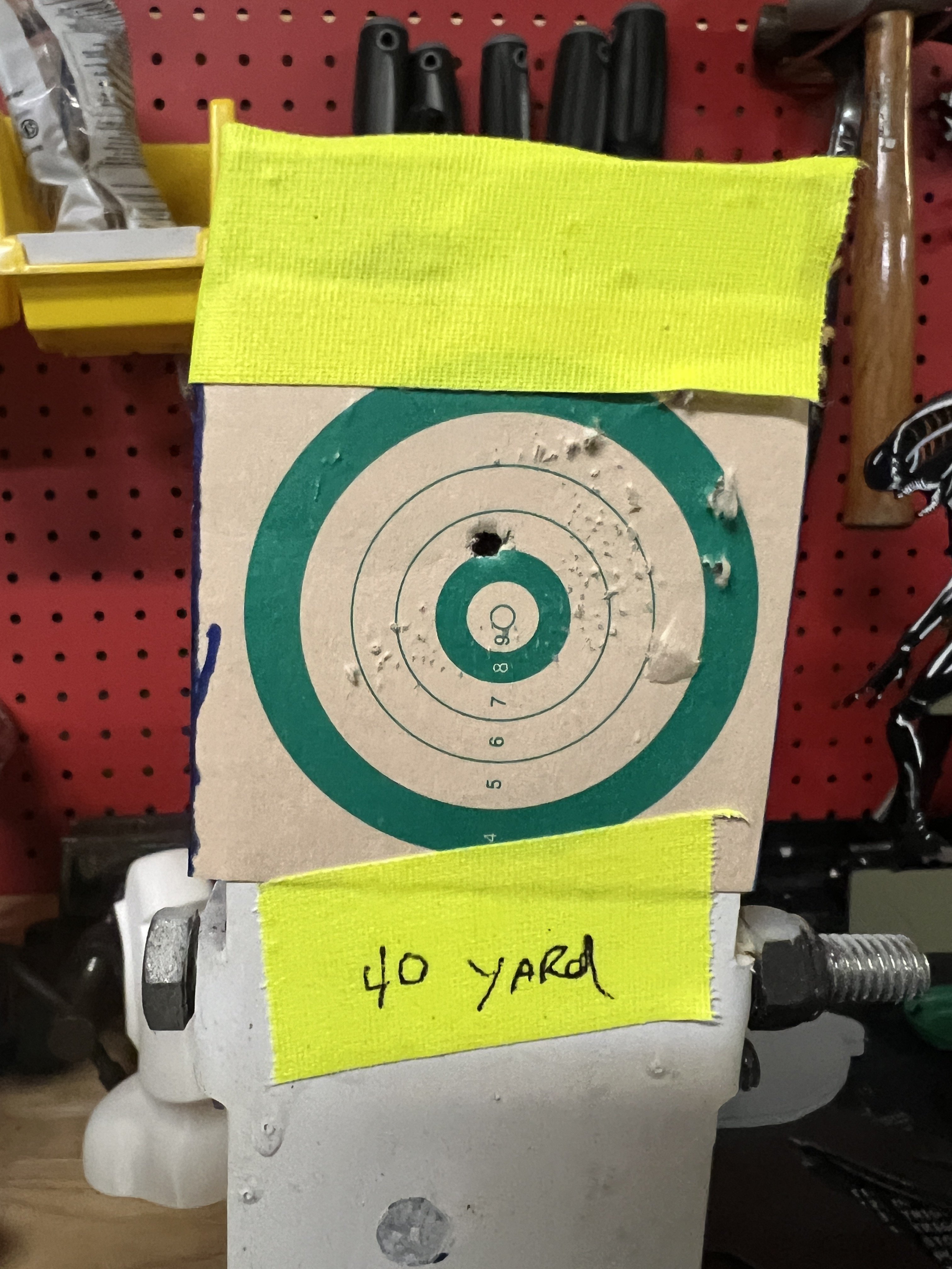

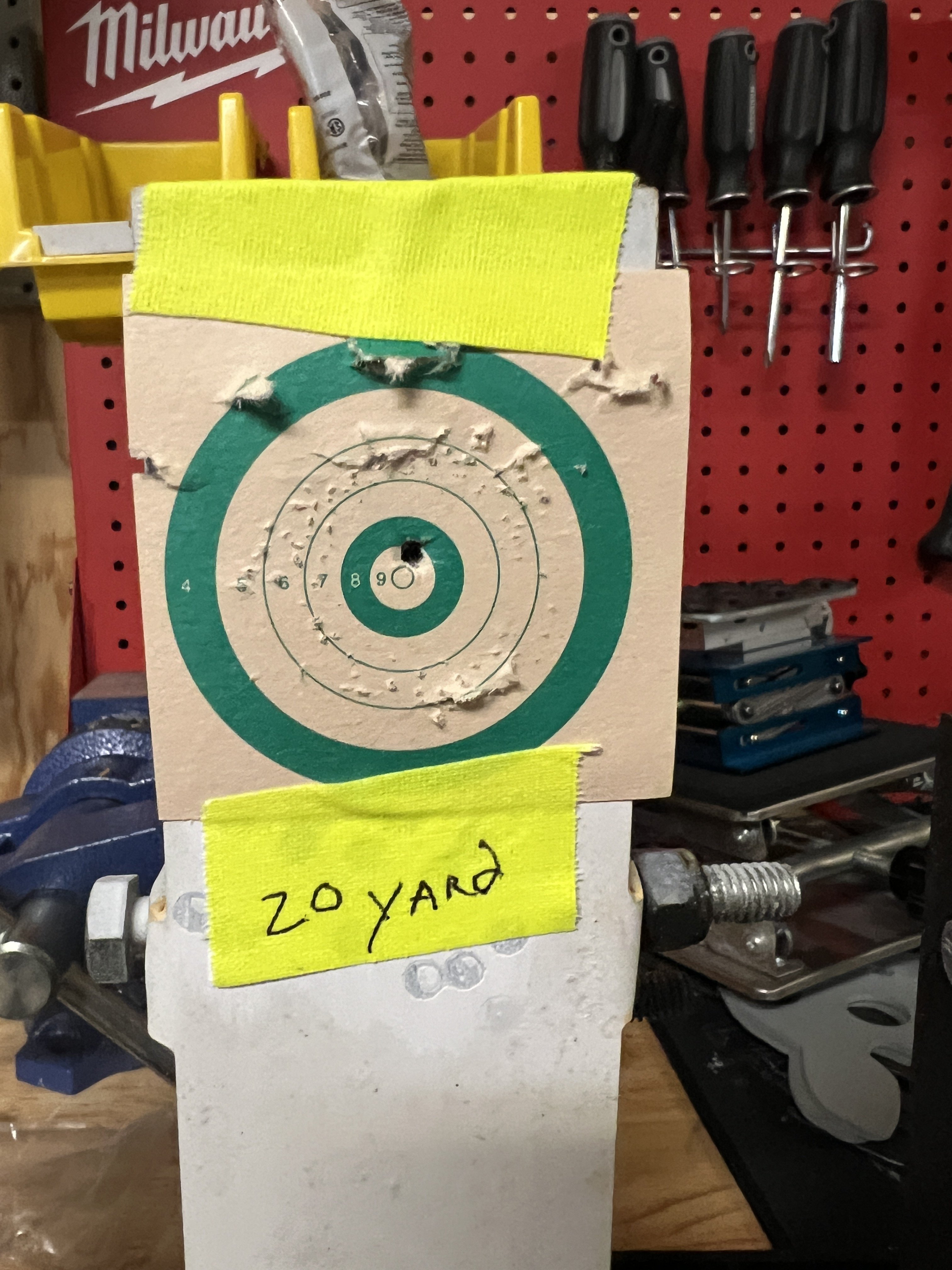

Sunday 6/2/24 I conducted a proof of concept for an idea i am working on. The basic idea is simple. Can we improve field target by improving the way it is scored while at the same time, making the scores more reflective of actual skill level rather than a hit or a miss.
Paul's targets tip back when you go through the kill zone... but in this application, not only will the target tip back, it also will provide a shooter with a much more detailed scoring method...
I used Paul Porch reactive targets for my test with 50 meter bench rest card attached with tape... mind you this is a preliminary design.
As you can see from the pictures.
The Splatter from the pellet striking the paddle on pass through is/was expected but the splatter did not deter from my ability to score the card.
The goal is not to take away anything from our traditional Field Target world but rather add a new feature to it.. for example this could be done on one of lanes... or all of the lanes. It takes 3 mins to walk out 55 yards (slowly) set your card and walk back to the box. The same 3 minutes to retrieve your card. So 6 minutes all in to set and retrieve. Considering the hassle strings can cause and the time to set up and break down this could also be a time saver...
New and Old shooters can benefit from this idea as can the overall scoring system - great tie breaker for sure!
If you study the cards afterwords you may learn something about your setup... me for example, learned that my holdover dope is off from 40 out to 55 yards - I'm shooting high and there is NO wind. Thus it has already improved my game/setup. I scored myself on my 4 shot score cards at 31.
@ThomasT - !
I'm sure we will have lots of back and forth... that's the idea... I welcome all ideas "kindly"
Adding a bell/ringer would also add interest... these are just proof of concept... not an end product as the finished product will need a simple way to slip the cards in exactly the same each time.

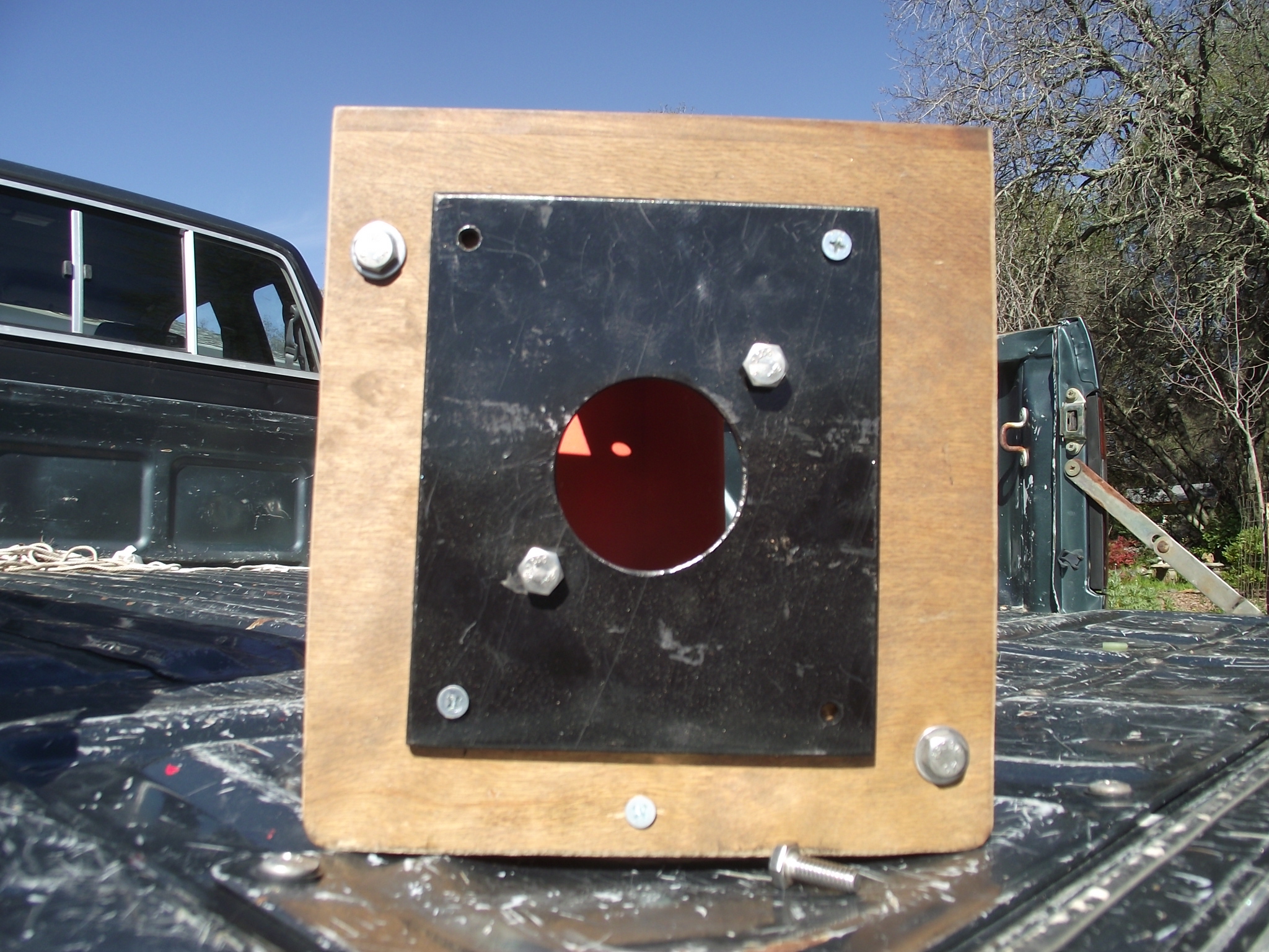

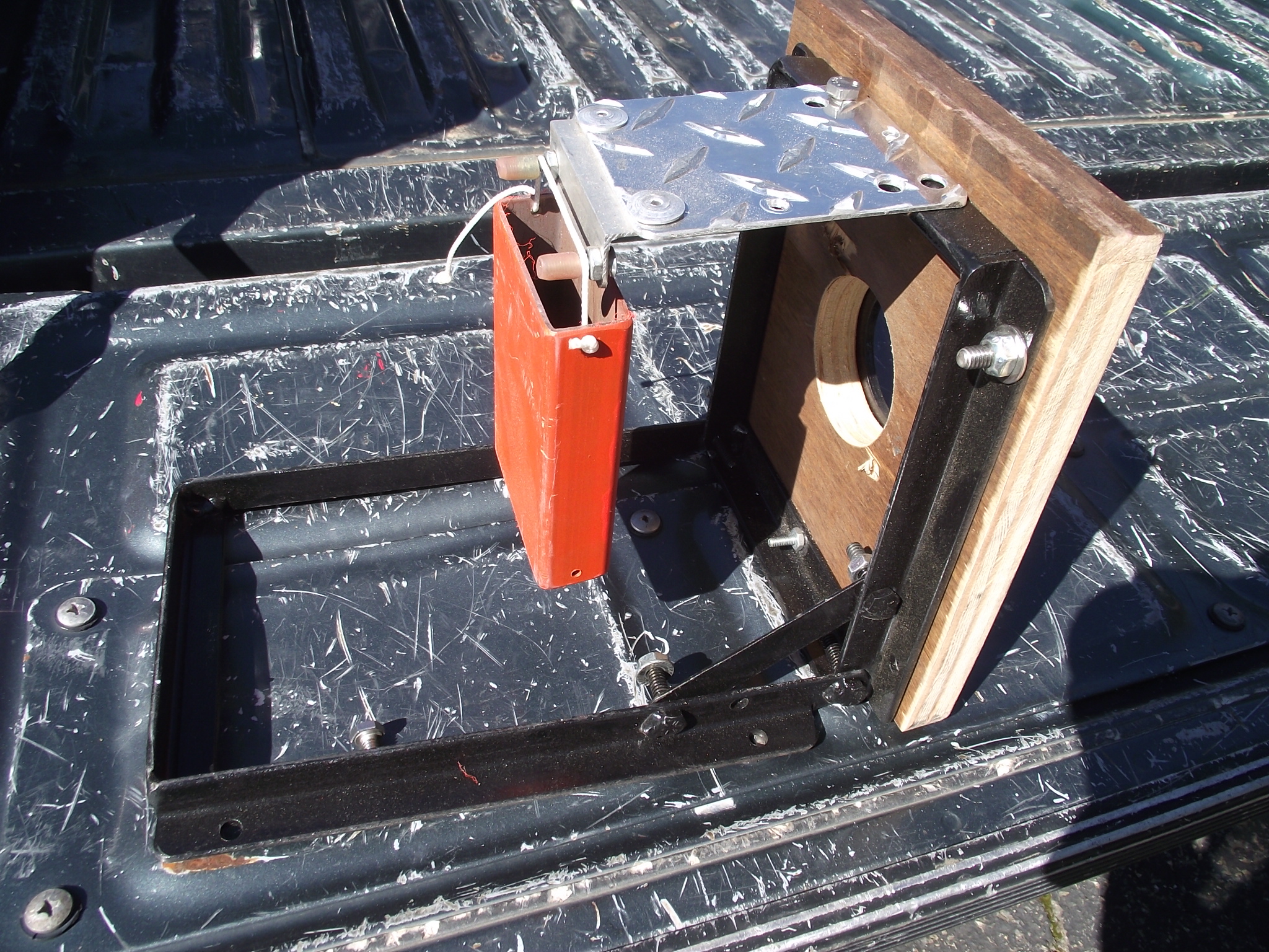

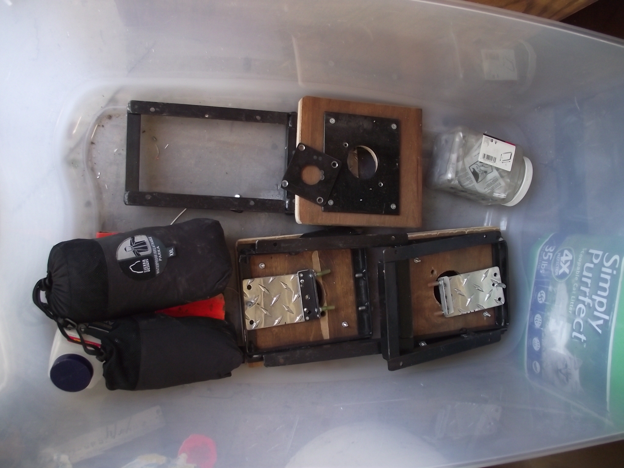

We made these up for our Clubs Off hand lane/s As such you don't need to stoop over and reset via string.
1/8" wall steel BOX tubing is the Bell having very good "DONG" sound. Can be rectangle, square or perhaps round if close to the hole ?
Face plate 3/16 steel on Wood so misses make no noise. Reducer/s screw on if needed.
These fold up, but we never do ... Held up now for 10 years !!! getting smacked by 18-28 shooters every month.
Some have used 6 -7 1/4saw blades, at they DING quite well too.
Imagination and just build it !!
Face plate 3/16 steel on Wood so misses make no noise. Reducer/s screw on needed.
i like it .... nice and beefy

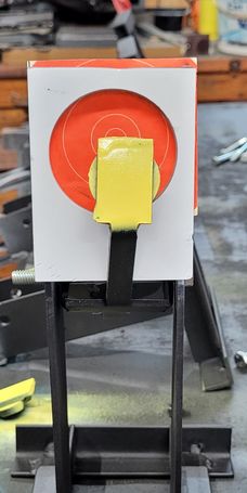

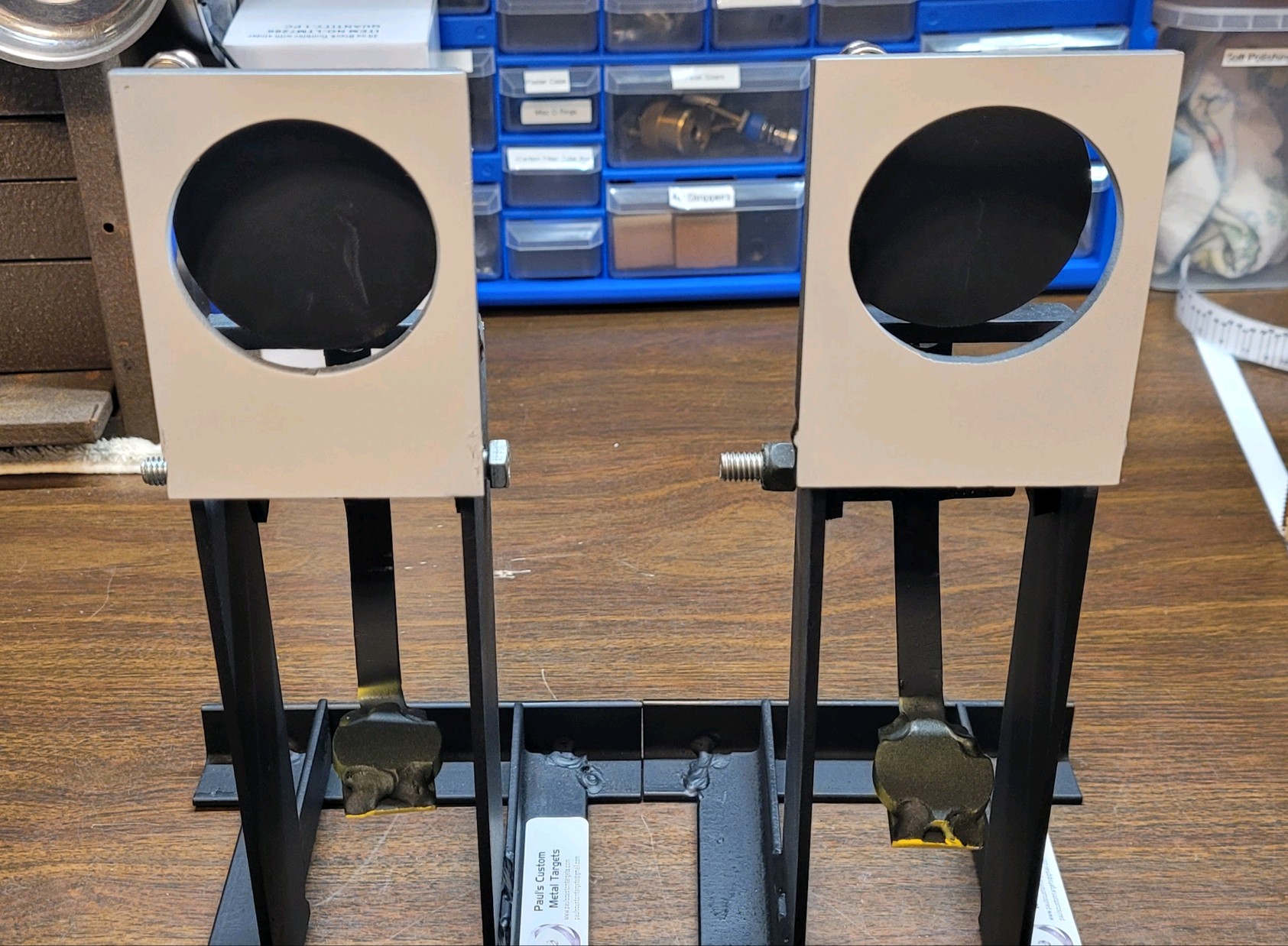

TWO Pictures of an on going prototype target Paul Porch is helping me with.
This is (Mk 1 Mod 2) which allows you to slip the 50 meter paper in from behind the plate with a stop at the bottom and slide in clips.
Great way to improve your game... and break any tie.....in a shoot off.
Maybe you knocked it over, maybe not - more importantly, how well did you hit the KZ?
This is one shot by Carey H. from aprox 12 yards with 10.3 FX at 880 ish?
Back splatter of previous version has been eliminated. When you strike the KZ a paddle flips up from underneath.

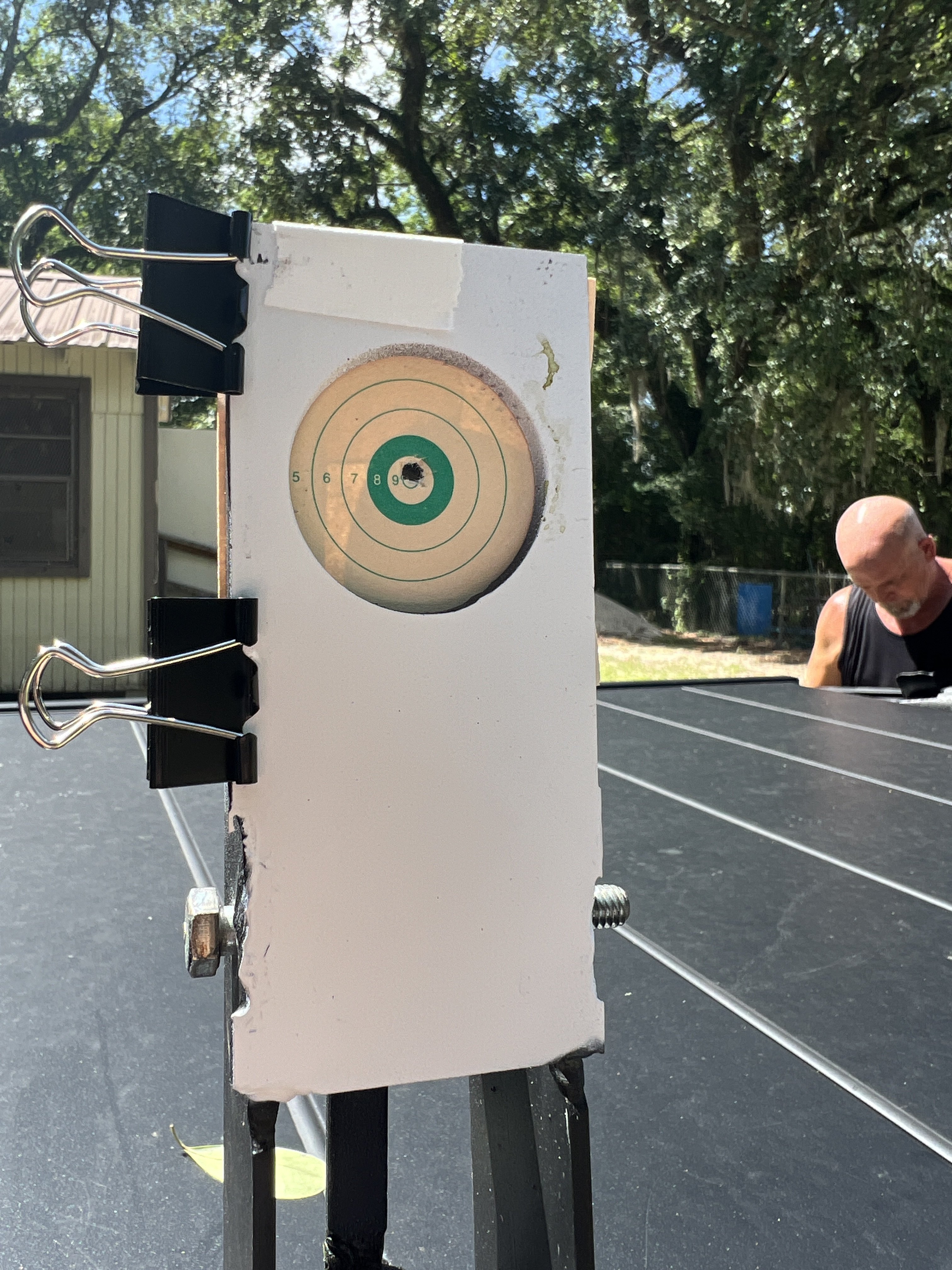

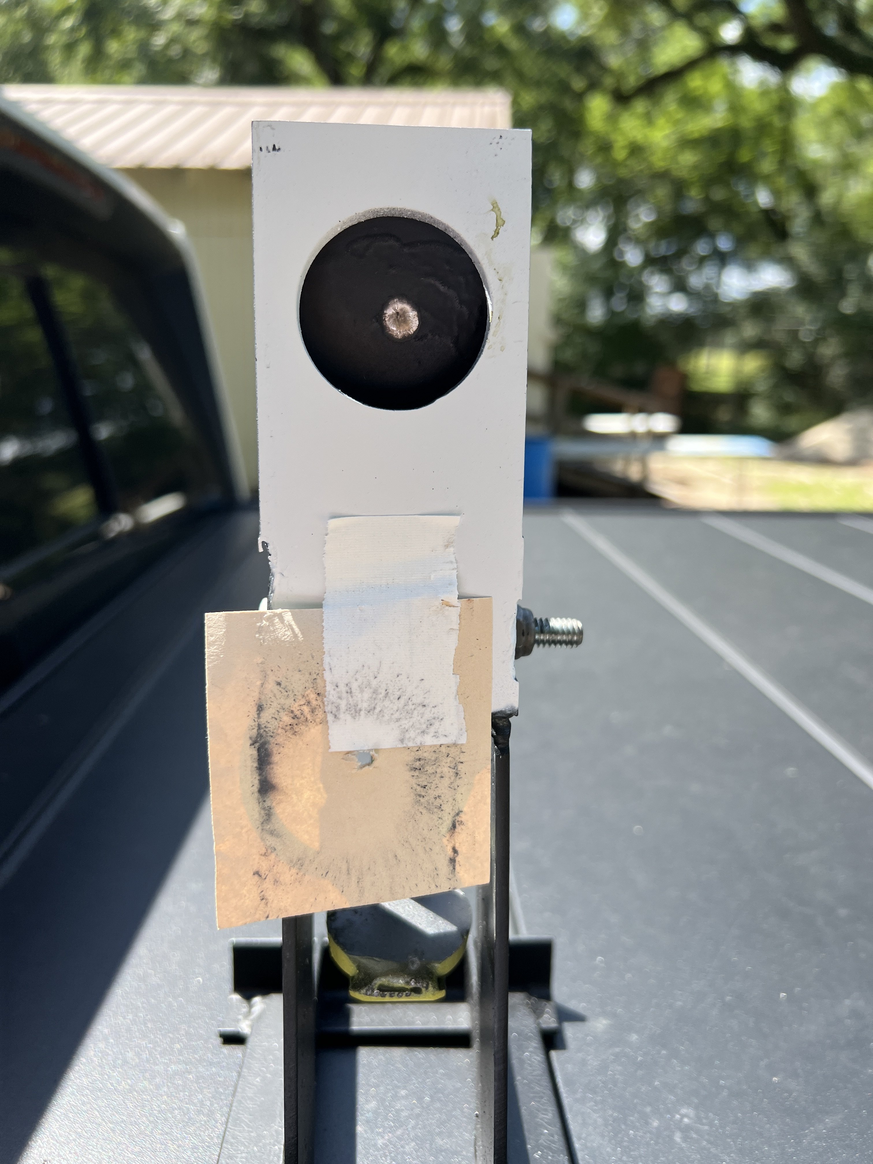

Newest Renditions of the Field Target Bench Rest Targets:
Walk your score card out to the target...
Insert your score card in behind the plate and secure with a magnet at top
walk back to the shooters box range distance and shoot
a paddle blocks the target from a second shot so you know you nailed it.
Retrieve targets and score.
