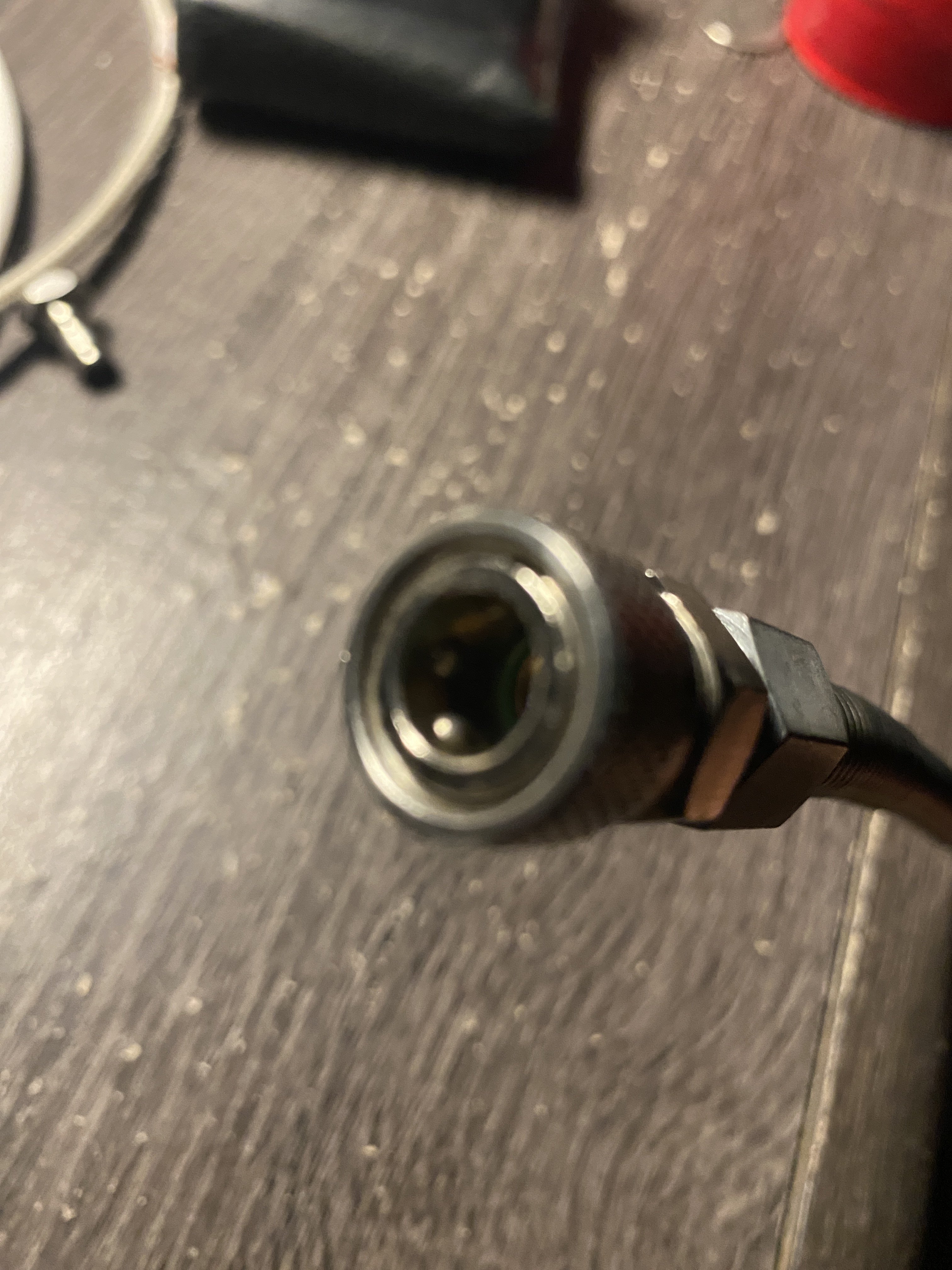

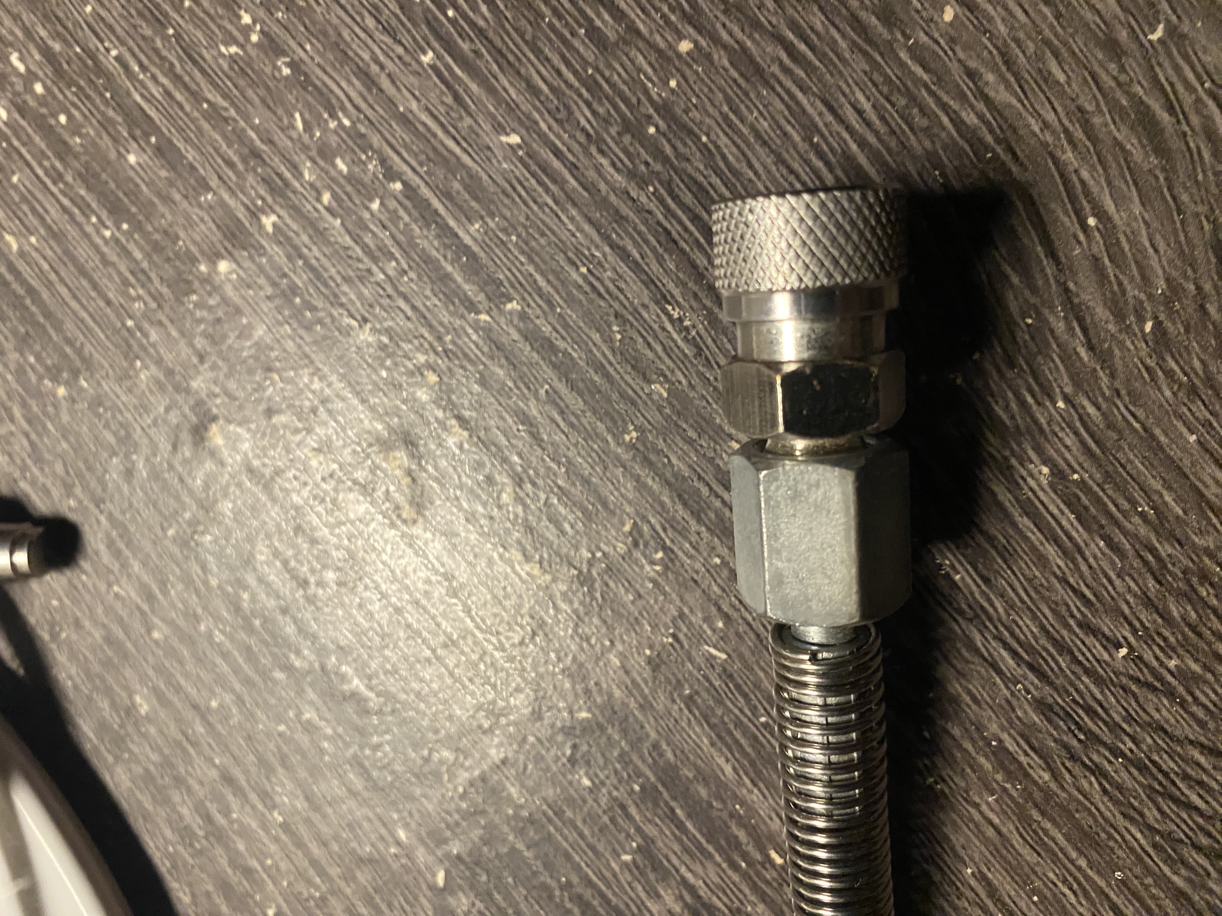

I have an LG 400 on the way. I have watched a couple videos on filling the cyl. from a scuba tank. I have an Omega tank with Foster fittings, is there an adapter that I can buy. I did a quick search and didn’t find anything. Thanks
Thanks for all the replies. I have the first and third item so I just ordered the 300 din to 1/8 BSP. $35 including airfare.The LG 400 should come with a standard Walther fill adaptor, that will look like this-
Link to adapter at Champions Choice:
Link to adapter at Best Fittings:
Walther Fill Adaptors – Best Fittings
www.bestfittings.co.uk
To connect the adaptor to tank you will need this-
300 Bar DIN Female – 1/8 BSP Male or 1/4 BSP Male – Best Fittings
and this quick disconnect fitting-
BEST Fittings Quick Coupler Plug – Best Fittings
It looks confusing, I know. But it is quite easy.
