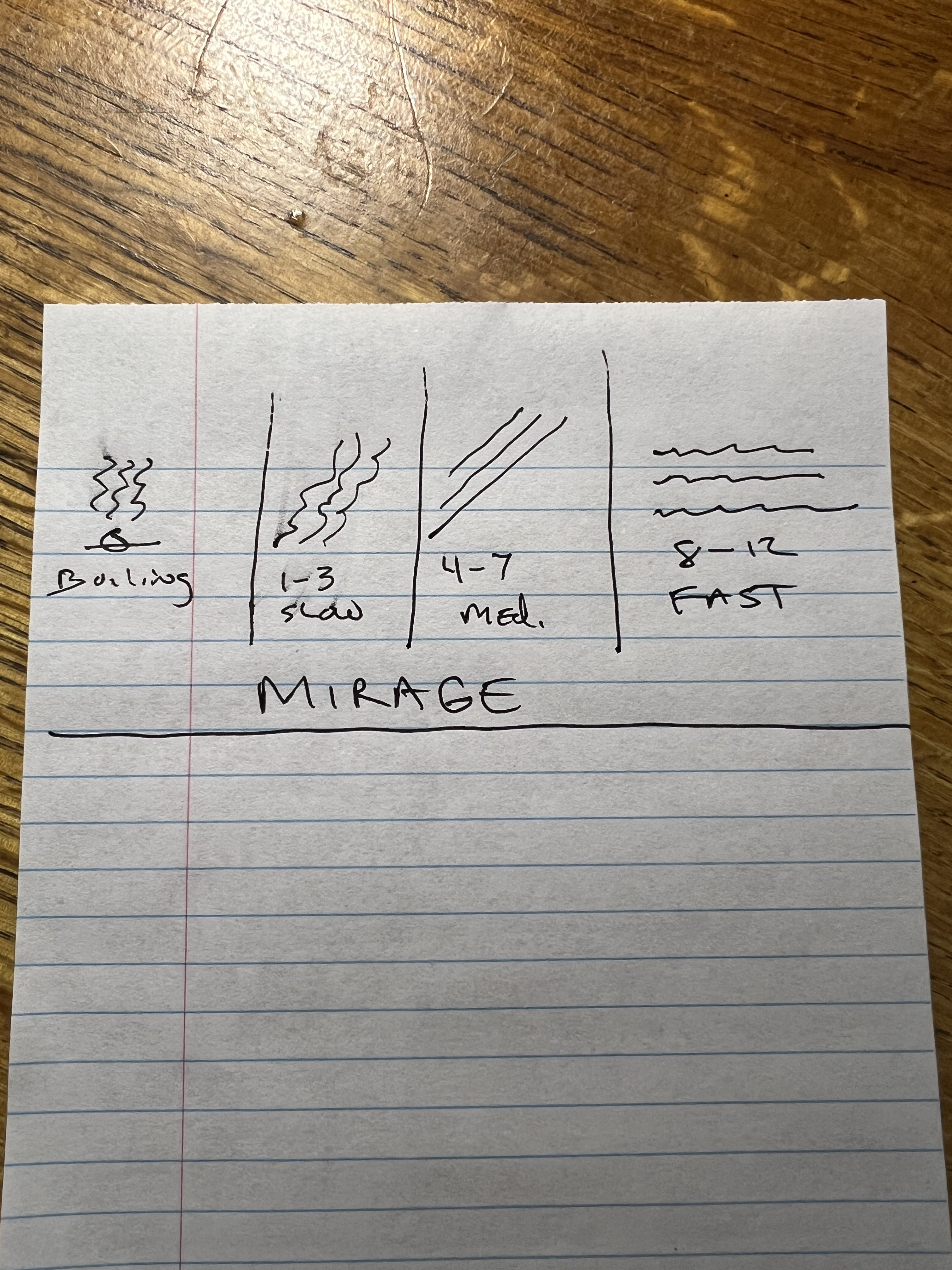

@BC - being as your a southwest kinda guy.... how does this Mirage pic look to you. Accurate?
Reactions: BC
Mirage is my next go to wind indicator if I can't use the string.
It's very important to focus your scope between you and the target when finding mirage. If you just look at the mirage behind the target...you are seeing the wind behind the target...not in front of it. Some scopes are good at seeing mirage and others are not. My Leupold is very good and I can leave the focus at 40-45y when viewing mirage and still see a 55y target well enough that I don't have to refocus and shoot.
Mike
Mike

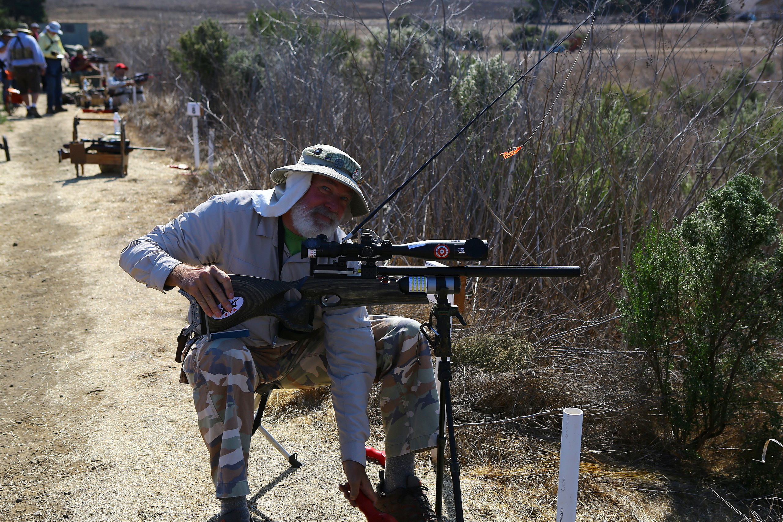

I may need a little help in Mobile Al. I have overdone things with the wind vanes, kites and strings.
A less humorous and more realistic contribution to this thread comes from @Motorhead with his super lightweight fishing pole thingamajig
I am now evaluating the type of string to "string from my do-dad" gun mounted windicator
so far dental floss with a feather works and i am told in archery land that the floss behaves better as it ages.
