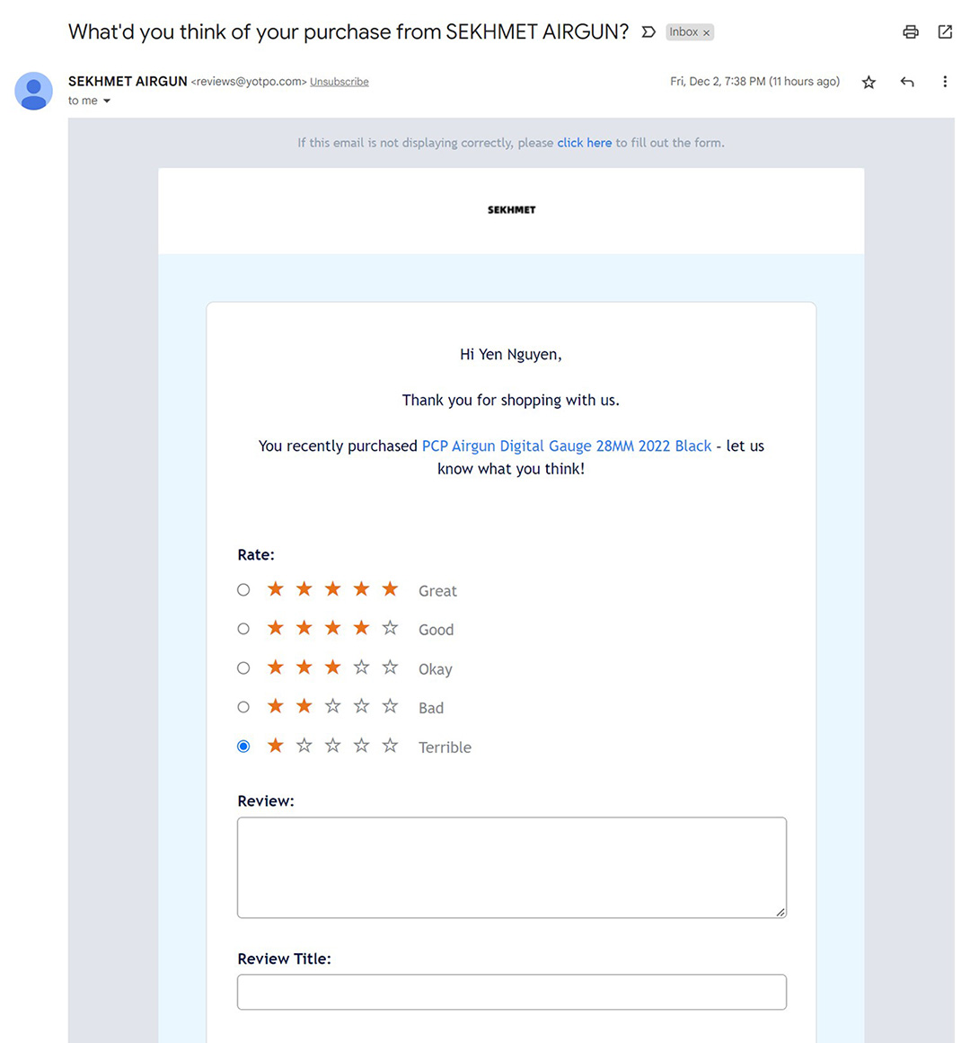

Ironically enough, look what showed up in my inbox yesterday...an automated email asking me to rate them - but do they really even care? It's too early in the morning for me to write them a scathing review so I'll chew on it for a bit while watching the US/Netherlands game...
I'm sorry but I'm LMAO here when you posted this. It's like a big FU for even asking for a rating. It's really ironic.

Yeah, isn't that awesome of them? I gave them a 1 star "terrible" rating earlier today. I doubt they'll even see it . . . or if they do, I don't think they gave a chit.

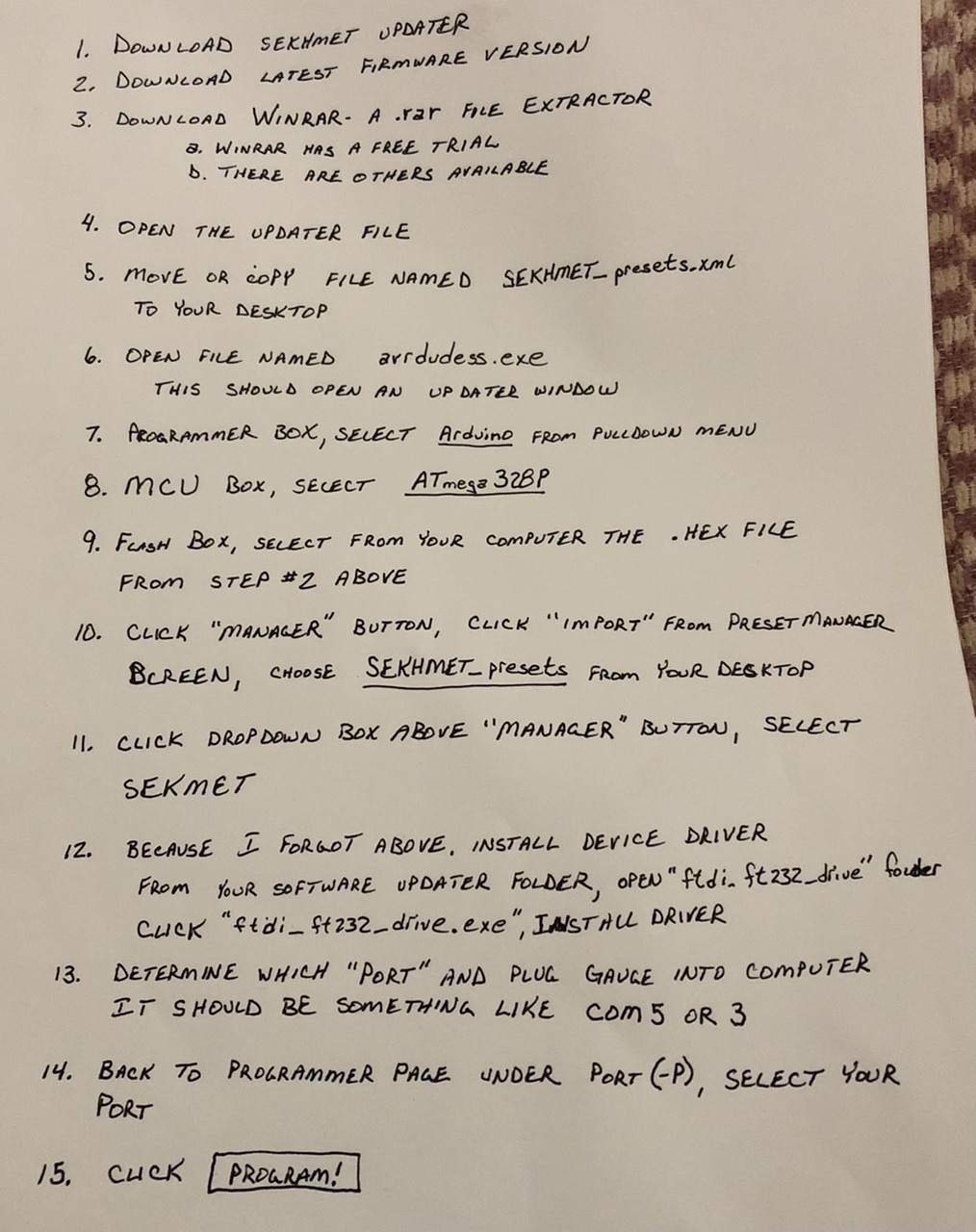

I received poor customer service as well when trying to learn how to update. I did finally figure it out but it wasn’t because of any help from him.
I will include my cheat sheet here in case anyone might want it.
