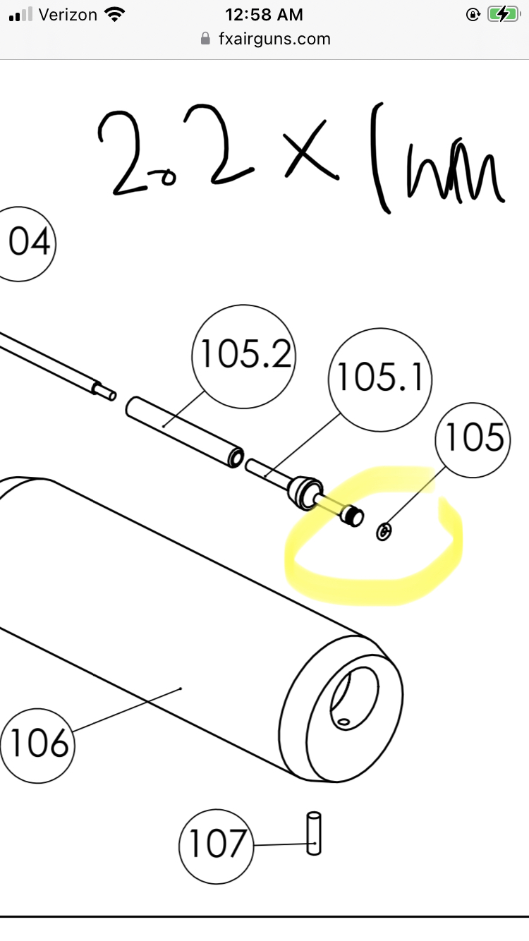

Your valve rod over traveled forward which caused the valve stem(the tiny head you see in the mag slot) to move out of its comfort zone within the power plenum, and caused the 2.2mm x 1mm DURO 70 o ring to get nicked or disintegrate. Thst needs to be replaced. Hopefully you’re saavy with tear down as you’ll have to completely tear the gun down a good 75% to get that repaired. When it first happened you probably heard a tiny pop noise.

BTW the small O-ring is only seal air from escaping the tail section, when you fire your m3.
